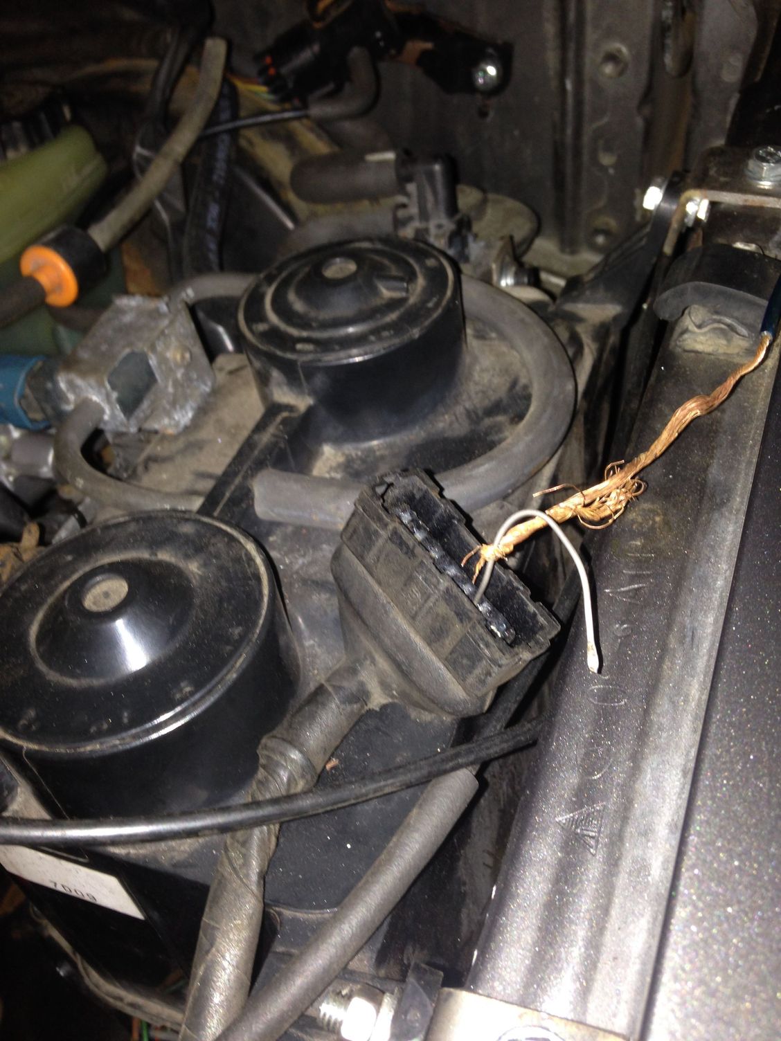

https://cimg7.ibsrv.net/gimg/www.yot...ffef40559.jpegThis is what I have hooked up to my fc wire. The fp doesn't come on until I crank it over and after its running I can unhook this wire and it shuts off.
So finally got my swap running today. Only real question I have is I had to hook up my fc wire from the ecm to ground wire to the original maf connector on the 22re. When it's connected it runs fine. Soon as I unhook the wires it shuts off. Does that sound like it's right? The recipient is a 87 truck with a 22re. I tried hooking the fc wire to the green wire at the body harness but it didn't work. Aaaand as usual I'm sure I'm forgetting to give all the right details so you can shoot me now lol. Let me know what you think.

so you are asking if you should have bare stranded wiring showing...if so, nope

Lol no that was just the wire I used for testing. I was just trying to show where I had the fc wire hooked into

Is that the 22RE VAFM (not MAF) connector? Isn't that a part of the 22RE engine harness that was removed along with the 22RE engine (it was with my 91 3.0, so I'm surprised to see it still there)?
All of your COR wiring should be done in the passenger kick-panel, either as part of the "body/dash harness" or as part of your "conversion harness" (that mates the 3.4 engine harness to the 87's body/dash harness). I jumped right to the COR because that's the circuit that I've seen FC and FP relating to.

Yes that's the original 22re connector. I left it there so I didn't cut into the harness not knowing what else was in there. I tried hooking the fc to the green wire out of the cor in the kick panel and the motor ran for a second. This is the only way I've found to make it run for longer than 2 seconds.

So I looked into that connector and I have my test wire from the fc hooked into the green wire on it. Now when I have my fc wire hooked into the thicker green wire on the body plug in the kick panel it shuts the motor off after a sec or two. Should I be looking for a another green wire in the kick panel? There is only one green wire in the plugs or can I splice into the green wire right at the cor?
