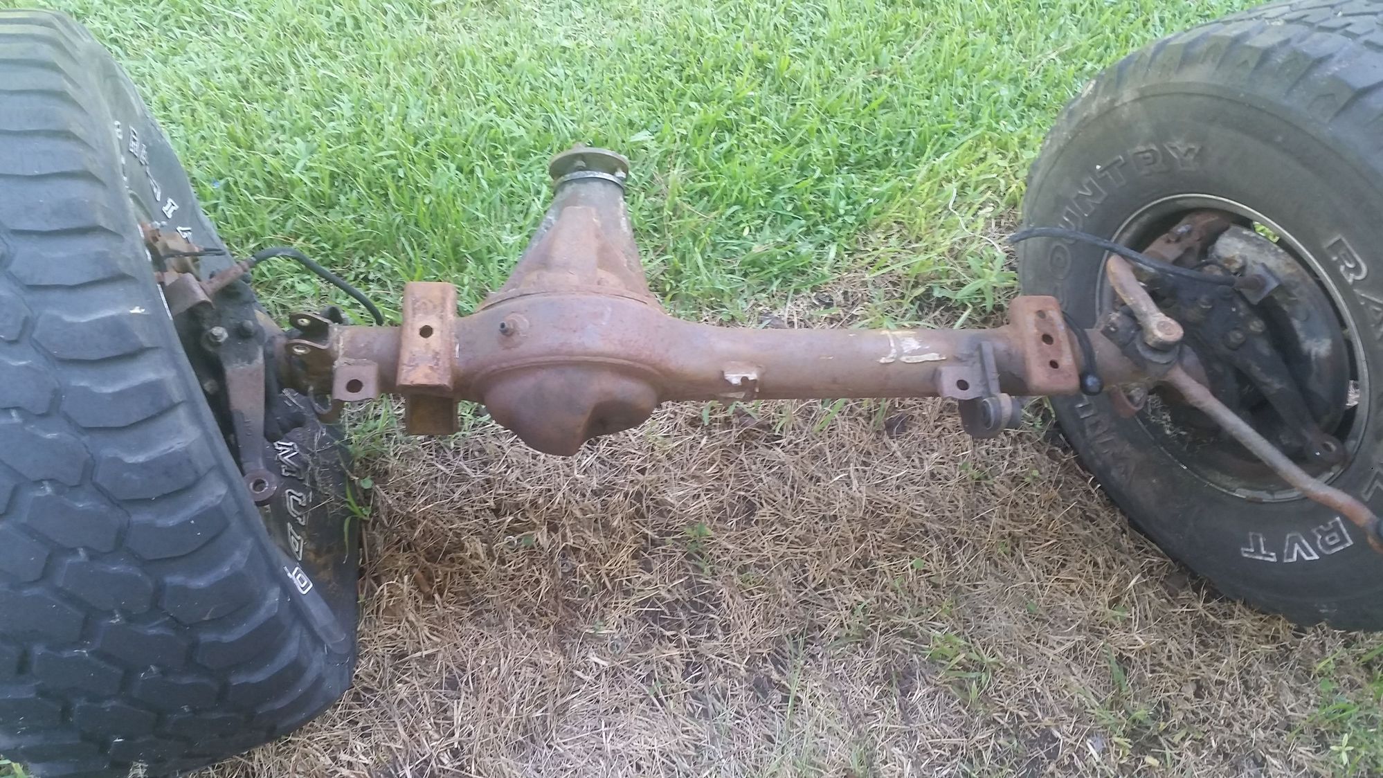

Back to the Future May 9, 2016 08:38 AM
Well, made it home. Wife keeps asking what do I plan on doing with that "rusty old part" in the back of my truck...lol. I told her I'm going to rebuild my axle (rusty old part) then install it on my truck. I think no matter which way I explain it she won't understand. She keeps telling me I should just buy a new truck...psssht, ain't gonna happen. I told her I plan on buying a welder so I can do the job and she's said "You don't even know how to weld." It cracks me up. I love her to death.
osv May 13, 2016 07:52 PM
a good place to start might be with cleaning that axle up and checking it to see if it's bent.
Back to the Future May 14, 2016 10:16 AM
For sure! It looks terrible but that isn't going to deter me! That will be the first order of business once we get moved next month.

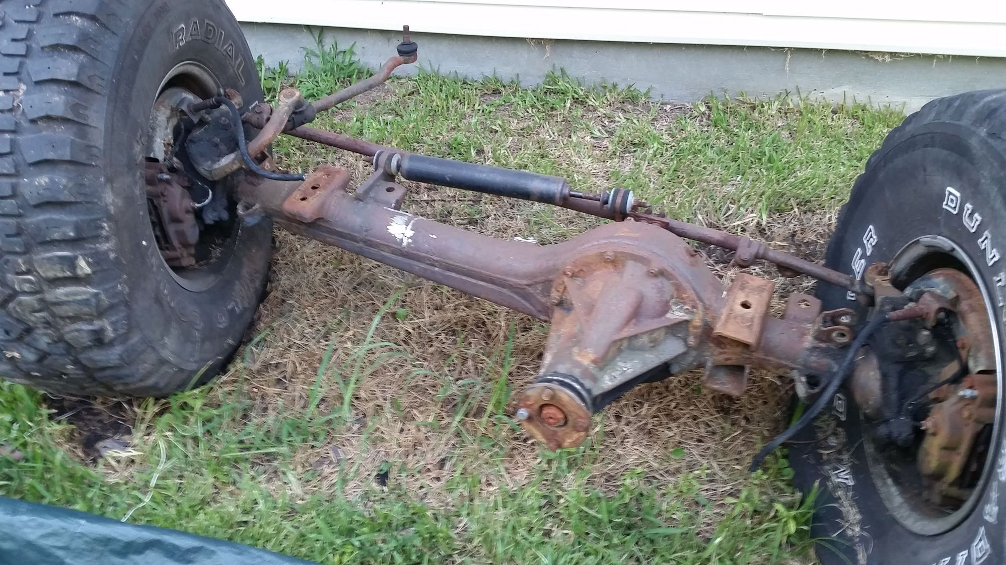

Back to the Future Aug 14, 2016 03:32 PM
Got some really minor work done on the axle. If you notice I managed to cut off the old leaf spring and grind a little of the old brackets down. Like I said not much but the first real update in months. Been collecting tools and trying to get finished with the move. Been at the new place for almost two full months now and we are still not done moving in. It has been house project after house project...but progress is progress. Got to get some PB blaster so I can finish up the disassembly. And crack the sucker open and get to the real fun stuff.

Back to the Future Aug 20, 2016 02:48 PM
Got the steering and stabilizer off. Progress...slow...steady...progress.
https://cimg0.ibsrv.net/gimg/www.yot...1446e72b2e.jpg

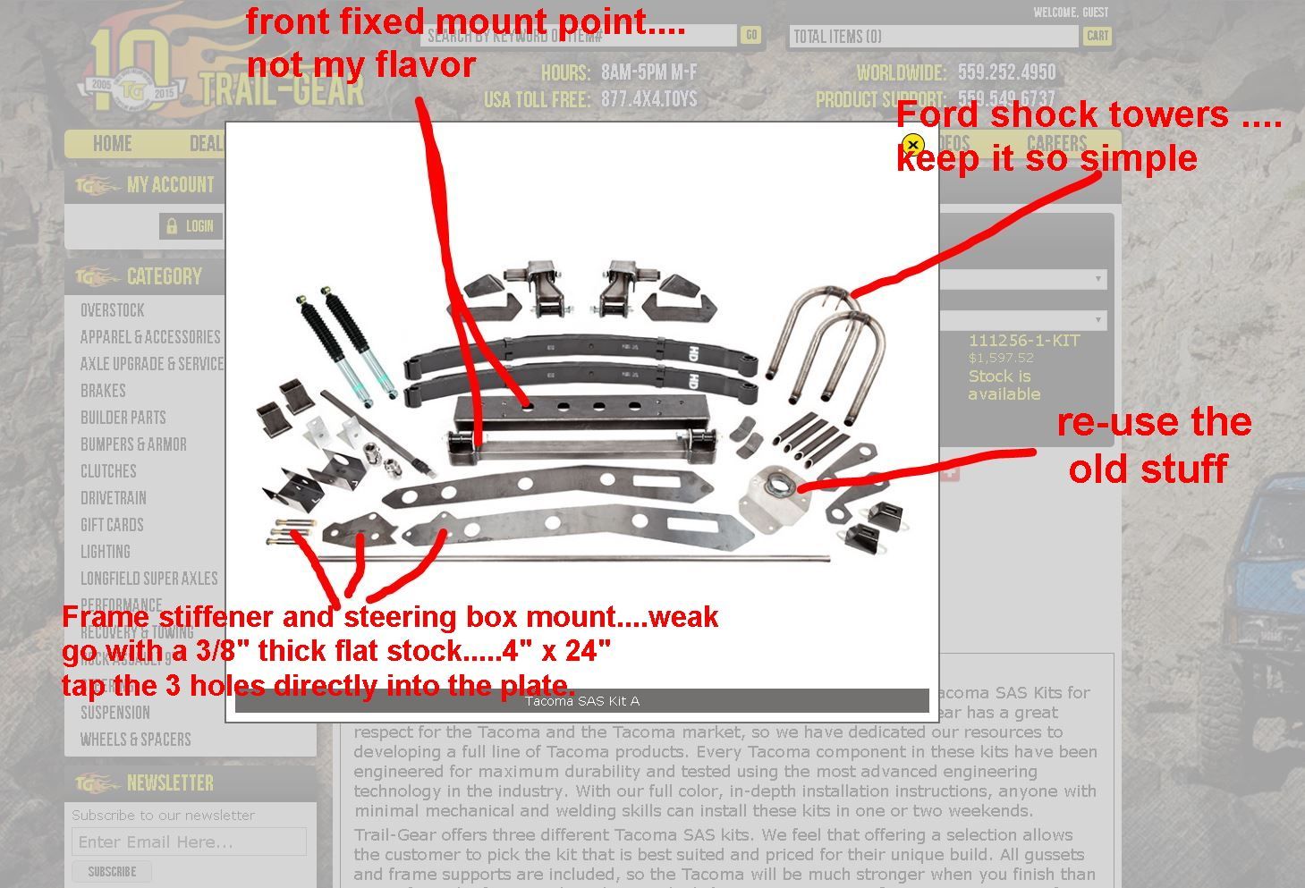

ZUK Aug 27, 2016 08:33 AM
Hi Back to the future,
Gonna follow your build thread....a truck you've had for 17 years and now getting around to SAS.....I imagine the IFS stuff was getting worn out and I bet it was either put money into making the IFS work correctly or just SAS it. That was part of the thought process for my 01 Taco SAS build.
rustED has a thoughtful suggestion there....to only tack the axle housing in place til you're 100% sure everything clears perfect. There is a great temptation to weld it up thinking if it's not quite perfect that you can somehow "work around it" and that ends up sucking in the end. Many of the SAS build you might notice are sold within a year after they are completed. I think it's because they realized they fubar'd it up and didn't set things just right. Even I have prematurely welded things on 100% to later discover that this or that needs to be moved 1" to make it work perfect.....and that meant a lot of weld grinding to break it free. I am excellent at weld grinding....and it's a damn good thing, too.
May I recommend leaving the factory axle perches alone and use a piece of 3/8" thick flat stock 2.5"wide x 9" long with a hole in the middle to use as a custom shim of sorts? Then weld it once it's angled properly.
You should still break the knuckle welds loose and re-angle the pumpkin to point straight at the transfer-case output. That means the flatstock will get welded on with about an 8 degree angle.
-4" lift kit front and rear (haven't decided on which company yet)....................... NICE
-35" BFG KM2's or KO2's.................. EXCELLENT SIZE......ko2 rule.
-15x8 crawler steelies.......................... Good width...10" is too wide these days.
-4:88 gears front and rear.........good choice(use Nitro Gear or G2 Gear)
-Aussie Locker for the rear.........Good....nice cheap locker....would be my choice if I was on a budget...other choice would be Spartan Locker.
-Open diff front (for now) That's what I said on my build......finally putting in a SELECTABLE locker in a couple weeks...Harrop elocker
-Winch bumper for front................hmmmm
-TG rear tube bumper.....sure why not
-12,000lb winch (don't know which company).....hmmmm.....Harborfreight is a "low cost" possibility......
Looking above at some of your build criteria I like it....commented after it....
ZUK Aug 27, 2016 09:09 AM

Back to the Future Aug 27, 2016 09:38 AM
rustED has a thoughtful suggestion there....to only tack the axle housing in place til you're 100% sure everything clears perfect. There is a great temptation to weld it up thinking if it's not quite perfect that you can somehow "work around it" and that ends up sucking in the end. Many of the SAS build you might notice are sold shortly after they are completed. I think it's because they realized the fubared it up and didn't set things just right. Even I have prematurely welded things on 100% to later discover that this or that needs to be moved 1" to make it work.....and that meant alot of weld grinding to break it free. I am excellent at weld grinding....and it's a damn good thing too.
May I recommend leaving the factory perches alone and use a piece of 3/8" thick flat stock 2.5"wide x 9" long with a hole in the middle to use a a custom shim of sorts? Then weld it once it's angled properly.
You should still break the knuckle welds loose and re-angle the pumpkin to point straight at the transfercase output.
Zuk, first may I say that I am humbled to know you are following my build and second I sincerely appreciate the recommendations. You are indeed correct regarding my IFS. It is dead. I actually think the shocks are the OEM factory ones. I haven't changed them since I bought the truck back in 99'. As you probably read up above I was originally just going to install a bracket lift and now I'm so glad I didn't as that would've ended up costing more money in the long run maintaining the IFS.
As a matter of fact your thread and several other articles have really pushed me in the KO2 direction since I wouldn't initially be doing any super serious technical wheeling and durability/tread life is a requirement.
I definitely agree that a selectable front locker is the way to go but that will only become an option as the funds become available.
For now I think I will just rebuild the axle with the Marlin rebuild kit and as I progress I will figure out the rest.
The welding piece is what I'm missing right now. I don't have a welder and I would like to at least learn the basics before I tackle this job or spend a lot on a quality machine.
