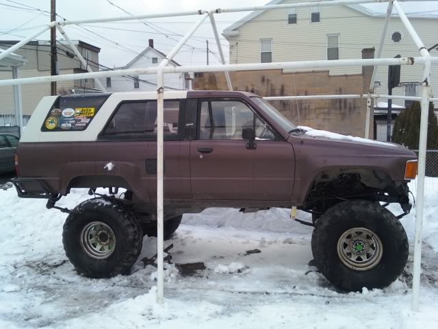

4banginRunner Dec 23, 2011 05:13 PM
1 Attachment(s)
FWIW Heres my junk with a TG 4" SAS on 36" Iroks
Attachment 190696
I'm now running RUF (about 2" lower than TG "four inch" springs) and can RUN 39.5s with the pinch weld and firewall beat
superswamper003 Dec 26, 2011 02:35 PM
wow that runner sits really high. i like it
