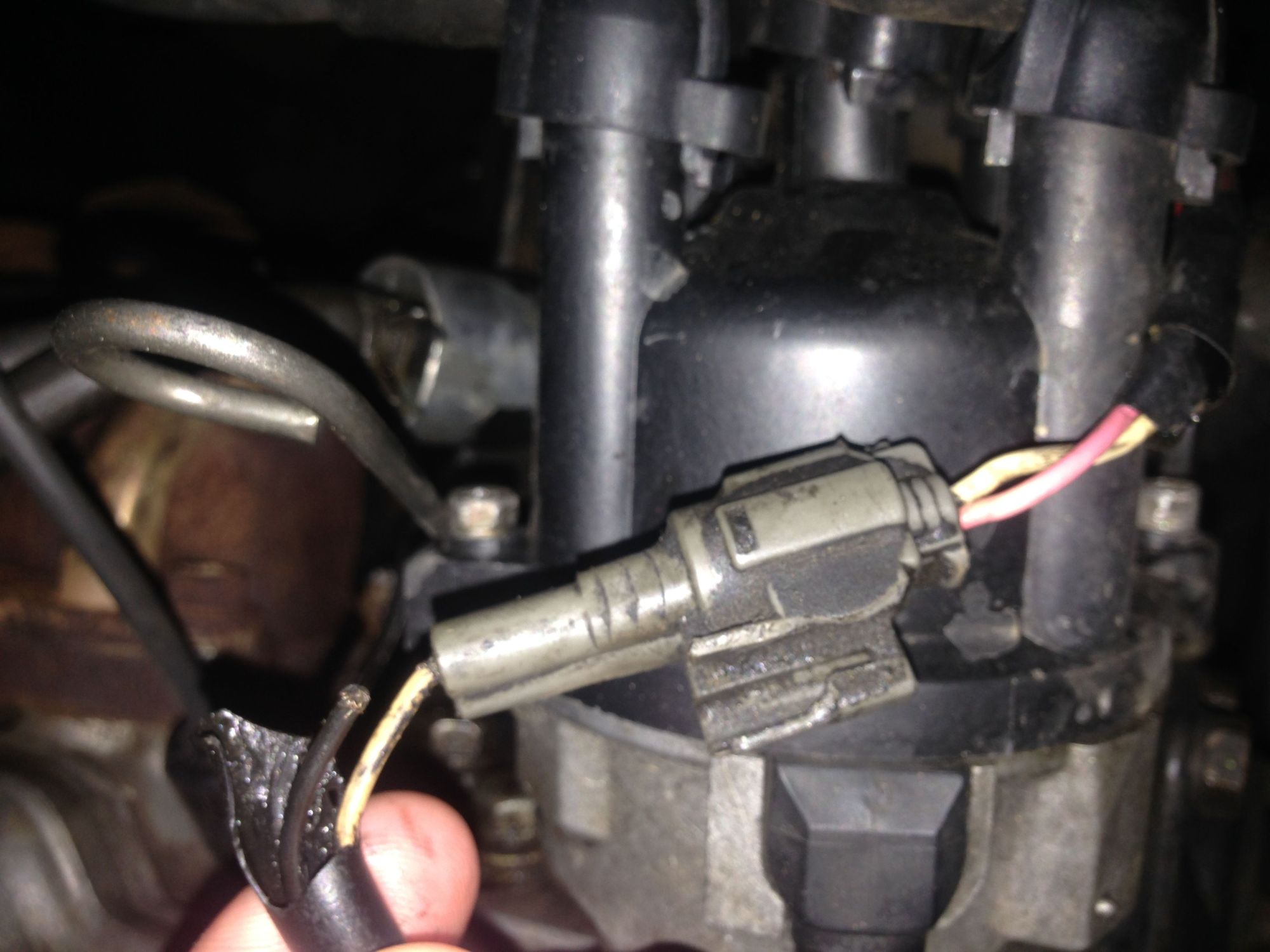

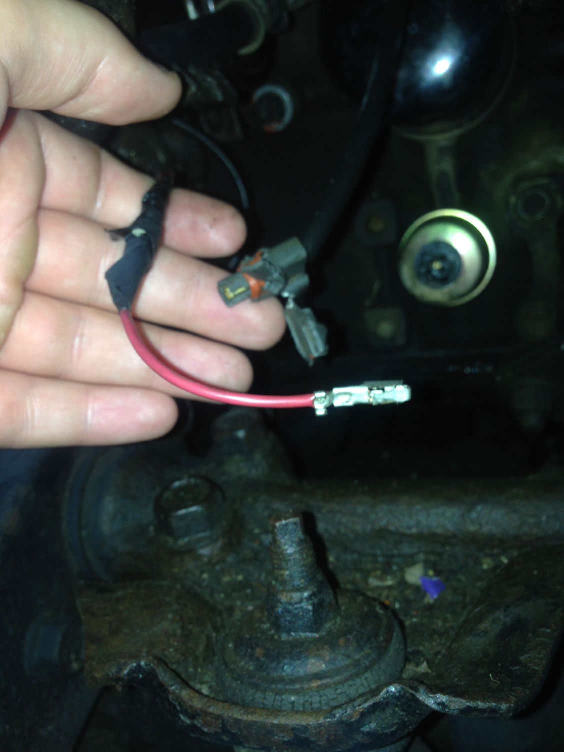

the problem is fuel related I'm guessing I changed the fuel pump but that didn't solve it I still had to jump FP and +B for the pump to Work im going to buy new relays for the starter and efi same relays 4 prong and it also keeps blowing 15A efi fuses?!?? Can't get it to run I did buy the new relays and tried them out to see if it would work still had to have the fuel pump jumped for it to run but I took them back considering no success and financial need of the money what could it be I've checked the o2 and made sure it wasn't touching exhaust brand new fuel pump and wires works just if jumped so I'm sourcing it to be in the box under the hood or something a shirt somewhere and there's one wire on the distributor that not connected to the plug in on the distributors side should I worry about that? And that's about all I don't want to put it back into the shop please help

On the distributor wire, I can't think of any wire on it that is not very important. Can you describe it or better yet, post a picture of it?

mudboggerbilly93 Aug 27, 2016 06:00 PM
https://cimg0.ibsrv.net/gimg/www.yot...ddad7615b.jpeg
https://cimg1.ibsrv.net/gimg/www.yot...46f8d4fc6.jpeg

Charchee Aug 27, 2016 08:07 PM
You need to fix that wire. I believe that's going to be part of the distributor coil pickup circuit. Yours is a little different than my 3VZE but those wires are an important part of the ignition circuit. I can't say for sure but that could be the source of your blown fuses. Put that thing back together. If the plug is broken, just butt connect them and see if that changes anything. It should. I don't ever move ahead with my testing until I have repaired any broken wires or loose connections that I encounter along the way.
