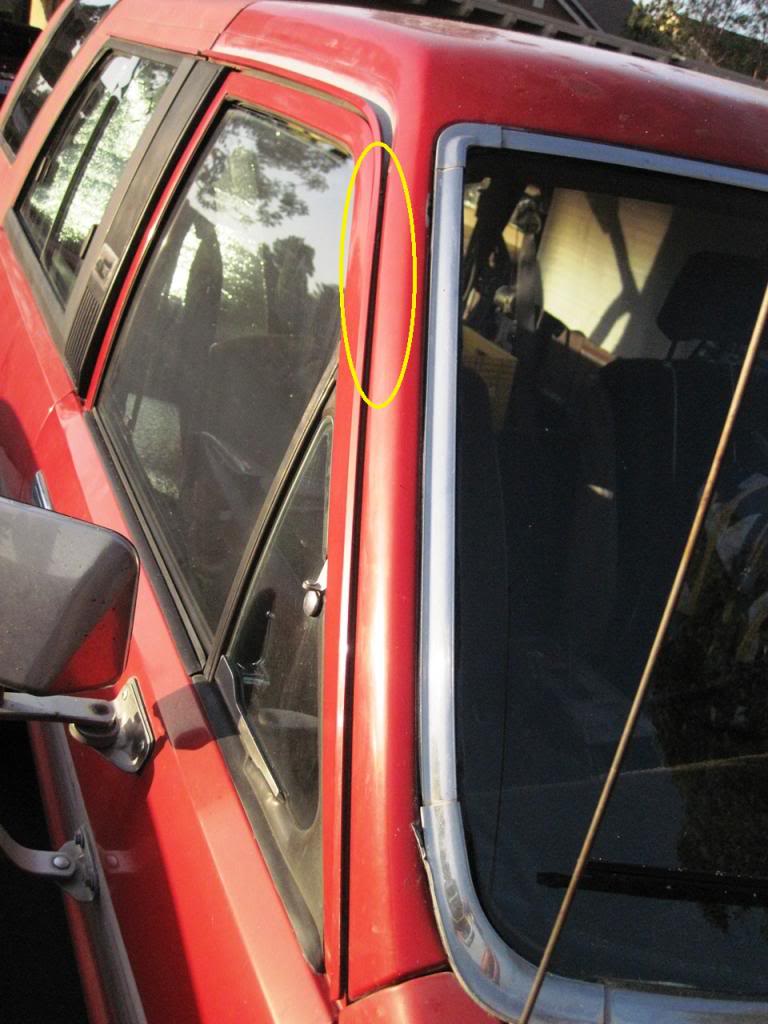

I need to touch-up paint on my front top, including rain gutters
Attachment 113895
The rain gutter is merely spot welded to the A-pillar, Then body filler WAS used to seal the seam and then it was painted.
Inside the narrow, vertical portion of rain gutter looks like dried/cracking body filler or caulking.
Attachment 113896
This causes rust in the gap between A-pillar and gutter.

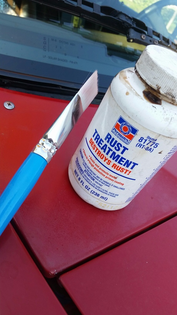

I already started on the right side because that's where I usually load my kayak which drips saltwater.
So far...
1) Removed the cracked and crumbling body filler, making minimal rust is left,
2) Coated it with Permatex Rust converter-primer (because I haven't bought POR-15 yet - altho the Permatex had proven rust resistant even without paint on it.)
3) Painted over the Permatex primer. (used thin and wide watercolor brush to get in there, both on paint and primer)
Attachment 113897
Attachment 113898
