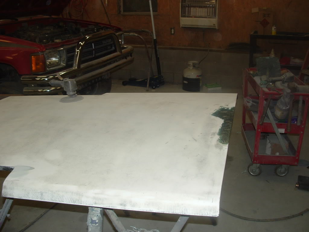

So i decided to fill it with foam ( sprayable insulation) all the way around to fill the gap. BAD IDEA!!!! I ground it down even all the way around and put a layer of bondo on. Once again BAD IDEA!!! Once all said and done the foam along with vibration made the bondo start cracking. I recommend filling it with glass and grinding it down even then a layer of bondo to finish it.. I have painted cars and done bodywork for 25 years, you would think I'd know better than to cheat like that but since it is mine and I was pressed for time I thought "what the heck" lets cheat and see....lol

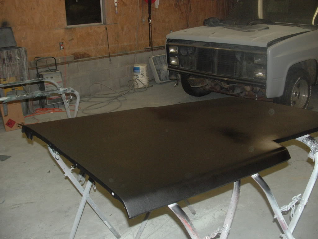

Did a lil repair on the front where it was damaged from the origional 4runner, You should have seen that one. Yup in the back ground is my next project, 88 3.0, doing a manual tranny swap. I have a top for it as well
Attachment 197603
After I got all the repairs and the edges finish sanded smooth with 180 grit I spayed it with black rubber undercoat. You can also use rocker guard or even bedliner spray. It comes from the factory with a little texture, plus the uncercoating or something with texture hides all the repairs with no priming and finish sanding. Then some spray paint if you so desire. I went over it with a satin black for a even finish.

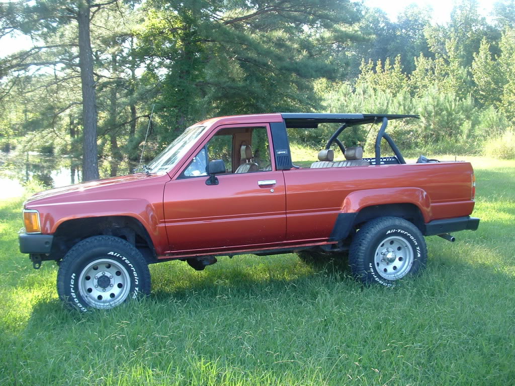

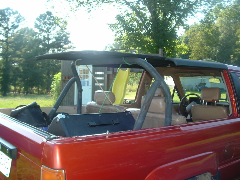

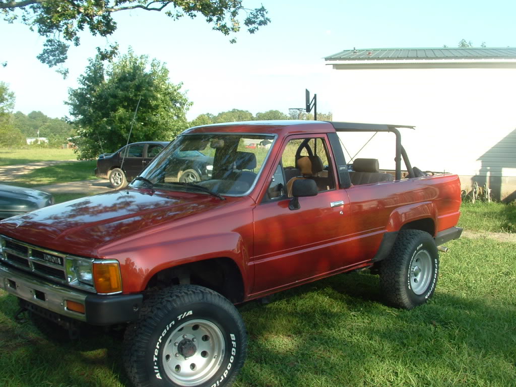

Here it is finished.
Attachment 197605
Attachment 197606
I plan on cutting the back off even with the bar, just got in a hurry and forgot it. Oh well maybe i can fix it when I fix the cracking bondo...lol

I like it, and its a hell of a lot cheaper than the tops I've been looking at. I think if i do it I'm going to find some 2" bar clamps to hold it on in the back, not a huge fan of the bungee cord thing but hey it works!
Shawn6string Oct 26, 2009 08:43 PM
Yea I'm looking for a better idea to tie it down on the back

I was thinkin if you drill a hole through the top and the roll bar you could get some counter sink bolts to make it flush to the top and run down through the roll bar and use a nut on the bottom side of the roll bar to hold it down maybe even a butterfly nut for quick release if you want to pull it completely off for them really nice days.

Yup I was thinking the same thing. I have been weighing several options. I was also thinking maybe some sort of block or 2 by 4 to level it on the back . It sits a lil lower than the roof in the back...

Find out how much you need to space it and go to your local nut and bolt store and get some motorcycle wheel spacers or something like them that way it will fit in the small area needed and you won't have a 2x4 running across the roll bar looking all funky.
If you can't find them let me know the size you need I have a few sitting around doing nothing with and if I have a set that will work for you I will send them to you.
