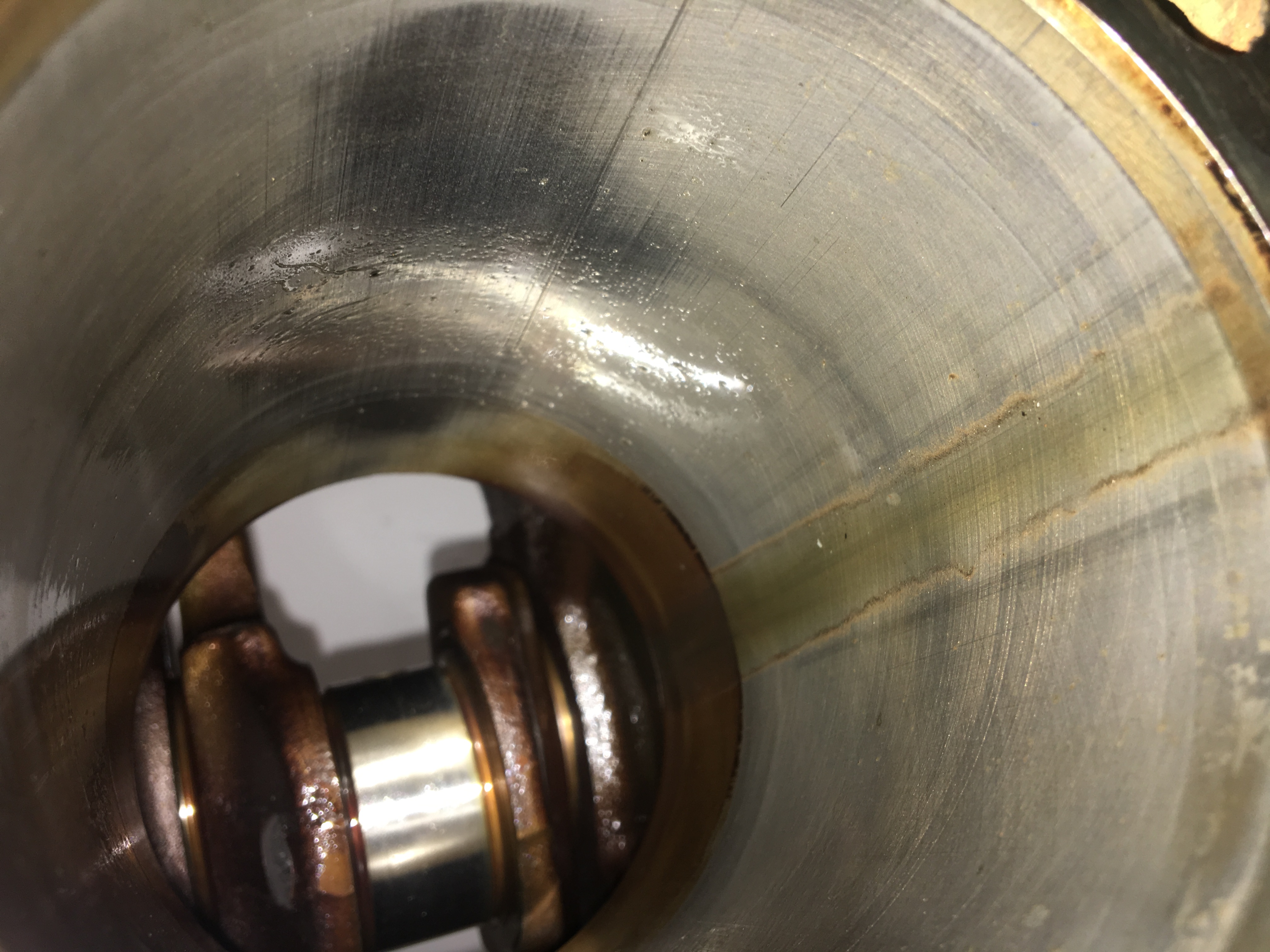

After reading a grotesque amount of information and trying to make sense of all of it, I figured as well as doing my homework I'd make a personal thread.
So I found a guy on Craigslist letting go of a 22R/E block/head (Late model) for nothing. He essentially fried it, saying the cold start injector leaked into holes 1/4 and stripped the oil off of them, killing the engine, and he didn't own a 22RE powered car anymore.
Now while I'd be hard pressed to call the man a liar, but I don't think that's whats happened at all, the block is in great shape, so is the crank/rods, and pistons. (The pistons have superficial damage, nothing on the crown)
To me it looks like somebody dropped something into one of the intake runners and the engine ate it to pieces.
It however does need a cylinder head as it was Shot-peened by metal fragments, needs rod bearings and possibly crank bearings, the block may be runnable but may need a hone at the very least. The pistons are scratched but very minutely, with no damage to the crown.
So now I come to you guys. I've only owned the truck for 6 months, baught it with 350k on the ODO. The engine is the ONLY part of the truck that hasn't been rebuilt, so I was told ,though mine has had a timing hardware refresh and isn't leaking/ having any real trouble at all. It really runs great for how high mileage it is.
I just jumped on the opportunity to have a motor I could build up, with no initial cost over the next year or so, whenever I have spare cash to burn so that on a lazy weekend when the current motor gets tired, I can swap them.
I spend most time on the highway with this truck, in 4th turning about 3.5-5k, I also tow a couple of dirt-bikes+ a trailer, tools, sometimes stalled cars very briefly for my job, and I wheel at a local SVRA every chance I can.
Its also lifted about 3in, mud-tires+rear locker.
Now I know the 22R/22RE was never a tow monster or powerhouse, but I know they're reliable, niche and fun. So I came to the place that knows them best.
In what direction should I build this motor? I've toyed with the idea of high-comp pistions, but who makes those?, will they ping like crazy on pump gas? what about E85?/ complete new head with SS and OS valves from Engine-buldr and a cam, but what cam? and is that a sensible build?
I'd prefer to stay N/A instead of a supercharged build, just for simplicity sake, even if it means I won't be making as much power as the guy with a FI 22RE.
So if you guys were in my shoes, AKA 1 spare truck motor, that you have infinite time/money to build, that's going into a workhorse/wheeling rig, what would you do? How would you build it?
Thanks again for listening to my rambling.

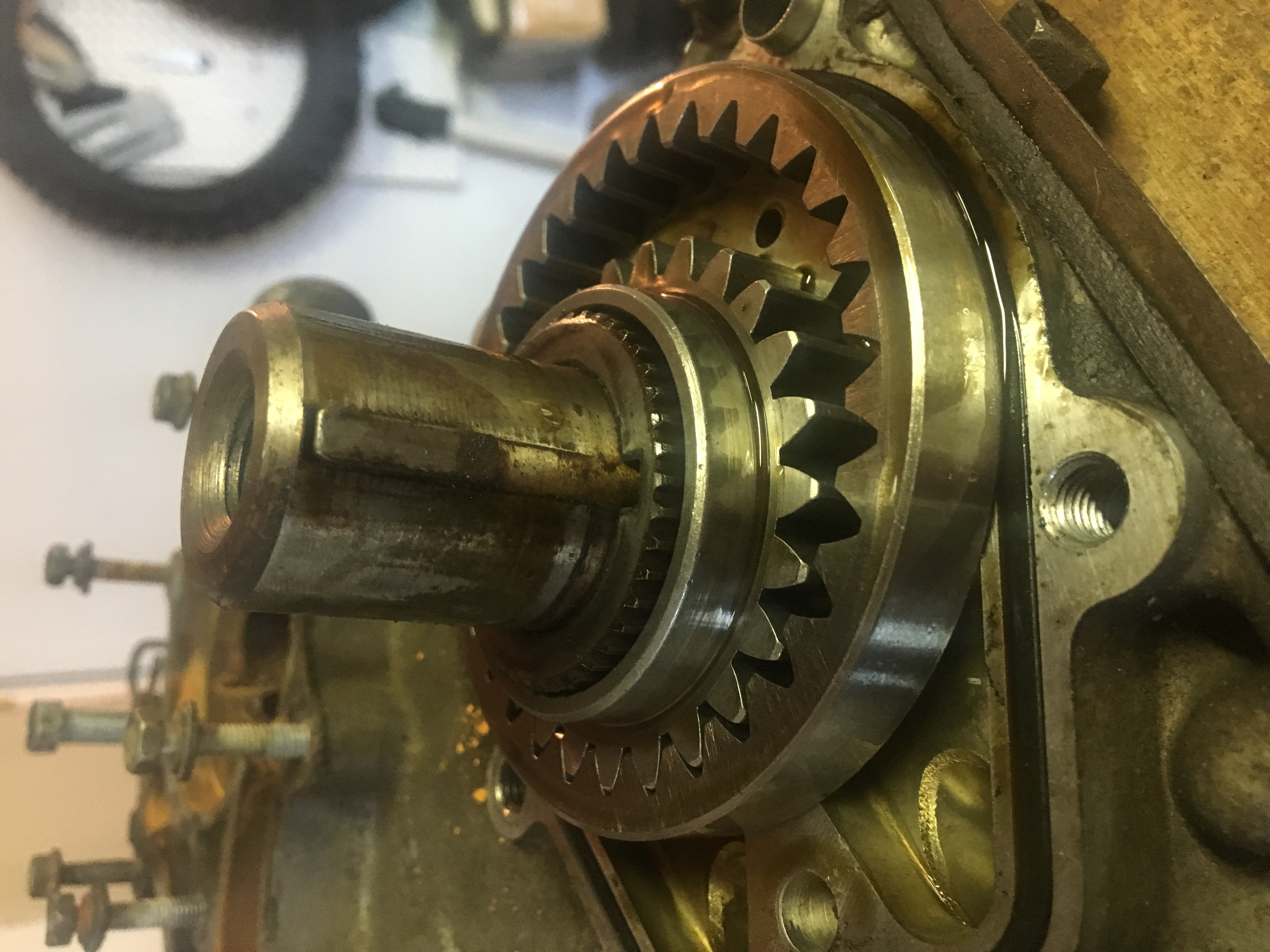

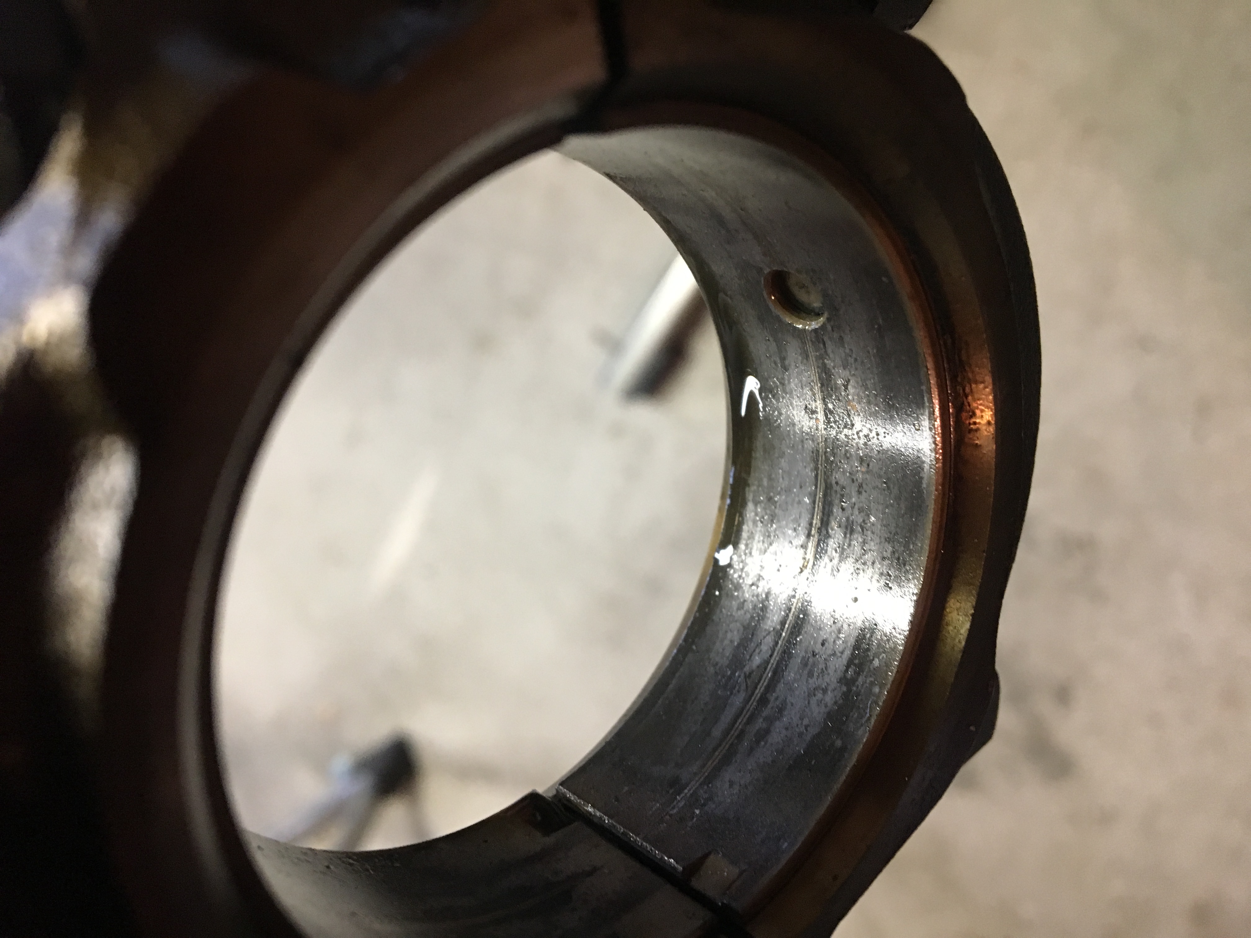

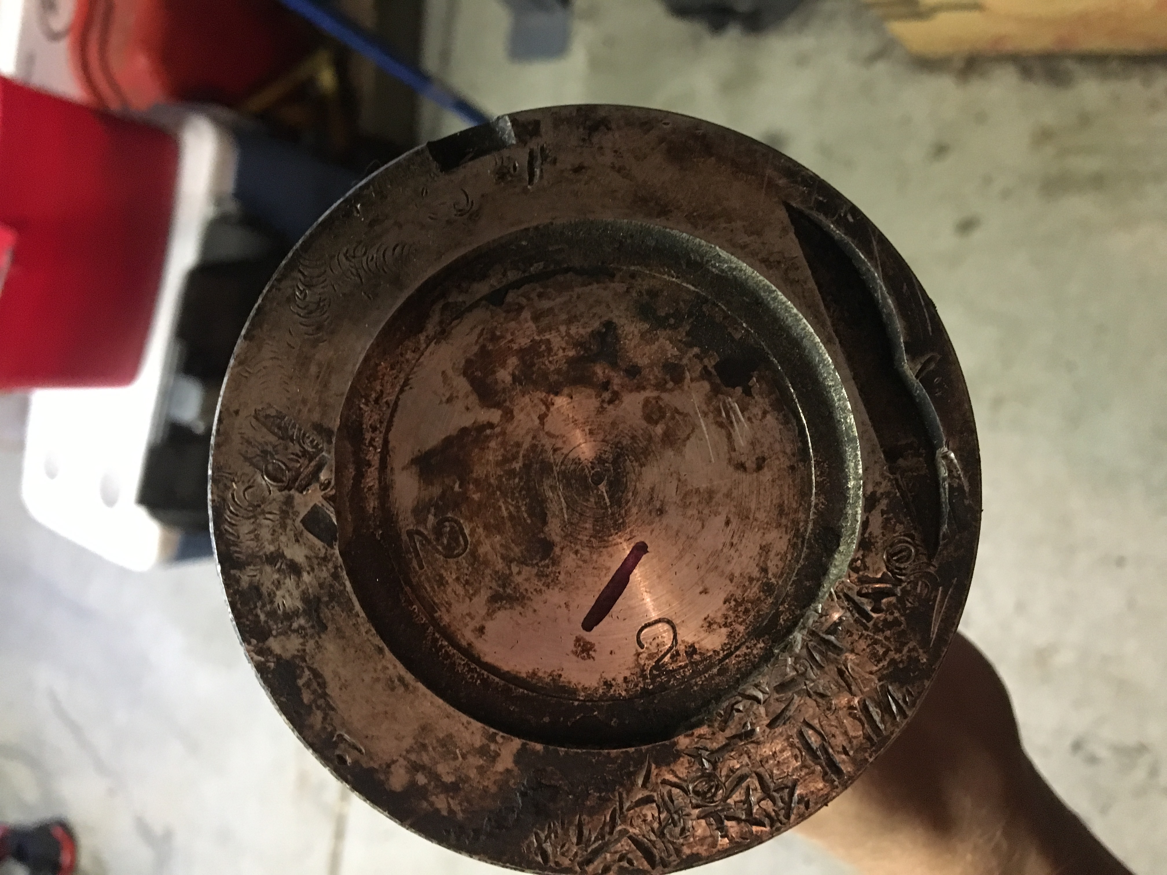

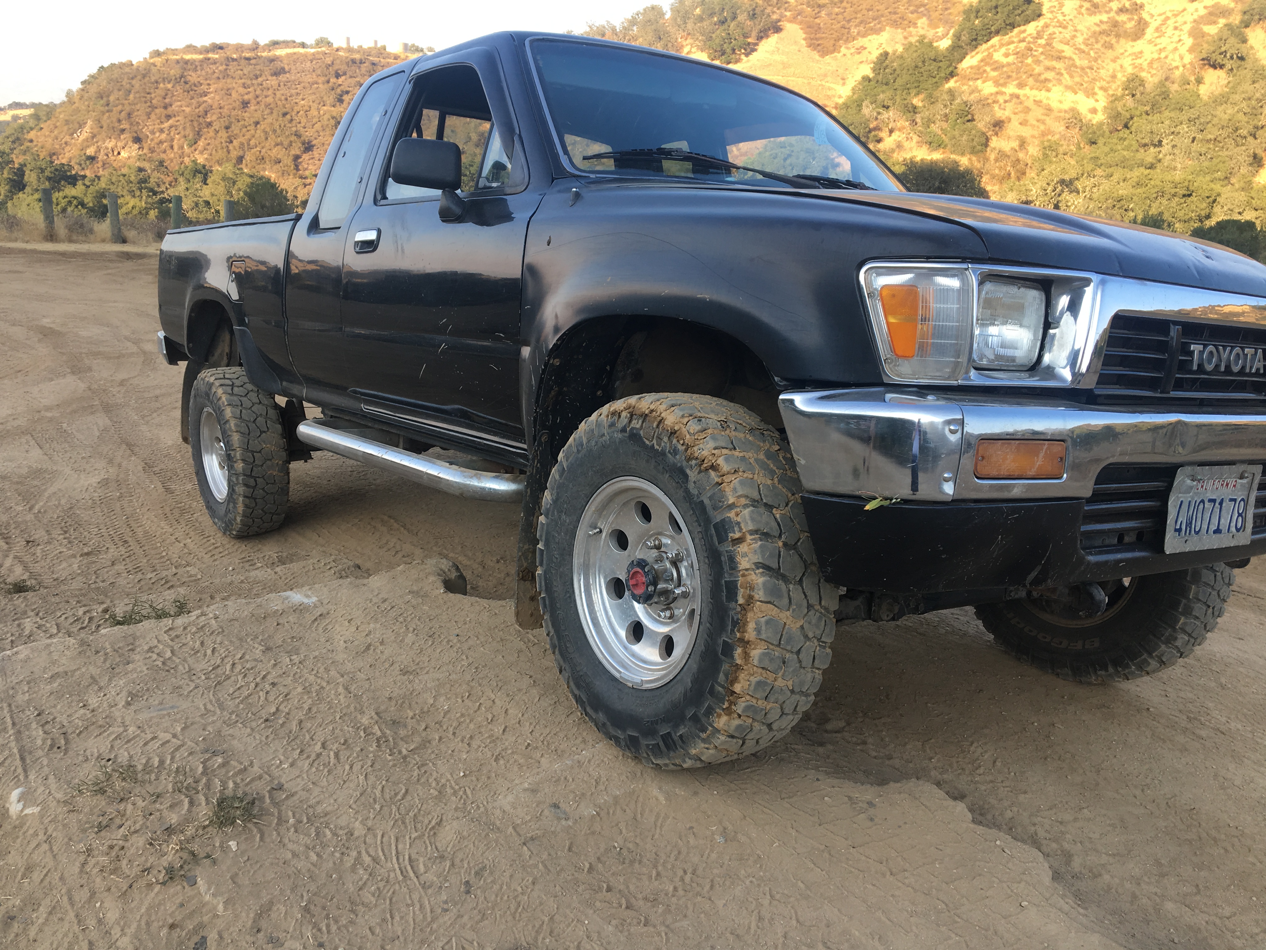

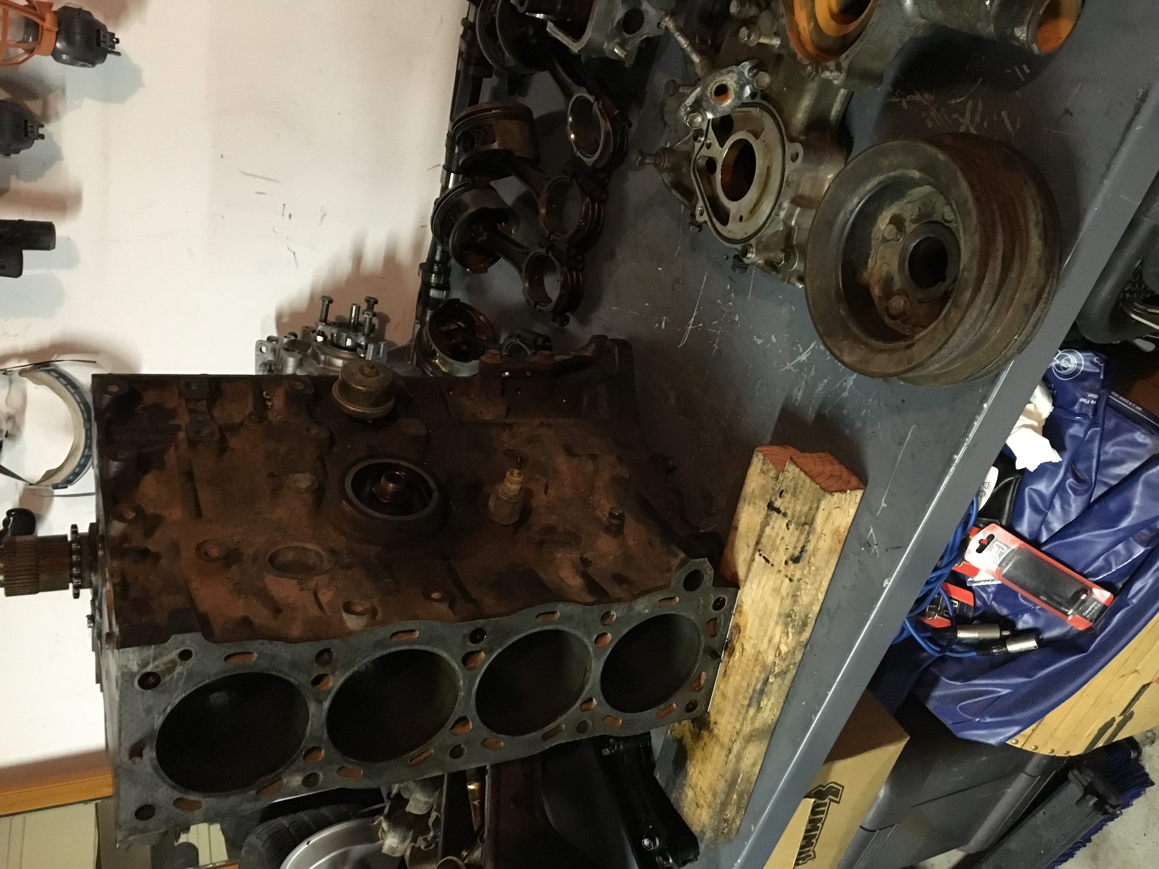

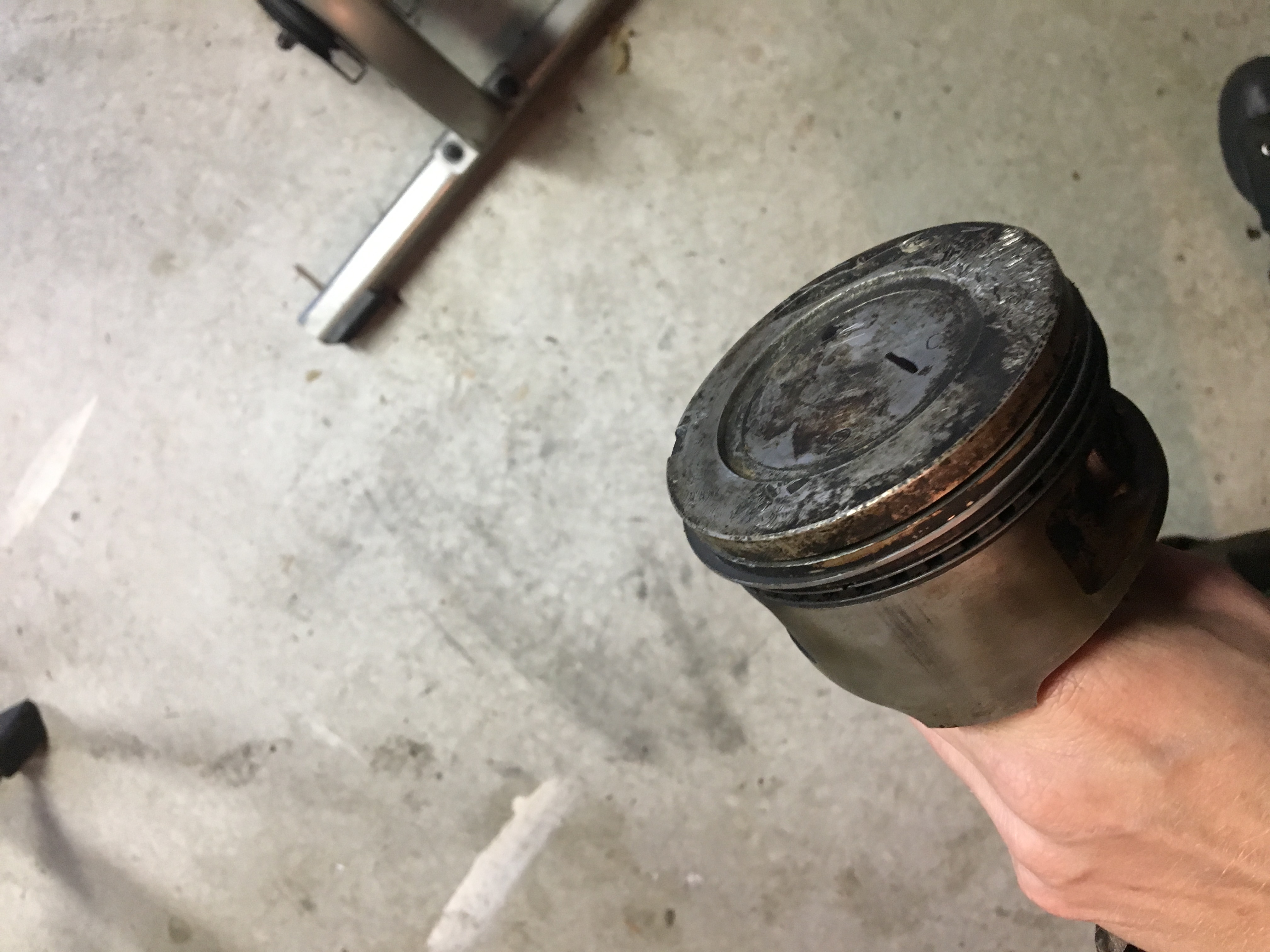

HERES THE ENGINE/TRUCK
Attachment 202790
Attachment 202791
Attachment 202792
Attachment 202793
Attachment 202794
Attachment 202795
Attachment 202796
Attachment 202796
Attachment 202797
Attachment 202798

scope103 Sep 7, 2017 07:05 AM
Wow!
This doesn't advance your inquiry, but I can't help but notice that PART of the top of the piston and PART of the head look like they've been hammered on. What could come loose inside a cylinder that would do that much damage in the quench-space, but not even knock the carbon off the valves? If I had to guess (which is all I can do), I might think that a large piece got into the cylinder, but the engine never RAN after that. Instead, it was cranked a few times (very low RPMs) and that vise-gripped the intruding piece between the piston and the head. But it never ran fast enough to actually knock the piece around.
Good luck!

SlaveCylinder Sep 7, 2017 01:02 PM
Originally Posted by scope103 (Post 52376451)
Wow!
Good luck!
My best guess is somebody dropped a washer or something very small in one of the intake runners, drove it briefly, sounded weird, and there it sat until l I got it apart. My bet is washer or one of the threaded adapters for certain spark plug wires that thread onto the back of old- school plugs.
Also on cylinder 4 it did knock off some carbon, and there are actually marks on the valves themselves.
Weird that it'd be both 1-4, which is why I guess he determined a leaking cold-start injector.

Co_94_PU Sep 7, 2017 07:05 PM
#1 lost the upper ring, that cylinder is very gnarly.
You are going to need to measure it up and see if you can get it bored and trued up and stay with in the available part sizes.
Once you start boreing out the cylinders you will lose compression ratio. So if you want more power your only real option then is a stroker kit..
