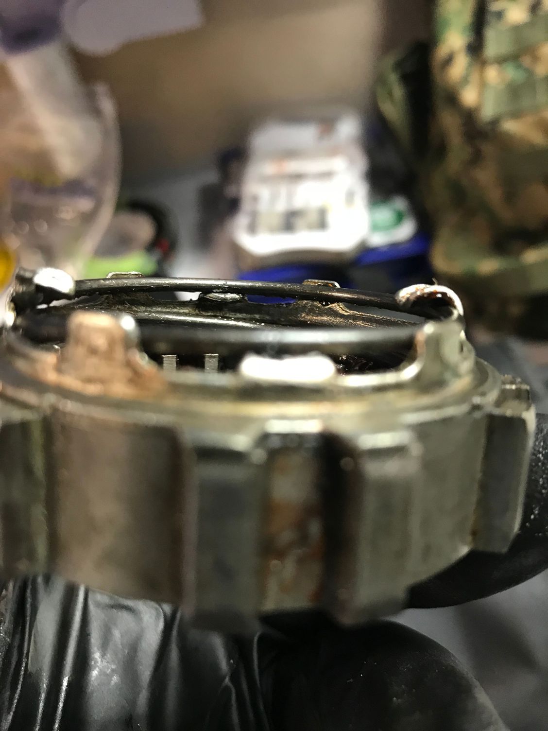

Well after taking this to Toyota to see if they could fix, and walking away with a $700 estimate I’m happy to say I was able to fix myself. So I tore the hub apart again.... trying to figure out how it could be not pulling back just a tiny bit. I figured I would try bending the clamps that hold the spring in just a tiny tiny bit. Reinstalled and viola. Good to go!https://cimg6.ibsrv.net/gimg/www.yot...b6e19457d.jpeghThese two are the clips. I put in a bench vise and barely snugged just a fraction.Hope this helps anybody that has similar issues!
