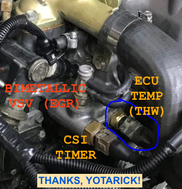

https://cimg0.ibsrv.net/gimg/www.yot...42549d107.jpeg
The circled one.

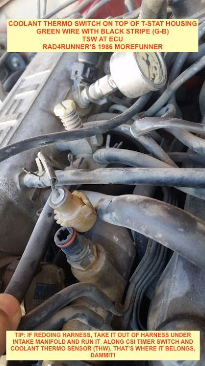

Not very clear but that seems the temperature GAGE sender - Will not affect running. Here are other temp sensors, including BVSV mentioned above:
https://cimg6.ibsrv.net/gimg/www.yot...666c1c95ad.png
https://cimg5.ibsrv.net/gimg/www.yot...b351b4c059.jpg
https://lh3.googleusercontent.com/Gv...Z=w362-h375-no
https://lh3.googleusercontent.com/A-...6=w418-h743-no
The green Temp sensor had a crack in the plastic, allowing it to move, disrupting the connection. When I checked voltage everything was good, but couldn’t tell that it was broke until I moved everything out of the way to pull it out. For now she is running like normal.

I think the one with green connector is the Sender for the ECU, so yes, that would affect running.
