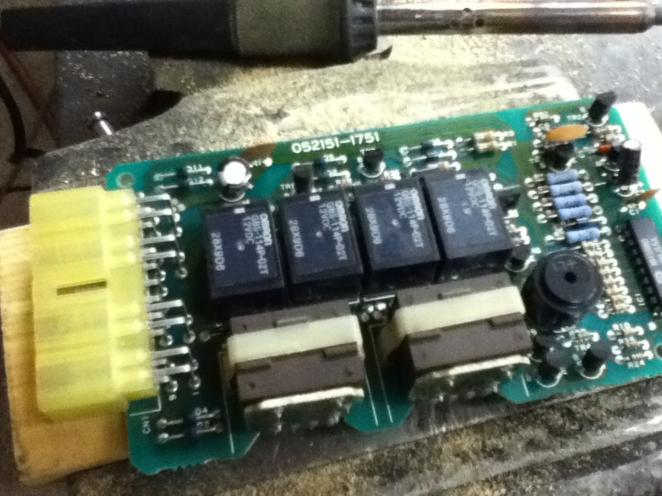

This is my first post so I figure I should do something useful :nerd: I had a problem with my rear window not wanting to roll down all the time (only when it felt like it) for about a year. It finally stopped working all together before I decided to do something about it. It took me a while to track down the problem but, long story short, it ended up being the relays in the Window Control Unit. I took it out and removed the plastic cover. Looks something like this-
Attachment 89593
Then I de-soldered and removed the relays.
Attachment 89594
I went down to the local RadioShack and picked me up four of these-
