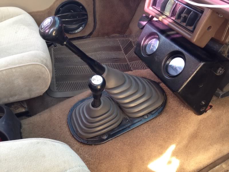

1 Attachment(s)
I used one out of a 3rd Gen Pickup.
Attachment 169207

JustDSM Feb 11, 2013 03:08 PM
I picked up mine on eBay for $10-$15 IIRC.
Sounds like you've got a workable plan!
Note: On the redlinegoods boot, that "plastic" trim is actually rubber. It's an OEM piece on the trucks. I *might* still have mine laying around. Doubt it though..

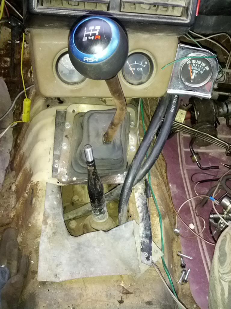

Originally Posted by dropzone (Post 51992441)
Been running around for awhile with out a cover over my shifters. Decided it was time for a change:
http://i119.photobucket.com/albums/o...029_132037.jpg
been collecting assorted shift boots for awhile
http://i119.photobucket.com/albums/o...029_132508.jpg
Cut some thin aluminum diamond plate to size and fit some shift boots:
http://i119.photobucket.com/albums/o...029_144203.jpg
http://i119.photobucket.com/albums/o...029_144216.jpg
Bent it to fit with a small HF Bender
http://i119.photobucket.com/albums/o...029_144854.jpg
Painted and mounted
http://i119.photobucket.com/albums/o...029_155230.jpg
Need to get some armor all or something to clean the boots with

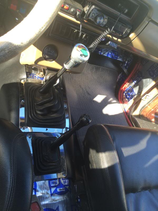

1 Attachment(s)
Here is what i did. Not the cleanest in the world, but i got the parts for under $30 and got it all done. The floor under them is pretty torn up from a W6 conversion.
Attachment 124683

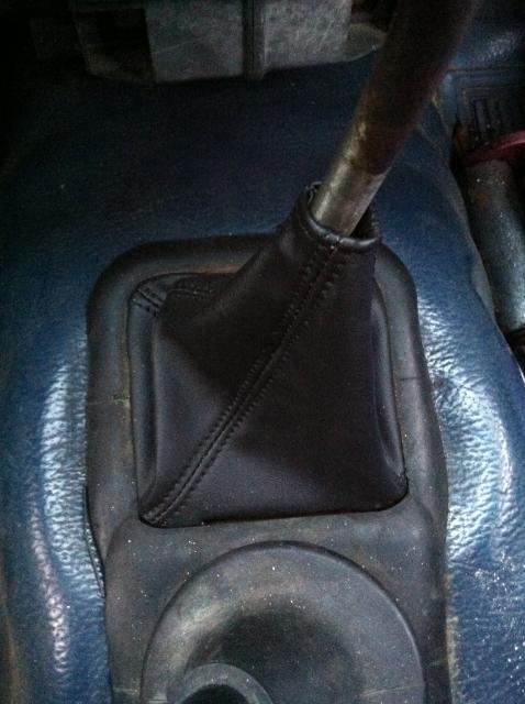

2 Attachment(s)
If you're after leather/fabric shifter boots, I have that covered.
Attachment 124052
Attachment 124053
I sew and upholster, and have taken apart and patterned mine, and am ready to make more if the occasion arises. See thread on this for pricing: https://www.yotatech.com/forums/f109...9-83-a-285000/
dropzone Jan 25, 2015 04:02 AM
Originally Posted by Justin Cooper (Post 52248249)
@dropzone how did u connect it t the floor though? I have a 83 got a factory boot/plate that will fit the hole. But not sure how I'm a mount it.
mine is connected at the two tabs up front using the two 10mm bolts and at the rear of the tunnel i added a couple of tabs that you can't see.
plus with the boot pushed down on the rear T/C selector it would have probably been able to hold the tunnel cover in place.
on the stock trim ring there should be 3 holes on each side that correspond with 3 holes down each side of the lever holes in the tunnel.
I believe they had a plastic looking anchor/insert in each hole. sorry mine has been covered for a few years so i don't recall
