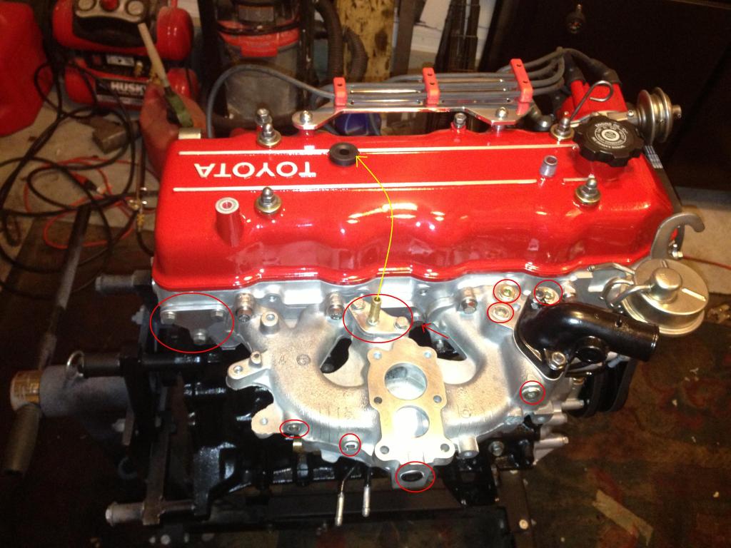

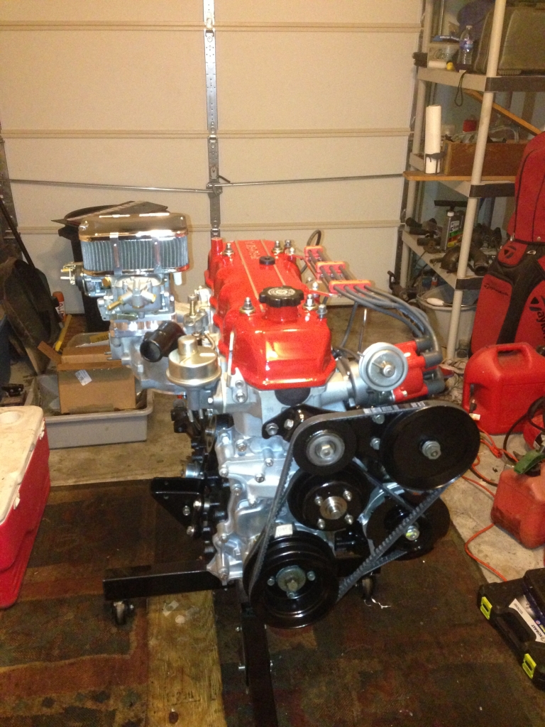

Right now, your engine should be free of the birds nest of vacuum hoses and emissions equipment. Go ahead and remove your headers if you haven't already (you'll probably need a new gasket anyway). If you removed everything then you should have the following left:
-The core of the motor (block, head, valve cover, timing cover, water pump, oil pump, fuel pump)
-Distributor (with no vacuum hoses attached)
-Intake manifold (bare with no carb, hoses or fittings attached)
It should look a little something like this (if you removed the intake manifold):
Attachment 170948
or this (if you left the intake manifold on):
Attachment 170949
Don't mind the circles, I get to those in a minute.
This is a good opportunity to clean the gasket surfaces and make sure that everything is removed.

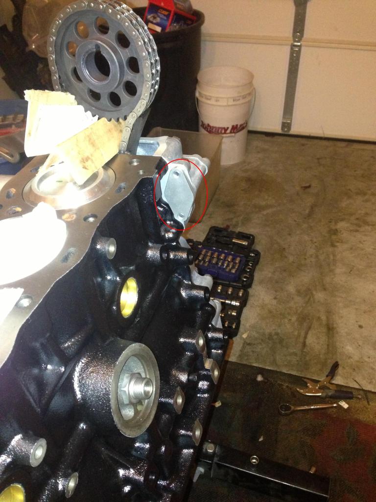

Next is the LCE Water Block Plate Kit (11 Bolt) located under the intake manifold. The elbow fitting supplied with the kit is for your heater core (optional if you choose to keep your heat) and new bolts are included with the kit as well. The factory hard fuel lines will bolt back up if you decide to keep them (recommended). Also in the below picture, you can see the locations of the plugs that come with the LCE Intake Manifold Plug Kit. The far left two plugs were temporarily plugged during my build, but will later be used for the brake booster fitting and the manifold advance to the distributor.
Attachment 170939
Here is the intake manifold bolted up. Notice the plug locations, the EGR block off plate to the left and the water block plate in the middle of the head. The barb fitting with the yellow arrow pointing to the PCV valve is an option. That particular plate and barb comes with the Weber kit; however, you can use the LCE EGR Block Plate Kit (Carb Manifold Plate) which DOES not have a barb and utilizes a breather filter on the PCV valve (for race applications). I would not recommend using the breather filter on the PCV because it can get reeeeeally messy under your hood really quick if something goes wrong.
Attachment 170940

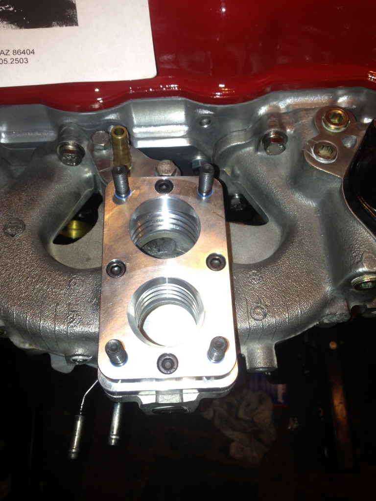

Here's a shot of the LCE Spiral Adaptor for the Weber 32/36. I would recommend this, but it is not necessary to desmogging. This pic also gives you more of a close up of the manifold plugs and block off plates:
Attachment 170941

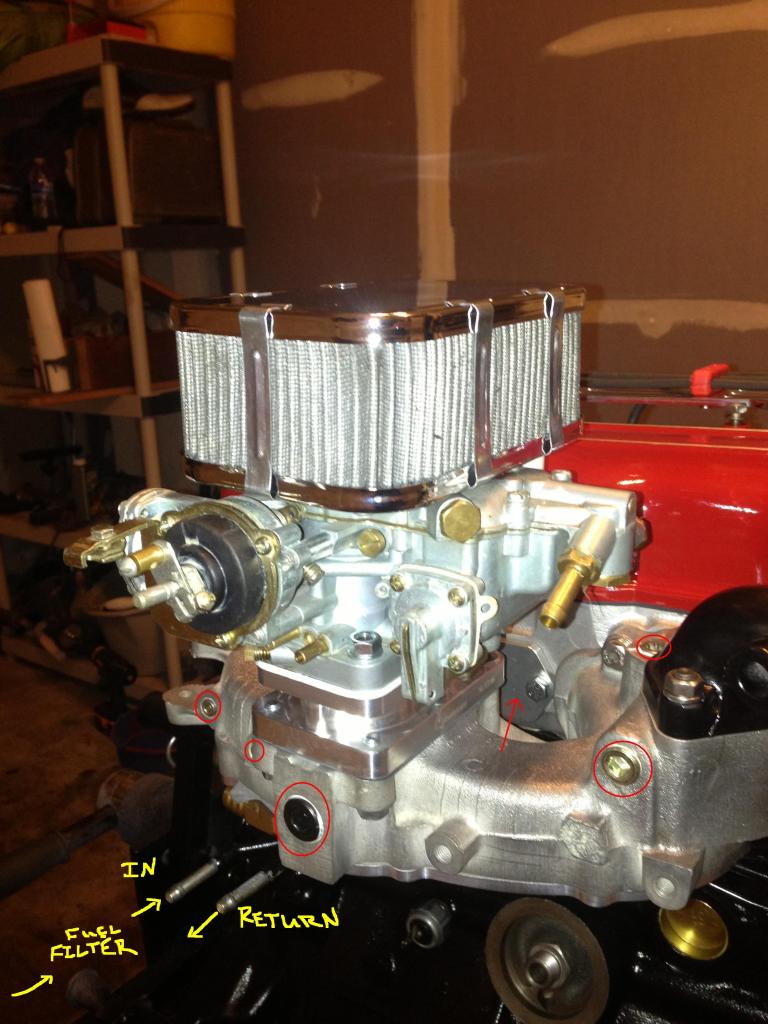

Your engine should now look something like this. Notice NO vacuum hoses and no fuel lines, we are getting to that. If you still have some fuel lines and vacuum lines then you didn't read the first step:
Attachment 170937
Attachment 170938

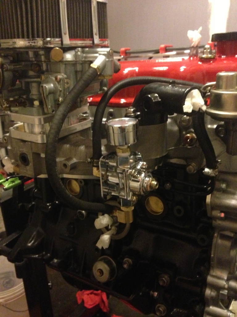

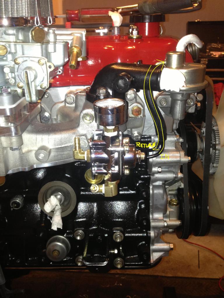

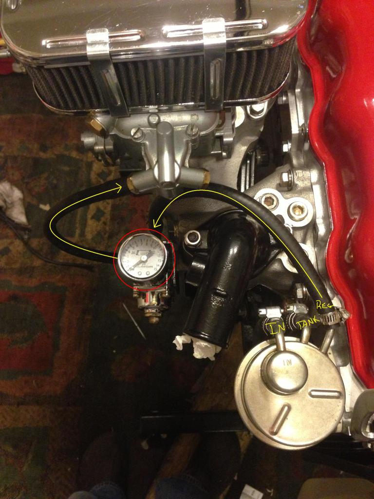

Now you can start the plumbing. Run a hose from the PCV valve to the manifold using the barb fitting that came with your Weber (note, if you chose to use a breather filter on your PCV valve then you will be installing that instead):
Attachment 170931
Install the Holley fuel pressure regulator. I used the bracket that came with the regulator and mounted it to the intake manifold. You can either do this or run it back to the fender wall. I prefer it this way because it is cleaner and keeps the hoses to a minimum. You will have to use the 3/8" NPT male to 1/4" NPT female reducer fitting to install the gauge and the 3/8" male NPT to 1/4" barb fittings to attach the fuel hoses. Run the Fuel "IN", Fuel "RETURN" and Fuel "FEED" lines as shown below:
Attachment 170932
Attachment 170933
Attachment 170934
Attachment 170935
Make sure that you have the Fuel "IN" and Fuel "RETURN" lines hooked up properly at the other side of the hard fuel lines under the manifold and at the tank. You will only need about 6 ft of 1/4" fuel hose to do the job.

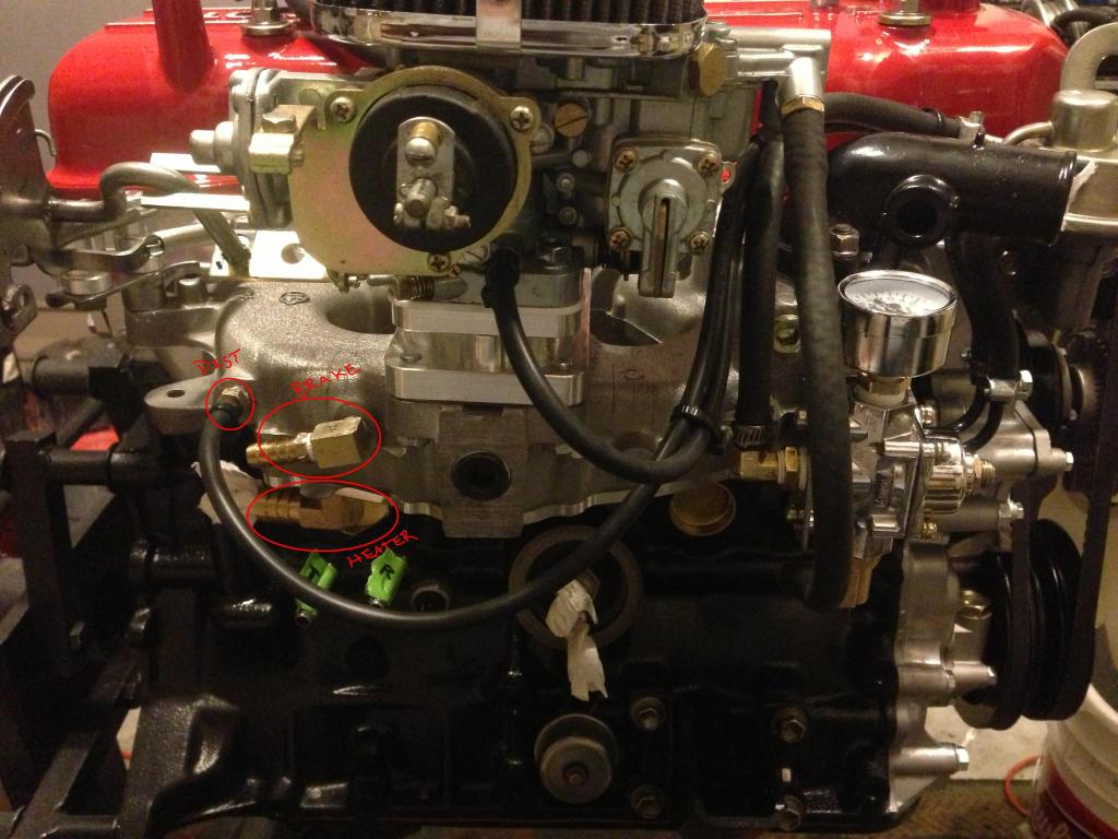

NOTE (11/30/2015): I talked with a tech from LCE a few weeks ago about the timing and advance on my truck and he said that the idle/manifold advance (port closest to the head) on the distributor is not necessary to use (#1 in the pictures below). I have since removed that vacuum hose and plugged the fitting on my setup and my truck is running well with a a more appropriate advance at higher RPM.
You now only need TWO, 2, DOS, DUEX vacuum lines!
1) Main/Port Advance - From the vacuum port on the distributor closest to the radiator to the vacuum port on the Weber.
2) Sub/Idle Advance - From the vacuum port on the distributor closest to the head to the vacuum port on the intake manifold. For the manifold port I installed a 1/4" NPT Male to 3/16" barb fitting on one of the existing holes on the intake manfold (temporarily plugged earlier).
You will only need about 6ft of 5/32" vacuum hose. See below:
Attachment 170929
Attachment 170930
Also in the picture above, you can see the 90* barb I installed for my brake booster (you can use the factory barb, but I wanted the hose to be better routed) and the 90* barb for the heater core that comes with the LCE Under Manifold Water Block Plate Kit.
