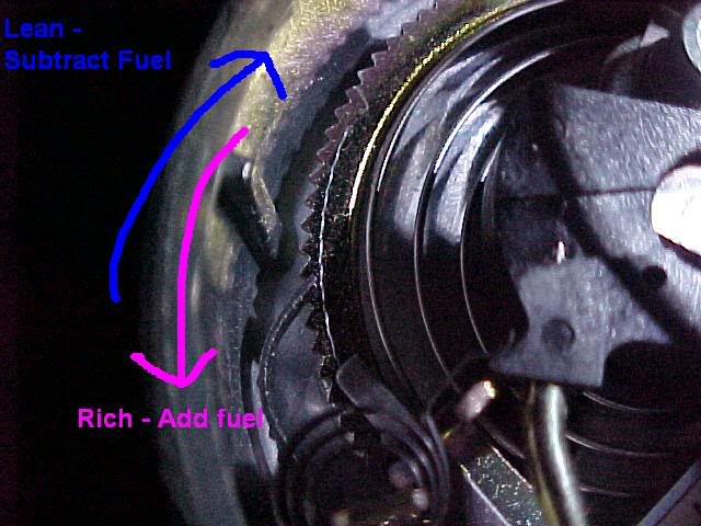

Probably wouldn't need to do that. I'd try adjusting the AFM first. Leaning it out that way works very well. Just tighten the spring so the ECU thinks it's getting less air, then it will add less fuel. Lots of available adjustability there. It's when you try doing the opposite, loosening the spring to richen the mixture, where you can run into problems. Too loose and the vane won't want to close all the way.

1 Attachment(s)
Yeah, it's not altitude. I wheel my truck at 6000-7000 ft with no issues.
Big Bear, I'd try adjusting the cog inside the volume air flow meter. Cut open the silicon and pry off the top. Take a sharpie and mark the original position so you know where to turn it back to. Once open, release the metal tab holding it in place and rotate counter-clockwise as shown below:
Attachment 152553
Start out with about 4 clicks lean. If still not work, try 6, then 8, 10, etc. etc. That will fix the issue unless you got a more serious one like a bad ECU.
