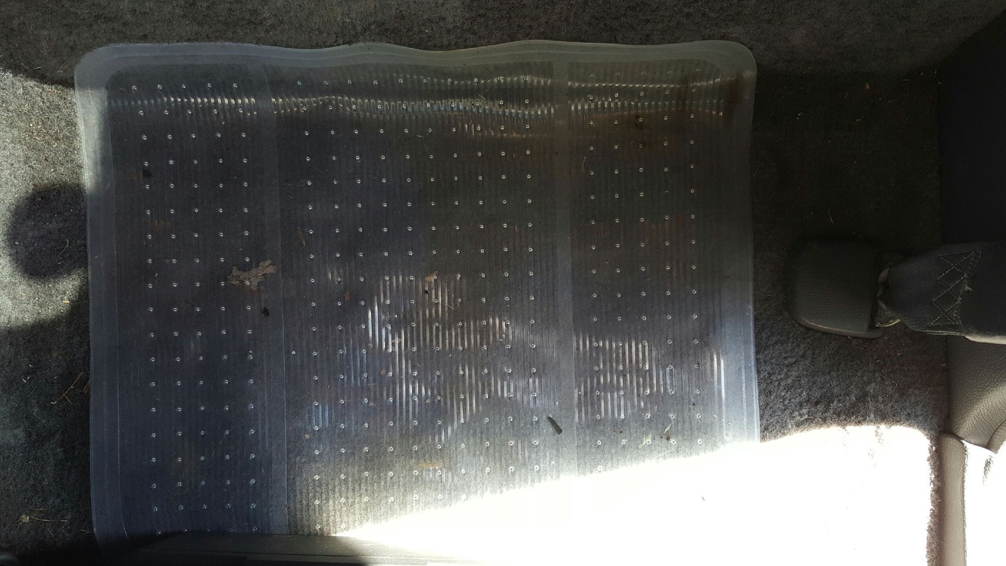

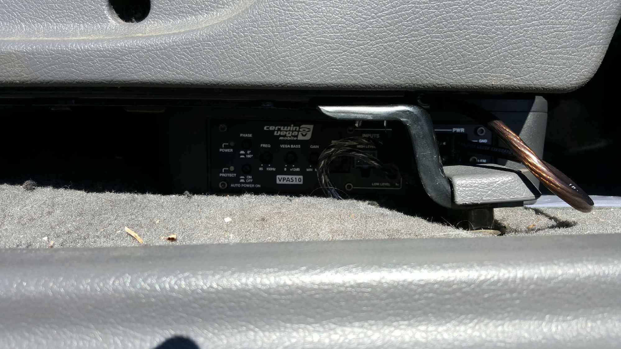

Dont mind the mess....installing LEDs
Under the seat while in driving position
Under the seat @ full forward
Rear foot space with seat fully back
Subwoofer exposed w/ seat fully forward.

my only concern would be that your speaker wire (maybe a ground) looks kind of vulnerable hanging out there like that.
maybe it is a non issue if you don't slide the seat back and forth a bunch with kids/dog hopping in the back

my only concern would be that your speaker wire (maybe a ground) looks kind of vulnerable hanging out there like that...
Yes, looks like a ground and potentially could be tucked in better. Someone on T4R used a Pioneer under-seat sub. I asked him how it looks with seat fully forward and backward.

No kids. I try to never move the driver seat, I have it set just right! I needed the long ground wire to be able to move the sub without having to mess with the tiny aluminum set screws. Which is probably my only complaint about this speaker. Those tiny fragile set screws for the Ground/Power and Remote. The Pioneer looked good too but was very similar to the Kenwood. Weird oblong speaker.
