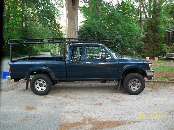

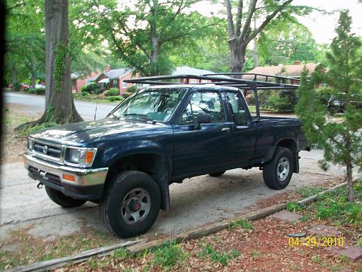

My dad recently passed on to me his 1995 Toyota truck. He has always told me it was a 1995 Toyota Pickup. However, I can not find any information on the '95 Pickup. I can only find information on them to a 1994 model.
The title reads:
Year: 1995
Make: Toyota
Body: TK
Model: HTPXLX
So I looked up the VIN number on CarFax and it has this truck listed as:
1995 TOYOTA 1/2 TON XLONG WB DELUXE
I am trying to put a new cd player and speakers in this truck. But any website that lets you enter the year, make and model to give you a list of speakers that fit...only have info on Pickups up to 94. A 1995 Toyota Pickup is never an option.
Can anyone give me a little more information on the model of this truck?

its a '95 pickup. but if your trying to get speaker sizes im sure allot of members can help you out. 4t sized front speakers, 5" rear speakers. factory amps in the rear "doors". good luck with the sterio install, its a PITA. you need to bypass the rear amps. you will be best off if you just run all your own wires instead of buying the adapter.

95 is the split year
89-95.5 is Toyota Pickup
95.5-up is Toyota Tacoma
Yours is a Pickup

There are no differences between '94 and '95 TRUCKS so you will be fine with '94 stuff.
