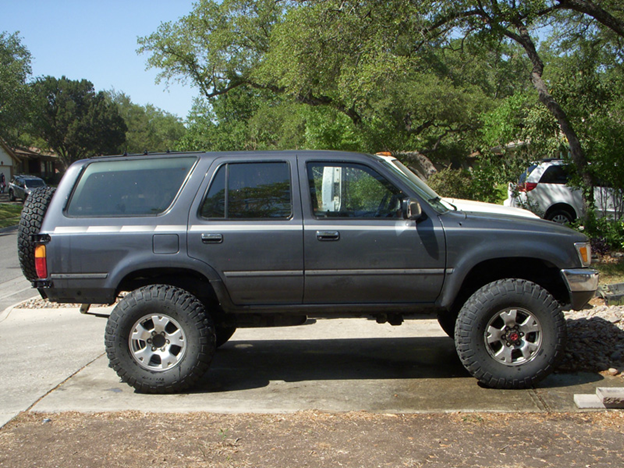

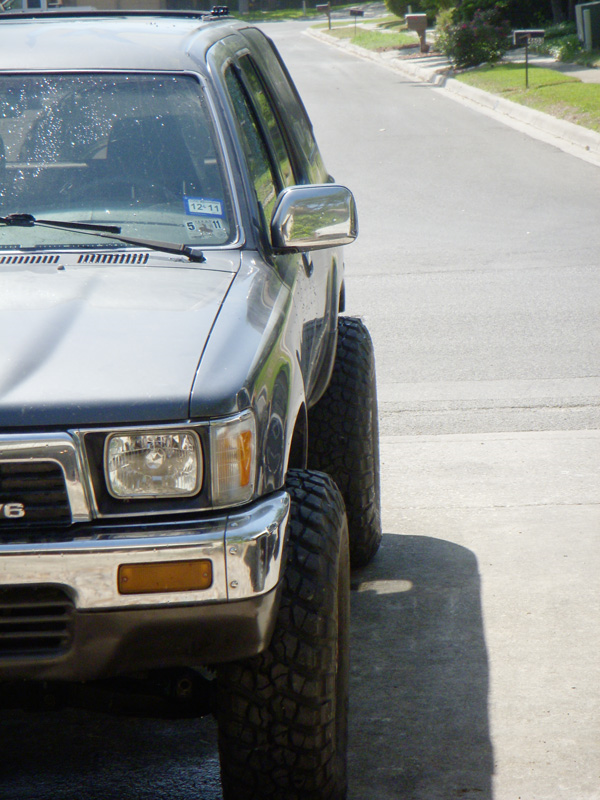

I'm right there with you on liking the idea of long travel but not the extra, super wide stance that comes with it (purely for appearance, nothing to do with functionality).
It looks like his pictures are gone, which is a shame, but look at drew02a's build of his 91 4Runner with Blazeland and some Tacoma (I think) rims. With the high backspace and narrow width of the stock rim plus the super narrow 255-85R16 tires, it looks like the wheels/tires only stick out a couple of inches.
Here's his build thread:
https://www.yotatech.com/forums/f199...thread-233772/
And here are a couple of pictures I happened to have saved off:
