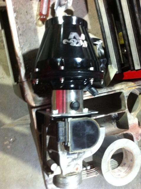

Next hurdle... The K&N apollo enclosed/inline air filter I had purchased to be the main filter element had a 70mm outlet on the MAF side... and the adapter was 3"... So my temporary Mcgyver fix was the magical duct tape to increase the diameter of the filter outlet to make it fit snug in the adapter
Attachment 155498
On everything went for a trip to the parts store take 2
Attachment 155499

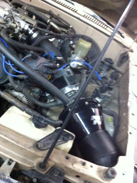

As you can see... It is a tight fit with the adapter adding enough length to push the long filter element/housing up into the back of the headlight... This just would not do, as I need room for an elbow through the fender wall.
This was the solution I came up with
Attachment 155500

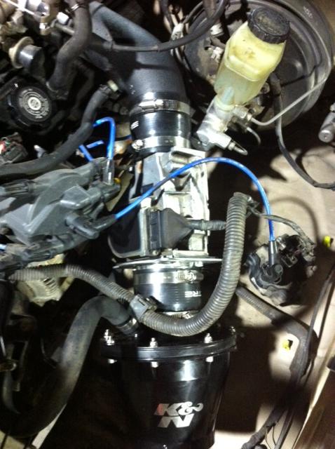

Junked OEM rubber flexy downtube thing for a 3"-3" rubber adapter from Intake Body to reused K&N FIPK tube (handily tapped for a vacuum hose already), once the hose clamps cinched down they fit snugly. A 3"-2.5" rubber adapter for plastic FIPK tube to MAF which required nothing other than a little persuasion. And a 3"-3" rubber adapter worked great for the MAF-filter outlet tube, the hose clamp was tightened down around the neck of the K&N and it is solidly attached and sealed.
Last thing to note was I (as seen in pic) tilted the MAF so the sensor is tilted to about 0130... This made it clear both the master cylinder and distributor cap and positioned it so there isn't anything fragile for it to bounce on/around come the inevitable offroad jolting.
I also routed the valve cover breather tube up and over the FIPK tube, under the throttle cable to a small filter element right underneath the upper portion of the hood, I figure if I am in water that deep I've got bigger problems than water in there
Now there is plenty of room for fiddling around with the inevitable erector set of PVC to come :wrench:

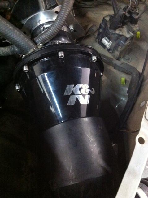

This is what I used to connect the K&N Apollo into the snorkel body. The outlet on the K&N is huge, and there wasn't room to route pipe reducers before an elbow so I needed both. This piece is a 4"-3" 90* reduction elbow, with long (4-5") runout on the large side and a 3" coupling end on the 3" side.
Attachment 155241
And coming off the K&N
Attachment 155242
The 4" side attached snugly to the K&N (add a little silicone sealer and it will be bombproof)
Attachment 155243
I then picked up a flexible hose coupling at a local plumbing supply shop, tough (and a little pricey) piece of neoprene that has a ton of flex if needed. I cut off the enlarged OD bushing end of the ABS 90* closet elbow and the neoprene flex fit perfectly. I then cut a hole in the inner fender (measure, cut, measure, cut, etc etc) till I could slide the elbow through
Attachment 155244

A crappy picture of inside the engine bay and everything attached (I am singlehandedly helping spectre intakes turn a profit this quarter)
Attachment 155248

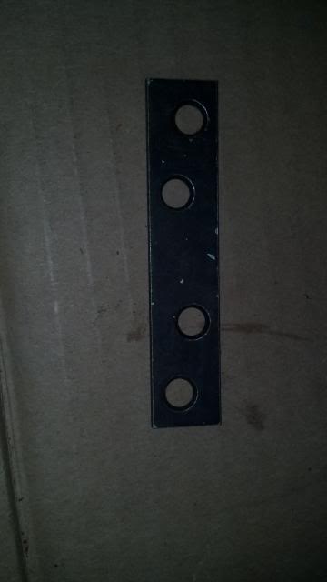

gmack192 Aug 13, 2013 04:10 PM
I used flat metal straps, from Lowes (in the hardware section) held down with 4 self tapping screws and hose clamps.. the snorkel has been on the truck for 4 years with no issues other than knocking the head off it a few times... I think the adapter I used was the problem there.. I have a rubber one now so it flexes better and I try harder to watch for low hanging limbs...
If you want I will try to get a close up picture for you tomorrow..

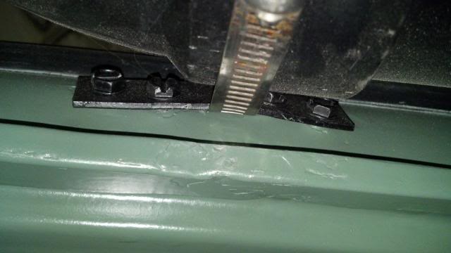

I searched and searched for this post..... I did get you pics of how I secured the snorkel to the A-pillar.
Plate:
Attachment 154704
Secured to the A-pillar with self tapping screws:
Attachment 154705
I will help any way I can if you have any questions..

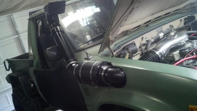

Work proceeded tonight on the snorkel... After exploring lots of different options, I decided that the only way I was getting a 3" ID pipe to fit under the fender cleanly was going to be some :saw:
So... To work!
This is the under fender support I cut out, as you can see... It freed up quite a bit of space and would be impossible to fit otherwise... Taking inspiration from here...
https://www.yotatech.com/forums/f88/...uild-up-79074/
I chopped!
Attachment 154279
This is a picture of the pipe I routed underneath the fender once the chop was complete... It is the bendy neoprene to a 3" ABS piece of pipe, and then a 3.5" (the OD of 3"ABS pipe) to a 3" reducer. I then got a piece of flexible dryer tubing (which is surprisingly tough) and routed it from the coupler to a 18" long 3" exhaust pipe I was using as a test piece, I originally tried using flexy exhaust tubing but it wasn't bendy enough
Attachment 154280
I than cut the pipe piece to the angle i wanted, traced it out on the fender and :saw:!!!
Attachment 154281
It routes fairly far away from the A-Pillar, I am going to go to a exhaust pipe shop to get some pipe bent for the snorkel body and see if that can be remedied or if I will need to chop the fender some more...
Picture of how it lays under the fender
Attachment 154282
Starting to take shape, next is getting the tube bent, securing it to the pillar and getting some rubber to cover the edges of the hole in the fender
