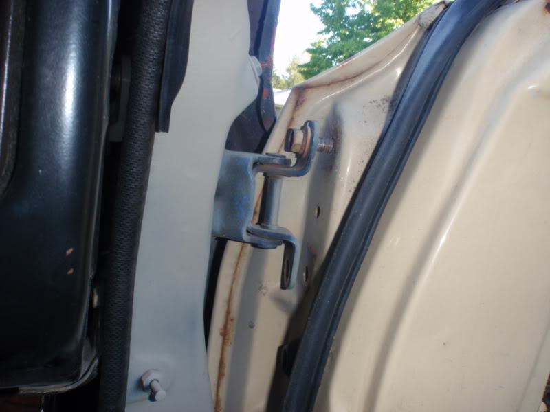

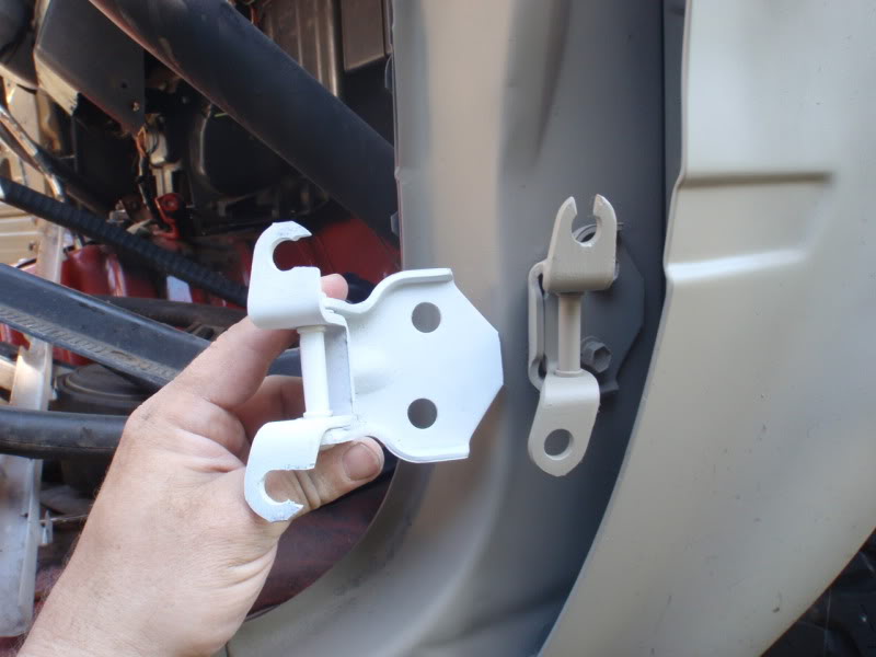

This is what I did after hacking up a couple of sets of hinges.
Disregard the white Hinge on the left..that brain cramp failed miserably. .I notched the Top bolt hole, allows you to loosen the top bolt slightly and the door will rest in the notch. I can swap both doors in about 10 minutes and it is very secure.
Attachment 140995
Attachment 140996
tighten and adjust and I am good to go.
Taco98 Mar 4, 2014 08:03 PM
Dropzone. So you have to install and remove the bottom bolt everytime I would assume.
dropzone Mar 5, 2014 02:13 AM
Yes..
