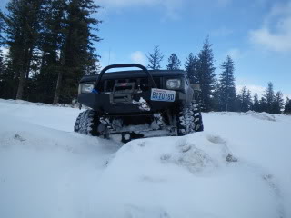

R.DesJardin Jul 24, 2013 05:30 PM
1 Attachment(s)
Looks good, I love plate bumpers
Attachment 156383
