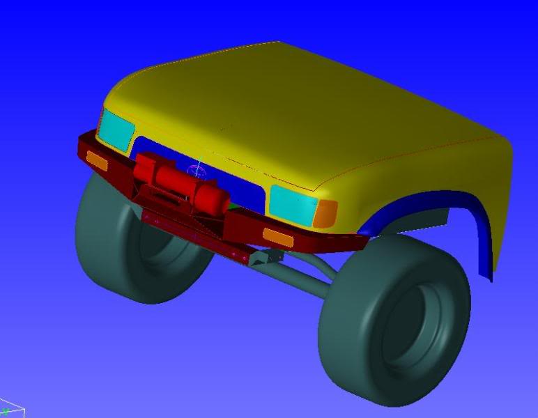

The next weekend we sat in front of Cescīs PC and started drawing some ideas ( unfortunatelly, we have more for the future ...;-)
For me, it was very clear that the bumper had to start inspired on Front Range Off Road bumpers style (unfortunately not sold in Spain and very expensive to import...).

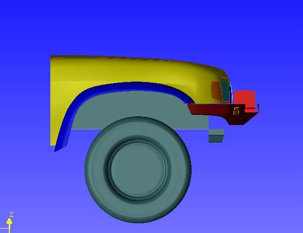

We took of the original front bumper and started taking measurements and putting them into the pc.
Attachment 181694
Attachment 181695
Attachment 181696
After many, many, many hours, and when I say many, means that we sat many ours in front of the pc, finally we had the final design.
Attachment 181697
Attachment 181698
Attachment 181699
Attachment 181700
Cesc take care of the technical part, calculous, structures, drawing, etc...
Meanwhile I sat next to him, with my stupid face, looking how this guy worked with CAD.

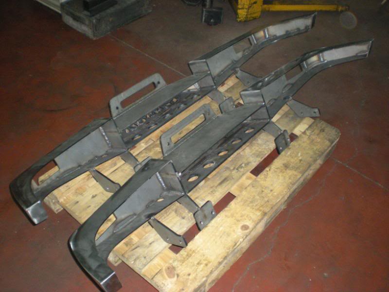

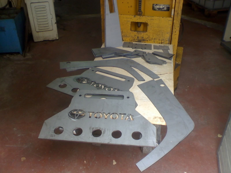

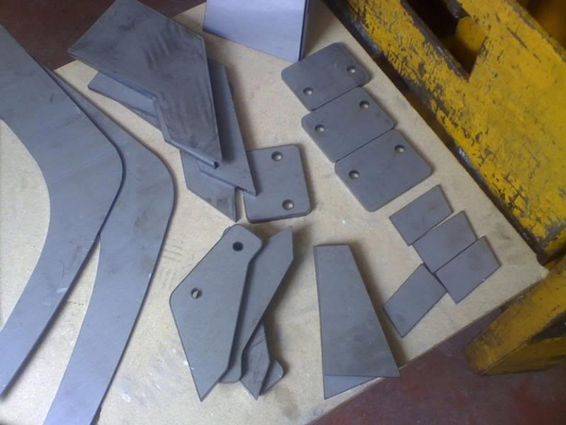

On the next step we got all metal pieces cut by laser. 8 mm thick for the center box, and 4 mm thick for the wings of the bumper. (Total weight of the bumper 36kg, and 31kgs the winch)
Attachment 181701
Attachment 181702
After we got all the pieces of the puzzle, the funny part of the project started.

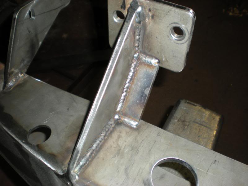

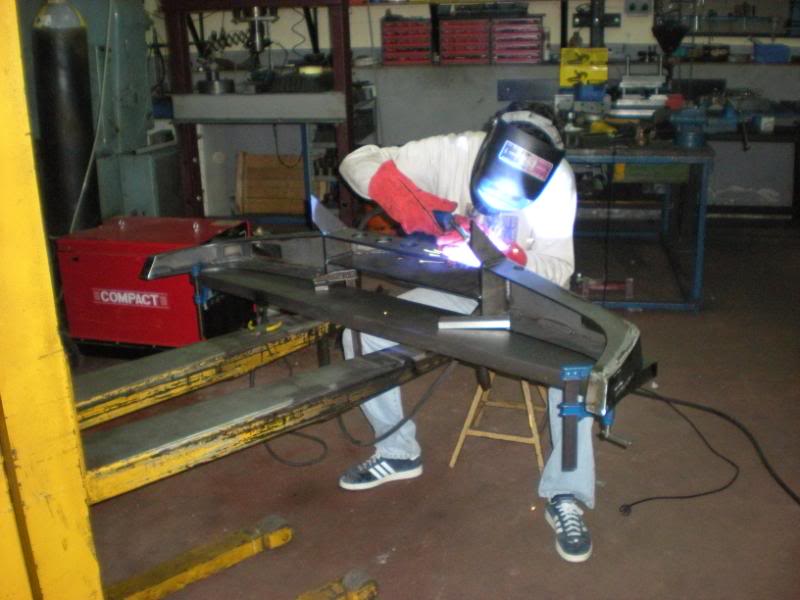

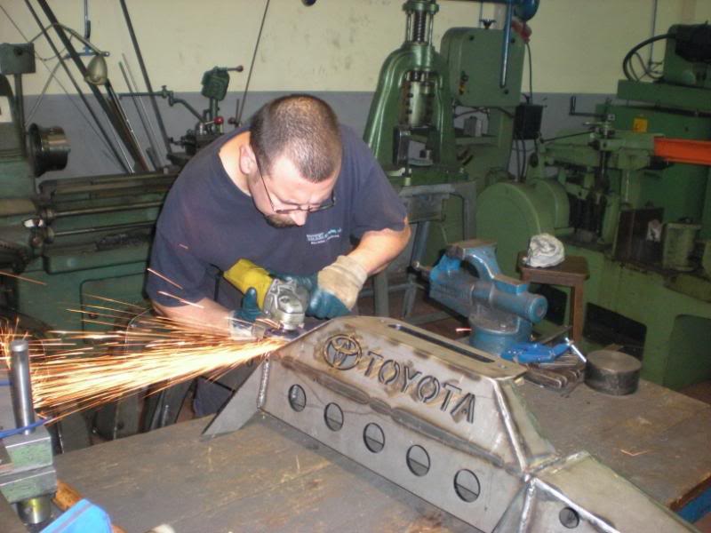

Here was, where I got to support my buddy with something more than ideas. So, lets start to weld.
My brother Willy came to give us some advices (he is an expert welder).
On date and at the exact hour I was prepared to start my adventure.
I spent the previous night, watching weld tutorial videos. This was like watching porn movies, without having any real sex experience yet... ;-)

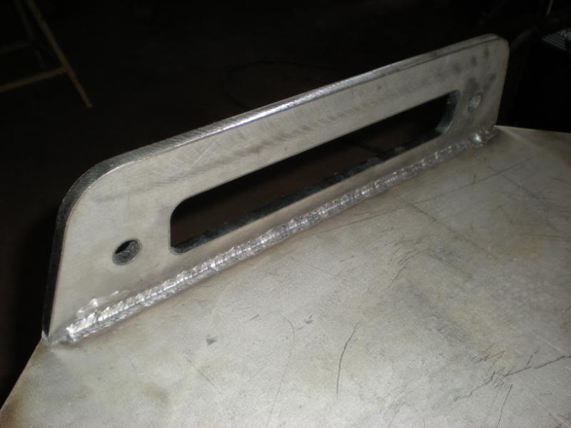

After first indications, my brother gave to me some pieces of metal to feel the welder.
Seems to be that they liked the welds, cause they directly gave me part of the bumper to weld.
So after that, I was officially baptized as the welder of the team ;-)
Attachment 181703
Professional welders, please donīt puke !!! Hope they are not so bad for a newbee ...
Attachment 181704

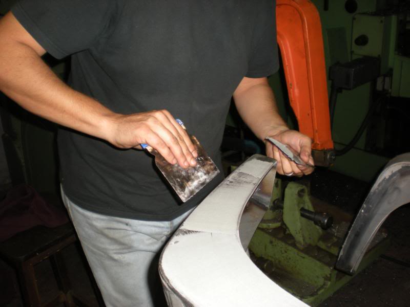

Some pieces were pre-curved before positioning them, as for example the corner plates of the bumper.
Cesc, fabbed a stamp for those pieces. (He is a proffesional matrixer ).
Attachment 181707
Attachment 181708

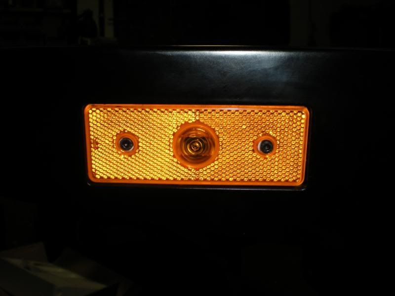

Detail of the corner light support.
Attachment 181717

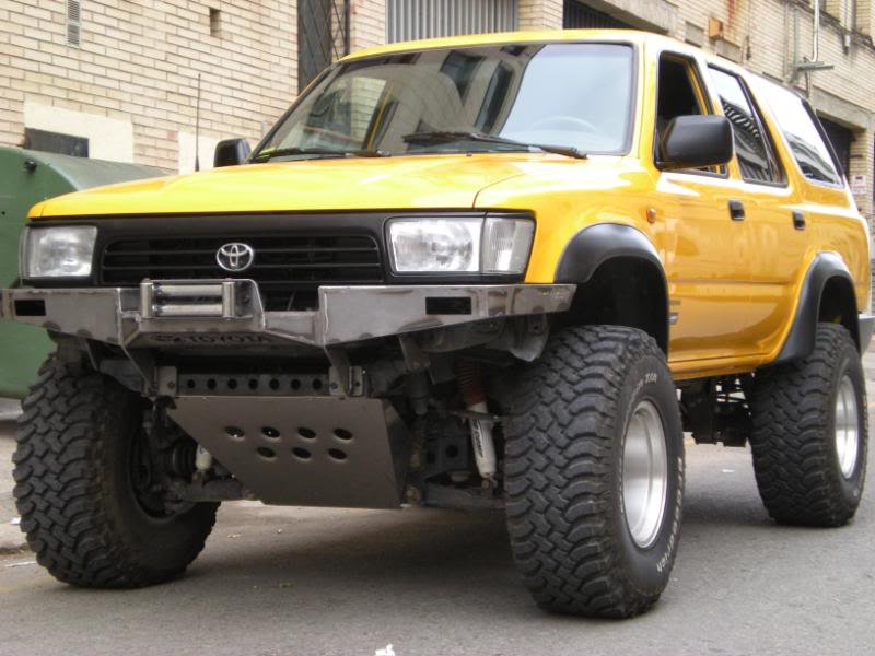

We decided to do some mods, during the fabrication. We put this piece of perforated metal sheet to hide the radiator and lines...
Attachment 181718

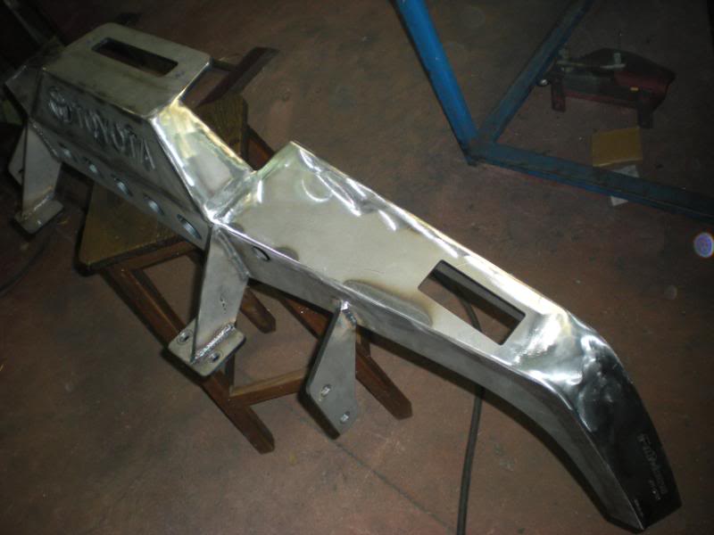

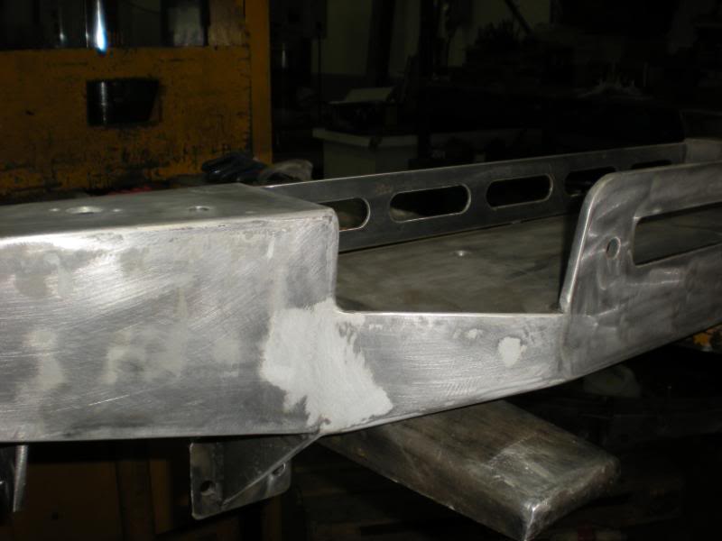

We rounded edges.
Attachment 181727

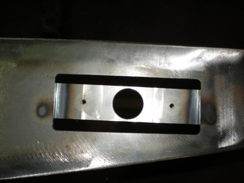

This is a detailed picture of the holes we made, to fit a cut-off for the positive of the winch.
Attachment 181728
After we polished all the details on the metal, we applied epoxy putty with little alloy fragments in it, to correct imperfections.
Attachment 181729
Attachment 181730
After, I learned that I donīt have to apply so much putty on the bumper... Gosh Damn it !!! This putty became so hard !!!! Hahahahahahahaha !!!!
Attachment 181731
Attachment 181732

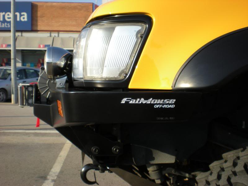

After we got the bumpers from the painter, we mounted the winch to the bumper, corner lights and cut-off.
We turned the solenoid box 180š, to let the winch plugg free (we thought the connector was on top of the box, but model was changed) not a big problem at all.
Attachment 181735
Attachment 181736
Attachment 181737
Detail of the corner light mount.
Attachment 181738

Before fitting the bumper, we cut part of the inner plastic fenders, and trimmed the metal sheet under the lights.
Attachment 181740

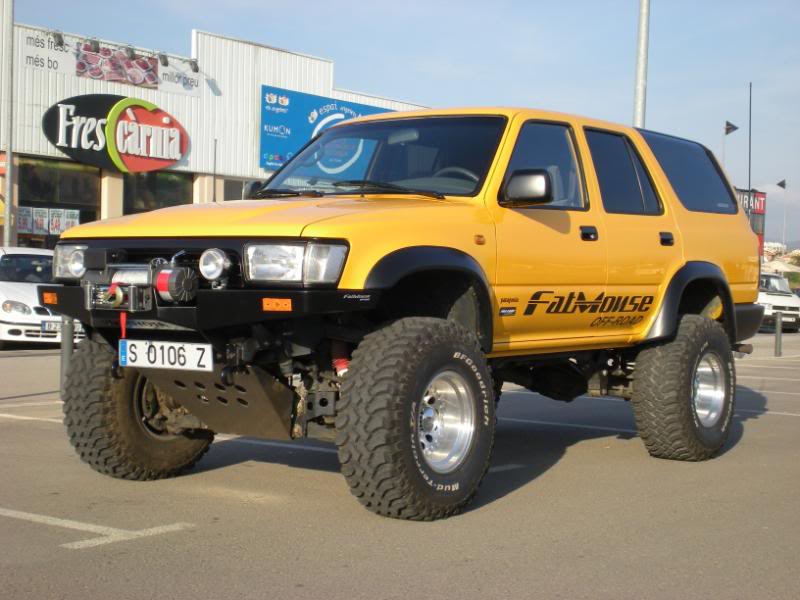

And this is the final result !!!
Attachment 181741
Attachment 181742
Attachment 181743
Attachment 181744
Attachment 181745
Attachment 181746
Attachment 181747
Attachment 181748

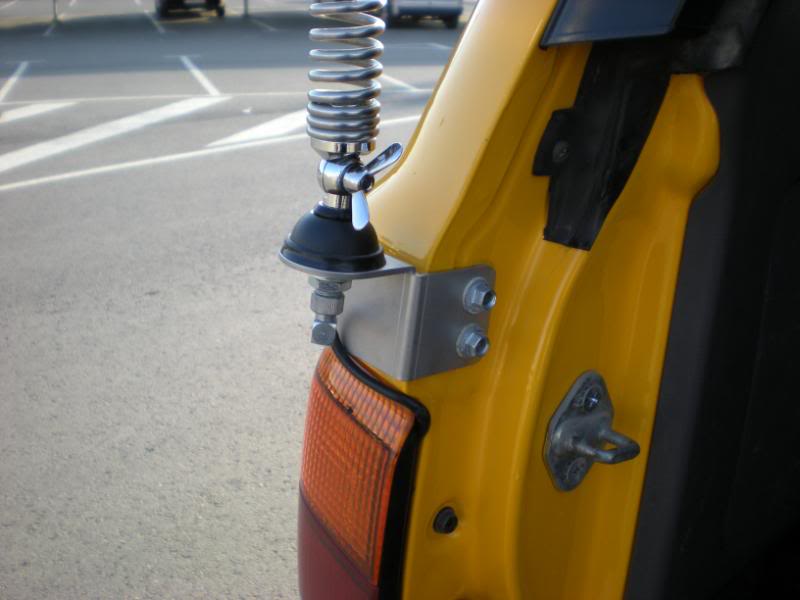

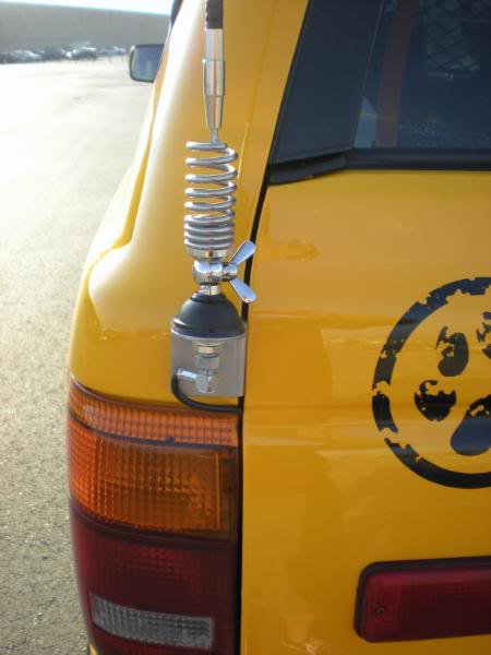

We also fabbed a new cb antenna mount.
Attachment 181749
Attachment 181750

The Toyota logo and name might get you into some legal issues if you market those.
Normal eye wear is no substitute for safety glasses when grinding. :hillbill:
:guitar:
We made those bumpers just for fun for us, of course if we made others we donīt use toyota logo...
Thatīs what I always say. Use safty gear always !!! In fact I use protective eye wear, just to hang around my buddies garage, hahahahaha (no kidding).

what program did you use??
I know some machine shops so i could get the parts cnced
Rhinoceros if Iīm not wrong ...

Originally Posted by aviator (Post 50923694)
I think that mouse is a little too fat IMO Corey. I think something standing up on two legs might look better... sort of a mouse version of Remy's brother from Ratatouie [sp] or else a fat Jerry mouse...
but I'd take a small rectangular sticker in black with the pearl gray script and put it some place on my truck...
maybe jimmy dean can come up with something?
Send me a PM with your adress and I send you the stickers if you want to.:banger:
