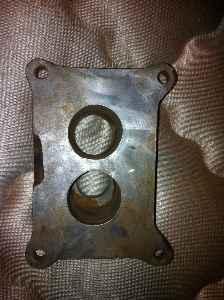

Okay well I got started on this earlier and I'm finished with it. I do not know if it will work as I've never done this. I can build anything but making it work is different.
First step was I used the aisin mounting gasket as a template then I traced it into a peice of 1/2" steel.
Second step was to do the same only using the motor craft mounting gasket.
I then combined them together using 1/8" steel tubing.
This is what I have. Only tools I used was grinder, welder, plasma cutter, and drill. Completely finished In less then 2 hours.
I just painted it so I have not installed it to see if it works. That may come another day idk yet.

Well I drove it today for the first time with the ford carb and it does great. No flooding out, spitting or anything. Although I did notice something really strange. My carb and intake spacer is freezing up. It never hurt anything or caused any problems but it sure does look strange. Here's a pic
All that white is ice. It's not cold out either so I'm kinda unsure why its doing it.

The reason your adapter is icing up is because the stock rubber insulator prevents the adapter from getting heat from the engine. This combined with air moving through it a a very high speed is causing the humidity in the air to freeze to it lol. Its frozen condensation like a cold beer bottle on a hot day.
