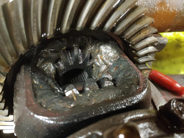

rattlewagon Aug 3, 2021 03:47 AM
1 Attachment(s)
Its usually the bearings (pinion) that go when welding up stock 3rds, not the welded part, unless they are welded incorrectly. Lunch box lockers just dont hold up long term, too many moving parts. where as that welded carrier is practically good for ever. You could argue that welding a diff (gears to the carrier) and putting in new bearings is "doing it right.", and I bet it would last longer than any lunch box locker, for off road.
"beater with a heater" remember.. Weld it up, take the money you didn't waste on a locker and take your spouse out to dinner.
Attachment 206777
Btw, this welded diff is about 8 years old and has been in 3 rigs...
