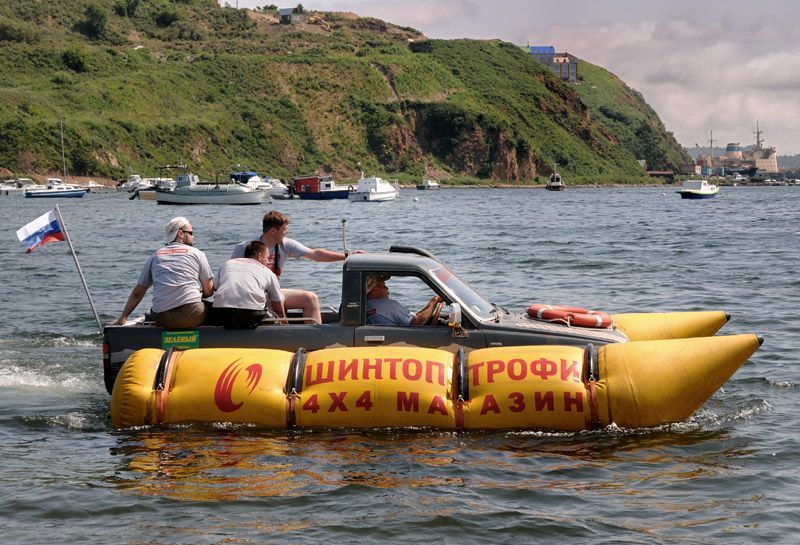

Check out this inspiration of mine with an 85 hilux over on English Russia: http://englishrussia.com/2009/08/14/...uck-goes-boat/
https://cimg7.ibsrv.net/gimg/www.yot...3555d65d73.jpg
Judging from the image, it's very amphibious and does it's new job quite well, although it doesn't seem to go too too fast.

1) My calculations imply that a road vehicle (this one especially) has virtually no lateral stability in the water. Therefore, I am going to have to either make the truck sink (much) further in the water (by adding weight) , or I am going to have to widen it's beam. (by adding pontoons.)
2) All previous alternators that I've discovered do not work in water, depressingly even the water-cooled one that was so promising. Therefore, I am going to have to take a different route. I have found a completely sealed magneto from an old tractor, and have even gone so far as to consider hooking it up to the truck as a form of backup system so the engine will still function if the alternator and battery fail, however if this happens; no radio and no lights.
I feel almost fraudulous for considering the so stupidly simple idea of using pontoons, but the more I research, the more they are the most obvious best choice. So I am heading the route of making sort of a Chitty-Chitty-Bang-Bang type of device, which will incorporate an onboard air compressor for automatic inflation. I will write and update on the propulsion system after dinner, and hopefully soon get a pic of my brand new tailgate (!!) on here, which I will do a skit for reinforcing and modification.
