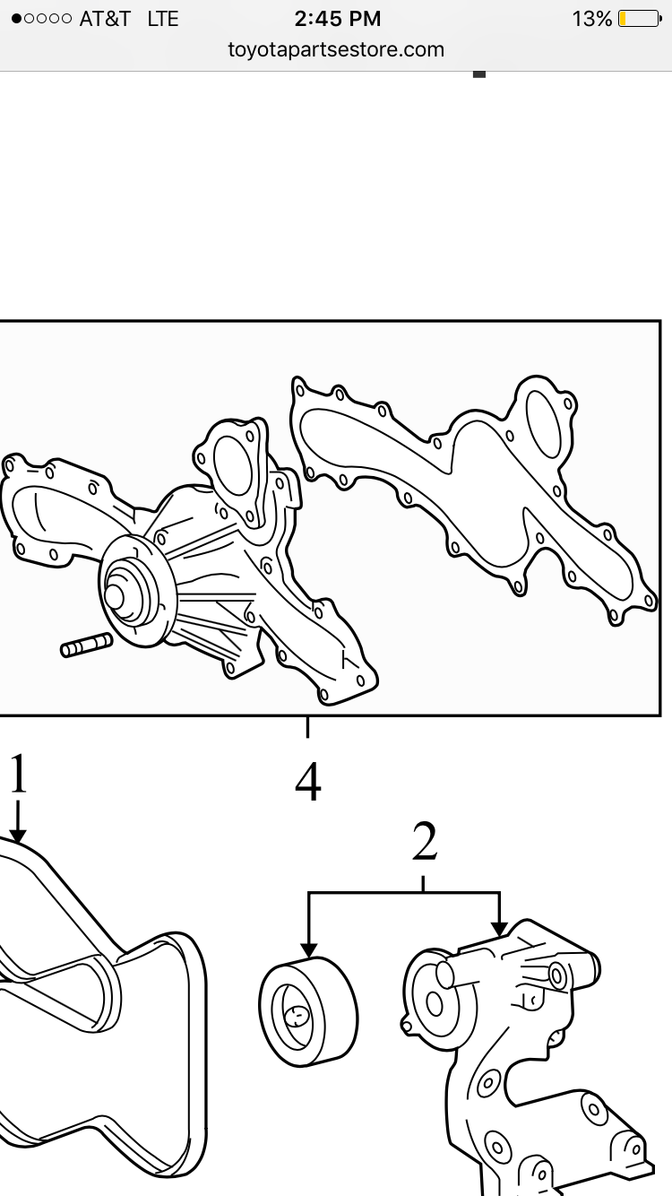

I was was looking at the water pump diagram and the gasket for it looks like it seals 2 areas.
Windering now if the top part of the water pump gasket seals in oil.
Heres a picture.
The gasket is one big round gasket but then a smaller seal within it.

There is a themostat on the lower hose that block coolant flow until the engine is hot. When filling the cooling system, the top hose is the only way for coolant to flow into the engine regardless. If the cooler didd't do it then I'm willing to bet you have a cracked head or block.
