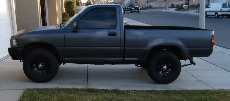

Robert m Jan 6, 2016 11:10 PM
1 Attachment(s)
I would do the low pros. Every bit of extra suspension travel you can get, will be worth it.
What are your plans for shocks?
This is what mine looked like with the 235s and the above suspension setup and the addition of downey lift shackles
Attachment 116468
mistershmi Jan 7, 2016 06:23 AM
https://img.photobucket.com/albums/v...up/pickup7.jpg
I put Bilstein 4600 series shocks on there. They've been great so far. Do I need to add shackles as well as the add a leaf? If looks like AAL gave me plenty of space . I always liked your 2WD . Nice pickup!
