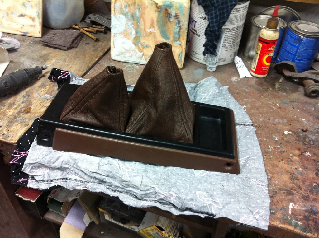

little more today ..
got the new matched shift boots done .. steering wheel , console lid , and now shift boots ....

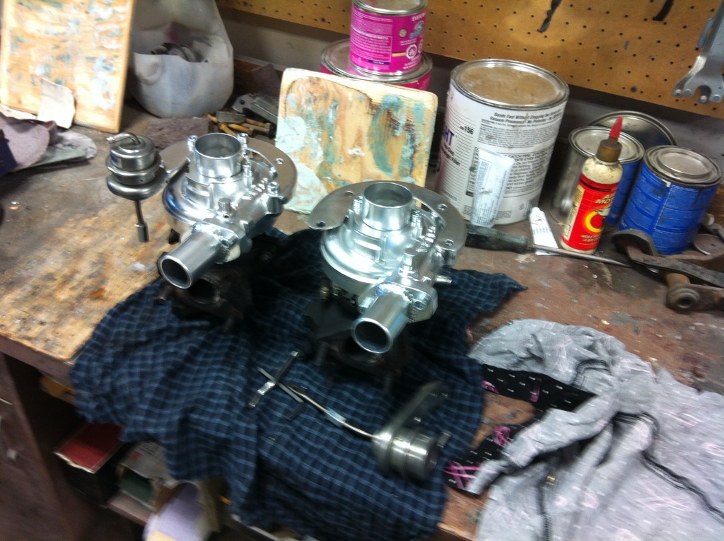

turbos are just about ready for some boost

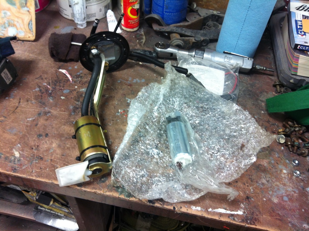

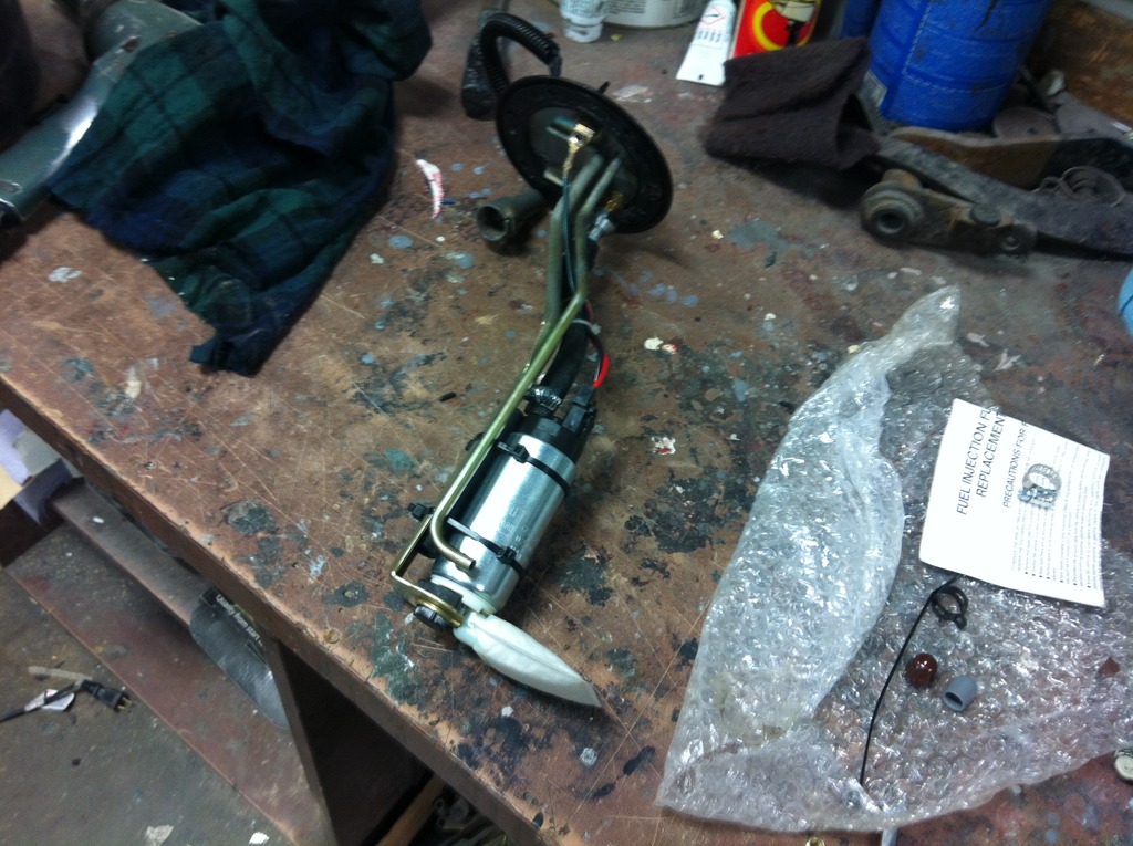

With the added air volume , and now the larger injectors , I needed a larger fuel supply , so I added a new walbro 255LPH pump today .. original walbro , not a cheep china knock off !!!!
out with the OE original pump ,

and in with the new hi volume pump

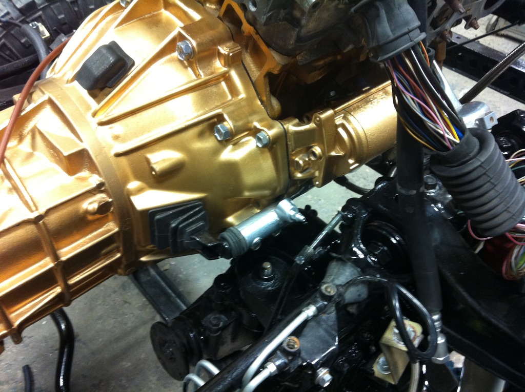

so with the cab off .. I decided to do another coat of POR15 .. so I sanded the surface , and brushed on another layer .
all dried , I got the engine in place and clutch installed
and tranny fully installed .

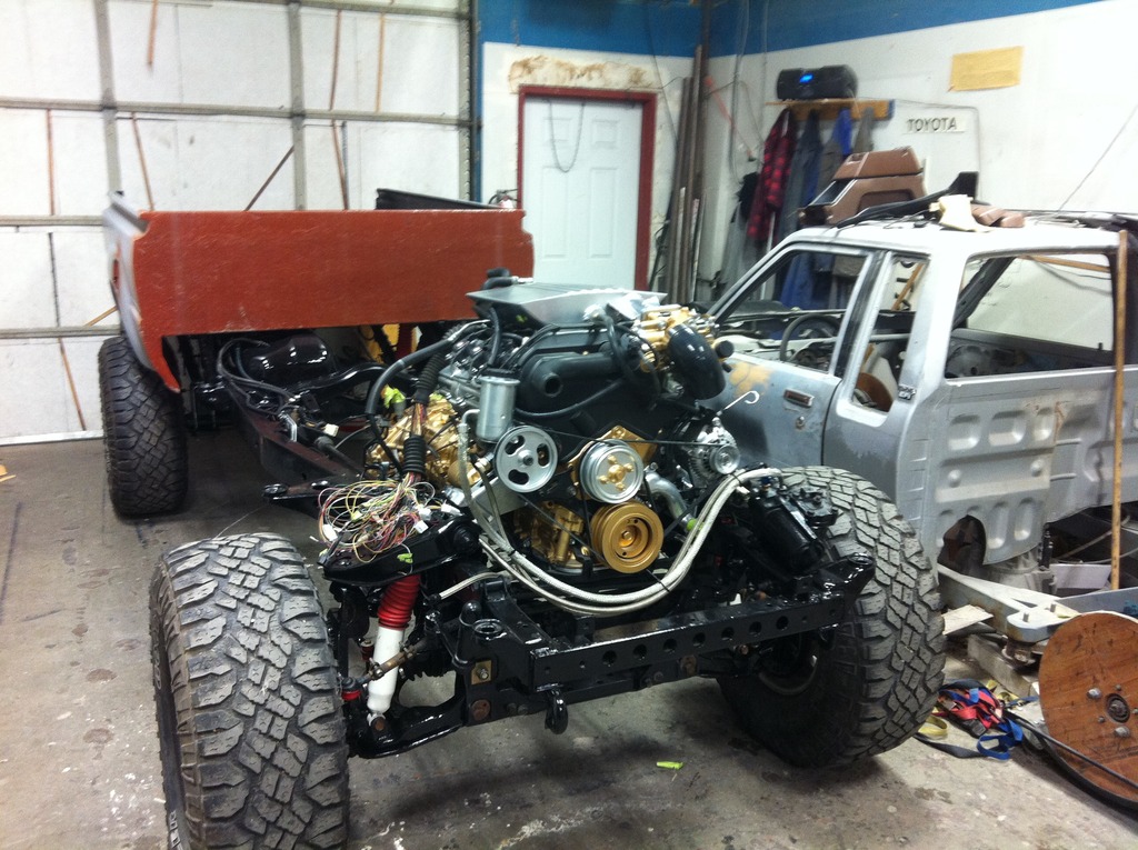

ready for the cab
should be done in a week or so ...
