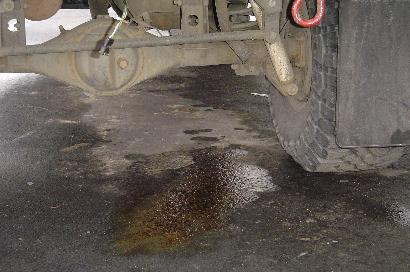

So today i am mounting my back up lamps when I glance down at the ground under the passenger rear of my axle. I see a 12x7" diameter puddle of goldish fluid. I ofcourse touch it and feel it and sniff it. Looks, feels, and smells like brake fluid. My brake fluid is down but I see NO leak anywhere. Its very dry under the rig right now. I am wondering if I have a brake cylinder going out in the passenger rear drum. I would think that it could leak and dry pretty fast coming off the rubber tire but once on the ground it would puddle up. Very odd though.
Attached Thumbnails Wierd leak under my rig, couldnt be my rig though-leaking.jpg

i think that you would see a "water" mark on the tire if it was coming from there. is it your proportion valve at the bottom of the rig. Look for a shinny or cleaner spot. Just keep looking it is coming from somewhere. Or dose someone ells park there ever. Look and see if you can tell if it a recurring stain on the concrete. good luck

Maybe it's dog urine. That is a LOT of brake fluid to be leaking out to be down a little.

Stick a piece of cardboard under it and let it sit and see what happens.

As someone else said that looks like a lot of fluid. I would think your master cylinder would be empty. Maybe get someone to stand on the brake pedal to put some pressure in the system and look to see if anything is leaking out.

I would pour some water on it to see if it mixes. If it mixes you know it ain't oil based and is possibly not brake fluid. If beads form then it is oil based. Because I'm a pyro I would throw a match at it and see if it lights up.

My brake pressure is fine today. the level is barely low. im thinking some punk parked in the spot I stole and leaked on it. damn punks

i have the same problem the seal was shot on the proportion valve i thought i was leaking fluid out of the brake cylinder also and i thought my shocks where bad too because it was leaking on them ahhhh!
pretty dumb i know i ordered shocks and a brake cylinder like a jackass and found out it was niether but it was the proportioning valve i went to a toyota parts dealer and picked up a used one and it was clean externally but internally what a nightmare (water damage) so know we believe its clogged with rust and is not getting fluid through.. i think? god what a pain in the ass this is...
