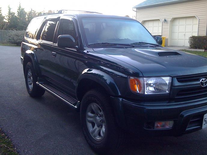

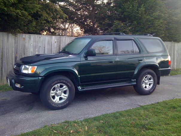

forgot the pics
here ya go
Attached Thumbnails Tune up parts ??-img_0559.jpg   Tune up parts ??-img_0561.jpg
