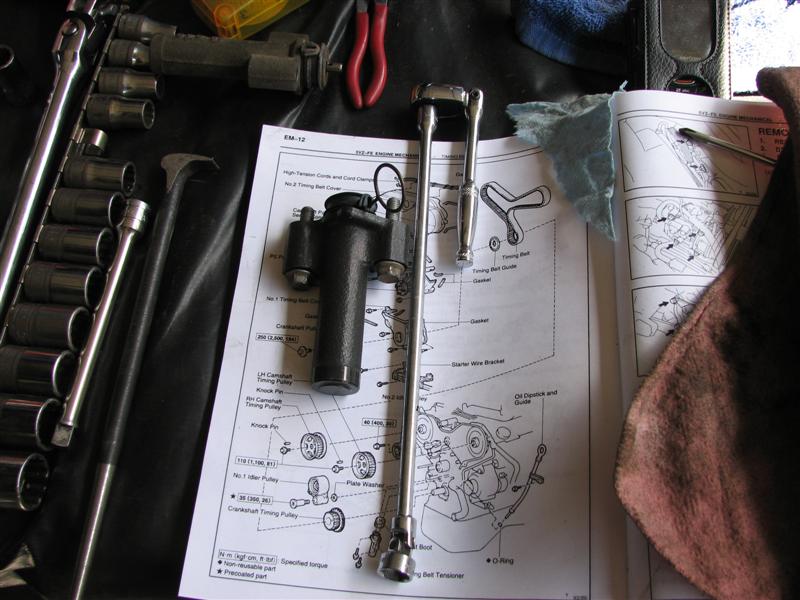

And, if you have one of these setups ( 1/4" ratchet, long extension and wobble socket ) you won't need to touch the a/c bracket. I got my tensioner changed out just fine.

kball, thanks for the info on the 1/4" ratchet/swivel to get to those tensioner bolts. Someday I'll add 1/4" tools to my box.
