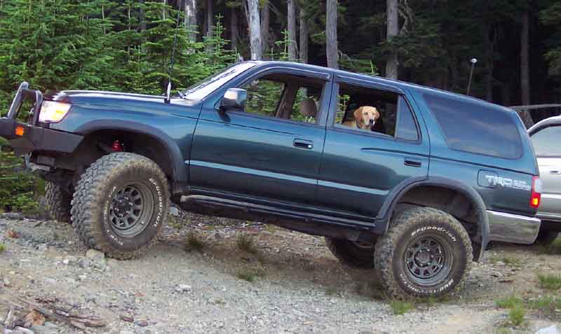

I hear you. I wrangled with it for the longest time, but went with OME's and SAWs. SAWs are about the only way to go for the front, specifically if you think you might throw an ARB or TJM bumper on the front. My rig went from stock to this in the last 6 months:

Which OME setup did you run in the rear? You're still rubbing? Where at?

OME 891 HD springs, comfort shocks. Rubbing in front when wheels are turned on inner wheel well. Rubbing in back when offoroading on both rear mudflaps and opposite side piece of trim. The panhard bracket is supposed to alleviate some of that, just haven't had a chance to get it welded on yet.

I have a TJM in the front. I have a cargo box in the rear with a bunch of gear. The extra weight helps to smooth out the ride a bit. I would consider it to be overall stiffer than the stock ride. However, I like being able to load up the back without any sagging whatsoever.

Well, I never measured it completely empty, but with the stiffer springs, and assuming no sag, I was right at 3" inches of lift in the rear.
