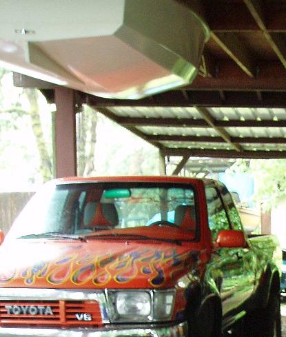

I have a 4 point block and tackle type of lift in my carport ceiling - I actually use it to store a boat up there. But I've used it to take off canopies and things like that. Handy. 4 lift points run to 2 blocks then to one block and only one rope to pull - all in all 8 to 1 ratio. Easy.
Attached Thumbnails simple 1st gen 4runner Q- are the hardtops metal or fiberglass?-lift.jpg
