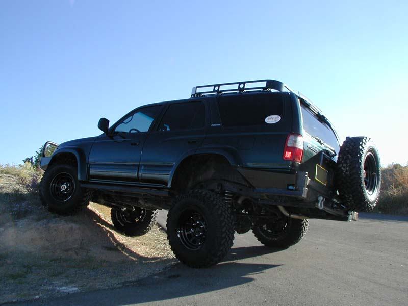

I would agree about the bumper bit. I purchased the Quick Discos from them, and I can tell you (as well as many other people) they are crap. I have broken 4 Heim joints just on the street. I called them up and asked for replacements. They stated they would send them out, but I never received them. Figured it wasn't worth my time. I did purchase the hinge from them, however I don't think they make the hinge. I used the hinge in my rear bumper, and it was been working great. Even with the tire holding a great deal of the vehicle weight (transfered to the hinge) it did very well in Las Cruces.
http://www.Hunt4Steve.com/99_4Runner_Buildup.htm

Hi Steve, I'd just like to butt in here for a second
I now reconize your rig after posted the "huntforsteve" link.
I have been on your site before checking out all of your mods.
Several of us in the past were checking out your rig and mods you have done to it.
Very nice.

I have been working on it for some time. I have not had a chance to update the website with the lastest fixes, such as the ARB, 4.88 Yukon gears, Powertank, etc. However, when I do, I'll let y'all know. I'm trying to get ready for Las Cruces in February. Hopefully, the IFS will handle it. I figure if I can pick the right line, and take it easy, I should do all-right.
