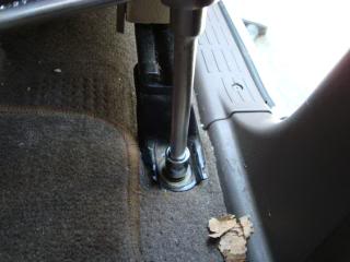

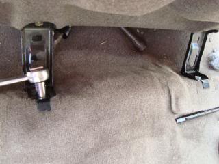

To begin, remove the 4 anchor bolts from the driver’s seat. You will need a 14mm socket and ratchet. A 6" extention is not necessary but desirable. I recommend that you manually slide the seat all the way back to access the front anchor bolts first.
Attachment 185787 Attachment 185788
Slide the seat fully forward to access the rear anchor bolts. Start with the inboard bolt then the outboard.
Attachment 185789 Attachment 185790

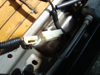

Tilt the seat slightly rearward to expose the seat belt connector.
Attachment 185791
Squeeze the connector at the end to release the connector from the seat.

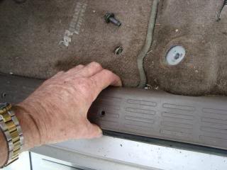

Remove the front door scuff plates. There are (4) Phillip’s head screws in each scuff plate.
Drivers side
Attachment 185799
Passenger side
Attachment 185800
Each scuff plate has am indentation about the middle of the plate towards the inside. Slip your fingers under this cutout and move along the edge lifting as you go. The plate should ‘pop’ loose. Grasp it firmly and pull upward clear of the door edge.

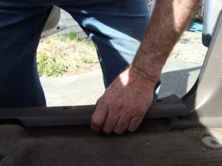

Remove the rear passenger door scuff plates. They are held in place with (2) Phillips head screws. Grasp the base of the plate and lift upward. Try to start near one end or the other. Be careful not to twist these too much as you can break the tabs at the base that hold the plate in position.
Attachment 185803

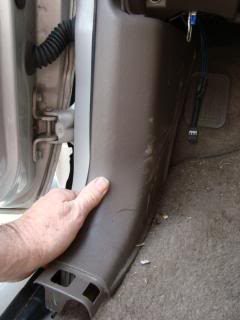

Remove the ‘B’ pillar covers. Grasp the edge near the top of the cover and pull it away from the pillar. There are (3) white plastic pins that hold it in place.
Attachment 185806 Attachment 185807

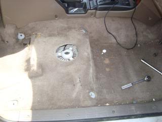

Begin to remove the carpet along the door edges by squeezing the white plastic clips then rotate them up and inward which will free them from the floor. Begin near the front edge of the driver’s door working your way to the rear driver’s side passenger door. Perform these same functions on the passenger side.
Attachment 185810 Attachment 185811
Pull the carpet in the rear driver’s side up and forward exposing the rear bench seat support.
Attachment 185812

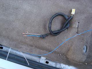

Pull the carpet clear of the driver’s side door area so as to expose the pigtail for the driver’s seat. This is a two wire connector. They are WHITE/RED (+) and WHITE/BLACK(-). Remove the electrical tape from the pigtail to expose these two wires. They will be the only two wires in the Driver’s seat pigtail/connector.
Attachment 185813
These two wires will be spliced into the new pigtail/connector for our powered seats. The only difference will be the new pigtail connector will have a third wire which will supply power to our driver’s seat.
We will splice the new connector in using a stagger method so that the splice crimps will not be too large when we tape up our new pigtail. Next thing we need to do is provide a power source for the seat. In the powered seat 4runners from the factory they use what is called a “bridge connector”. What this is, is a special connector that has power/grounds at the connector but power is then “bridged” between several wires through this bridge connector. This connector is J12. J12 is located under the rear bench seat bottom on the driver’s side. There is a metal “box” area near the front corner of this bench seat bottom and you will find a translucent plastic hanger tucked inside this “box”

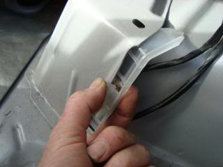

Using your fingers, lift one edge of the clip and begin to pull the hanger from its location. It is a bit long and runs along the entire length of this “box”.
Attachment 185815

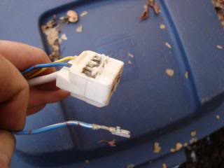

In the power seat versions there are three blue wires in J12 which would be the 3 wires on the right side, bottom row (+) and three white wires on the left side, bottom row (-). In the SR5 version without power seats the right most location is empty. What I did was using a scrap wire harness, I salvaged a blue wire with a box type connector.
Attachment 185817 Attachment 185818
Insure the wire you salvage is long enough to reach the driver’s seat. If it isn‘t, you'll have to splice in another piece of wire. Before you attempt to insert the new box connector and wire, you will need to "unlock" the connector. J12 is black and the connector lock is white. Using a small/jeweler's screw driver, gently lift the connector lock up slightly so that you can insert the new box/female connector. Now gently insert the box connector with wire into the empty third location in J12.
Attachment 185819
I should point out that there is dielectric grease in this connector. It’s pretty hard to screw this part up as the box connector will only go in one way. Do not force it. If it doesn’t want to just slide in then flip it over and try again. If the connector still doesn't want to slide in check the connector lock so make sure it is still up high enough to insert the new connector. Be sure to look at the other connectors. You should be able to see which way to orient the female box connector before pushing it into position. Once the connector is inserted press the connector lock down and ensure it is flush.

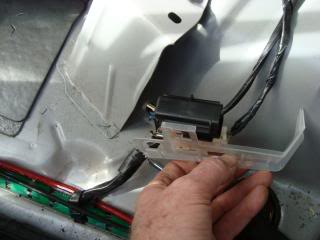

We left off installing the new power wire into J12
Attachment 185820
Now that is complete, you can check to see if you have 12vdc by measuring the end of the wire to ground using a multimeter. You should read somewhere around 12.4 or higher. Next using some electrical tape, wrap the group of wires that now include three blue wires (+) and the 2-3 white/black wires (-) so you have a clean bundle coming from the connector that plugs into J12.
Attachment 185821

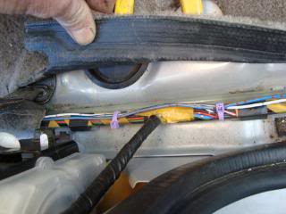

Begin routing the new seat power wire back along the wire path that runs along the edges of the doors.
Attachment 185822
If you have any problems getting the wire through one of the cable run grommets, if you squeeze it near the top then pull the lower edge away from the clip it should pop open, then just lay your new power wire in the cable run and then snap the clip back together.
Attachment 185823
If you get them through all the clips and hold downs you should not have to wrap the new wires with electrical tape unless you would feel better about it. You can even use some small wire ties like this. I had to do this on the passenger side which is where this pic is from.

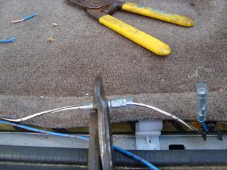

Route the new power wire until it is near the old seat belt warning wire. If you need to remove more of the tape to fully get at the old pigtail then do so now. Make the turn with the new power wire and give yourself about 4-6” of extra then cut the power wire. Remove the old pigtail by cutting the white/red and white/blue wires but be sure to leave a bit of extra so you have plenty to work with. On the new pigtail.
I staggered the blue wire about 4 inches from the two white wires for the seat belt warning. Over lay the new pigtail so you can see where you need to cut your wires so the splices will not be next to each other. Makes it easier to fit the splices inside the split loom of the new pigtail.
Attachment 185825
Strip the ends and prepare to attach the splices.
Attachment 185826
Crimp the spices and you are ready to tape up the new pigtail/connector
Attachment 185827

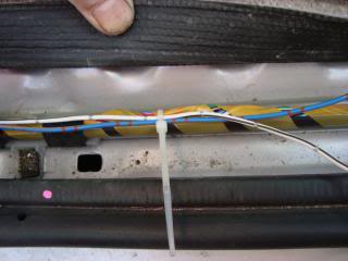

Tape up the new pigtail all the way to the floor cable run. As you are using the original seat belt warning wires from the harness you will need do nothing further to the drivers seat cabling. Install the new power driver’s seat and lift slightly to access the seat connector. Snap in the connector to our new power pigtail.
Attachment 185828

In order to get unswitched power for our passenger seat we will once again access the J12 bridge connector. We used the empty location for our driver’s seat, but the pins go through the J12 connector and are in fact double pin. If you look into the opposite side of J12 where it has the other wires coming into it, there are pins coming out of the back side of the connector. If you remember when we installed the new power wire for our driver’s seat we removed the connector from J12 mounting connector by squeezing down the tab and pulling the connector out of the mounting connector.
Attachment 185829

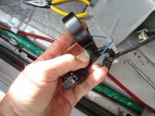

The J12 mounting connector has double sided male pins inside of it. When you mate J12 connector with the mounting connector you now have all the pins available for installing another connector. As I did not have one, I decided to use the same box connectors and just attach them directly to the available pins.

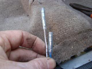

As I did with the driver’s side power wire, I scavenged two more wires with box type connectors.
Attachment 185830
Take each connector and using small needle nose pliers, bend down the two side flanges so they are flush with the box of the connector.
Attachment 185831 Attachment 185832
Cut two pieces of shrink tubing that will just fit over the connector approximately 1 & ½” long.
Attachment 185833
Heat the shrink wrap so it forms a nice clean fitting insulation around the pin. Place the shrink tube so it is just flush with the end.
Attachment 185834

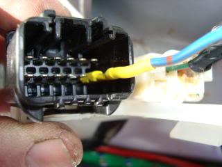

:readit:WARNING!
If you happen to touch one of the power pins to one of the ground pins you WILL blow the 30 amp fuse that supplies J12. That fuse is located under the dash on the driver’s side top of the fuse box and is pink in color.
Look closely at the J12 connector and note the location of the blue power wires. You can verify power available with a multimeter and should read 12vdc+. Remember the warning above. You will want to install the wire onto one of these power pins. I chose the one at the far right bottom row. Slide the box connector over that pin. It should fit snuggly.
Attachment 185835

Pull the slack out of the wires and then continue over to the right side cable run. Begin to route the wires forward towards the location of the front passenger seat.
Attachment 185842
Route the wires along the cable run and secure it with small ty-wraps

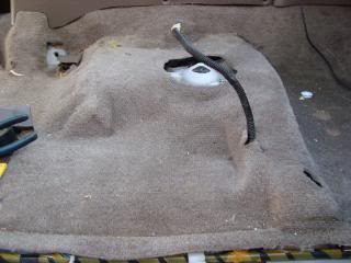

Once you reach the center area of the front passenger seat you can make your preparations to attach the passenger seat pigtail/connector.
Attachment 185844
Route the pigtail/connector through the cut slit in the carpet (already there) so you have the end of the pigtail near the wire ends.
Attachment 185845

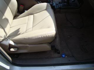

Install the seat. Tip it slightly backward exposing the connector and plug in our newly installed pigtail/connector.
Attachment 185855.
Install the anchor bolts and with power available you should be able to move the seat on its rails to secure it.
