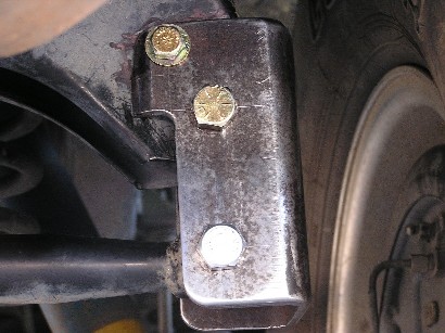

I fabbed a bracket simular to yours on my 3rd gen, but mine extends further up the original bracket. I used a top bolt above the lower bracket to bracket bolt and steel sleeves/ bushings in between the old bracket where the bolts go through. No welding or extra suports needed. So far it has held nicely on and off road.

Here is a pic. during the install.
