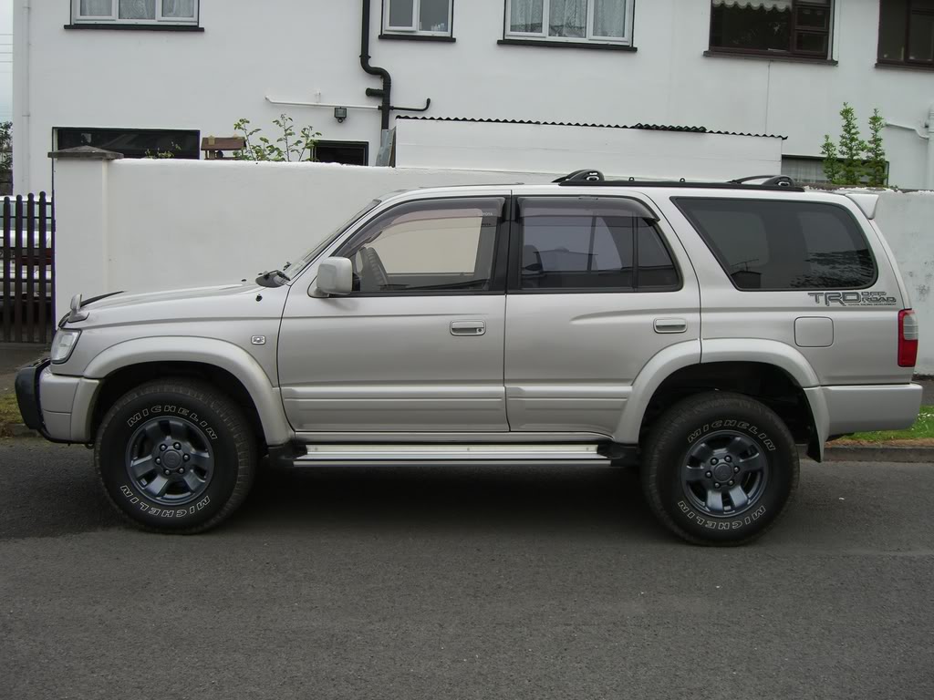

Ghetto huh?? Hows this for Ghetto?? Here ya go man. That paint really is awesome and its held up for over a year on my wheels. I highly recommend it and if it gets scratched you can just touch it up.
Theres a video on the duplicolor website that shows you just how to apply it. I followed it just like they said. Good luck and post pics if you decide to do it.
I've honestly gotten more compliments on my wheel paint mod than any other on my truck. Go for it!

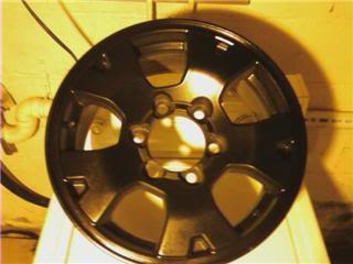

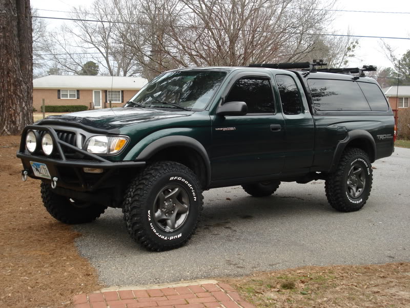

I used the same paint on my Tacoma wheels. My are finally starting to chip a bit after about a year, but my runner has seen its fair share of offroading in that year, and I only have about $20 in this project. I still have some paint and clear left to touch them up.
Did pretty much the same steps as everyone above except I didn't use a primer. Maybe thats why mine are chipping but my wheels were only about a year old so i really didn't feel the need.
