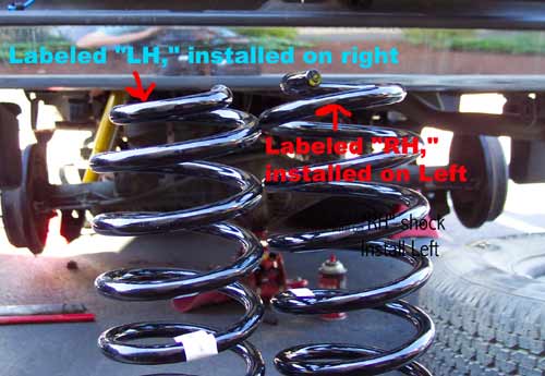

Spraying everything down the night before with lube helped immensely, although getting the rear shocks off was a pain. A strap wrench on the shock body did the trick, but mangled the dust cover on the shock. As other people have experienced, the OME HD springs were mislabled:
Attached Thumbnails OME/SAW Lift Installed, PICS!-coilsmislabeledweb.jpg

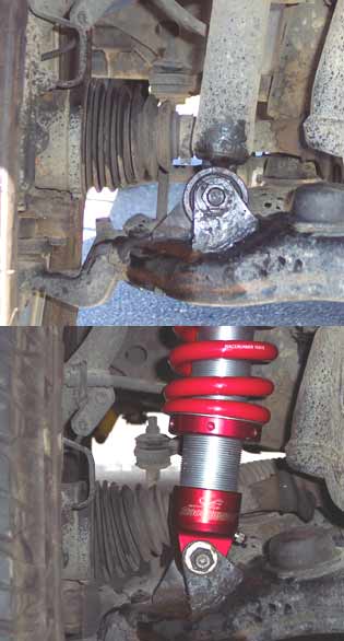

I went with the HD springs and comfort shocks in the back. Up front, tundra-valved coilovers from Sway-away, plus a one inch differential spacer to help reduce the angle on the CV's. This is a picture of the CV's, before and after, with three inches of lift:

Oops, forgot picture:
Attached Thumbnails OME/SAW Lift Installed, PICS!-cvbeforeafterliftweb.jpg

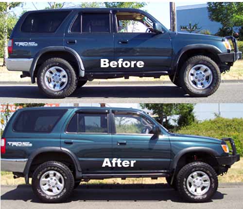

Finally, here is the before and after picture of the front, with 3 inches of lift front and rear. The real noticeable difference is in the wheel well. A test drive shows that the SAWS really soak up bumps, and the truck give a much more secure ride than before, hard to explain, but it just feels more "solid." The valves on the SAWS were installed pointing inward to avoid the brake caliper breaking it off. Now my tires look way too small....
Attached Thumbnails OME/SAW Lift Installed, PICS!-liftcompilationweb.jpg

wow what a difference...very nice.

man, you rig is looking very nice! nice job!

Yeah, you're right, the tires do look small!
Nice work!

The diff drop was maybe a 10 minute job, FYI. You know what I was wondering- why don't they make 3 inch diff spacers to completely return the CV's back to stock angles?

Looks great there David
For some reason your rig looks alot cleaner with the new lift

I didn't think anyone would notice, but it did happen to get a bath before taking the "after" picture

About the diff drop, I don't think I could have gotten much more of a spacer in there on mine. There's not enough room without changing/moving alot of other stuff. If you have the time and energy to do some surfing, look at the 4 inch and 6 inch Tacoma lift lift kits made by Pro-comp, Fabtech, and Trailmaster. They use a structural memeber to drop the entire diff assembly away from the frame. Interesting stuff if you feel like reading up on it...
I don't think the diff would rotate down that far, not to mention the angle in the driveshaft would be quite drastic. it would also lower the front ground clearance quite a bit, that's why I don't like those lifts that replace the whole front crossbar/suspension assembly and basically drop everything, nothing gained, just looks. maybe I'll do that tonight if it's just ten minutes. you get an alignment yet?
