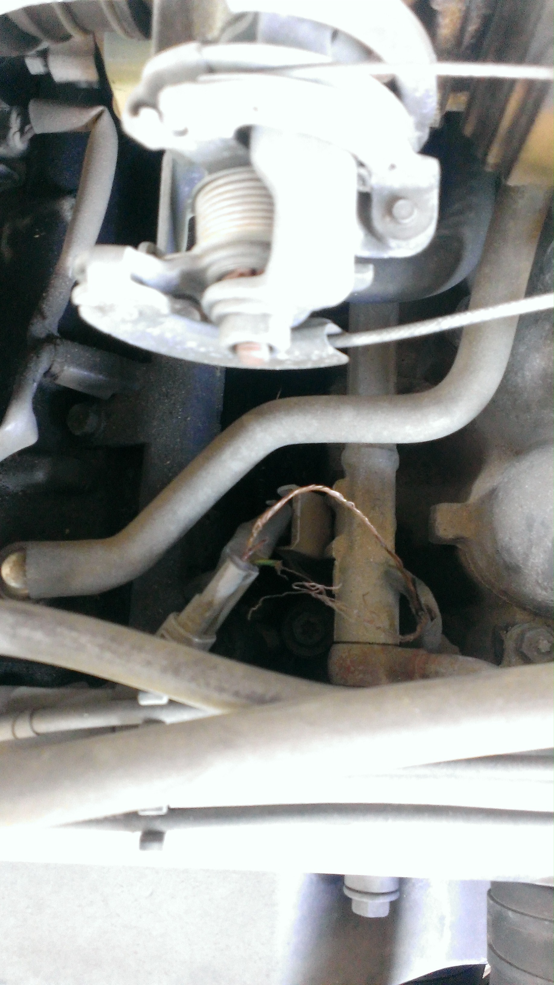

What is that wire going to that is all screwed up in my attachment? That is on top of the engine. I haven't yet purchased a Chilton's and I'd appreciate someone sharing their knowledge here.

Wires- Only two things go down under the front like that. Knock sensor, and a temp sensor. I am assuming no codes? Or is your check engine light bulb even still there? People will take the bulb out when selling the vehicle, and most buyers never even think to check.
Idle and wires are connected I believe. Throwing code for engine coolant temp sensor, and that is definitely where those wires are going. Just need to get to the wrecking yard and find the short bit of wire to replace. It's only about 6 inches long and connects from the sensor to the harness - that's what I have that is shredded.
