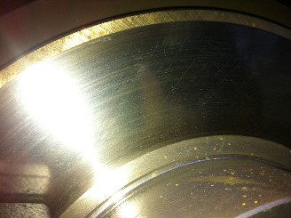

Hey guys, my first post I think! I replaced the front calipers, pads and rotors on my 96 yota 4runner, Sr5 V6 4WD. Everything seems ok except i noticed the outside 1/8" of the rotor didnt seem to be getting contact from the pad. Its the same on both sides. The old and new rotors are the same size. I measured them. Didnt see this wear on the old rotors. Maybe a thin bit, but this is more pronounced.
Is this normal or should I do something about it?
I added a pic of it..

That's normal. Congrats for taking on the project.
