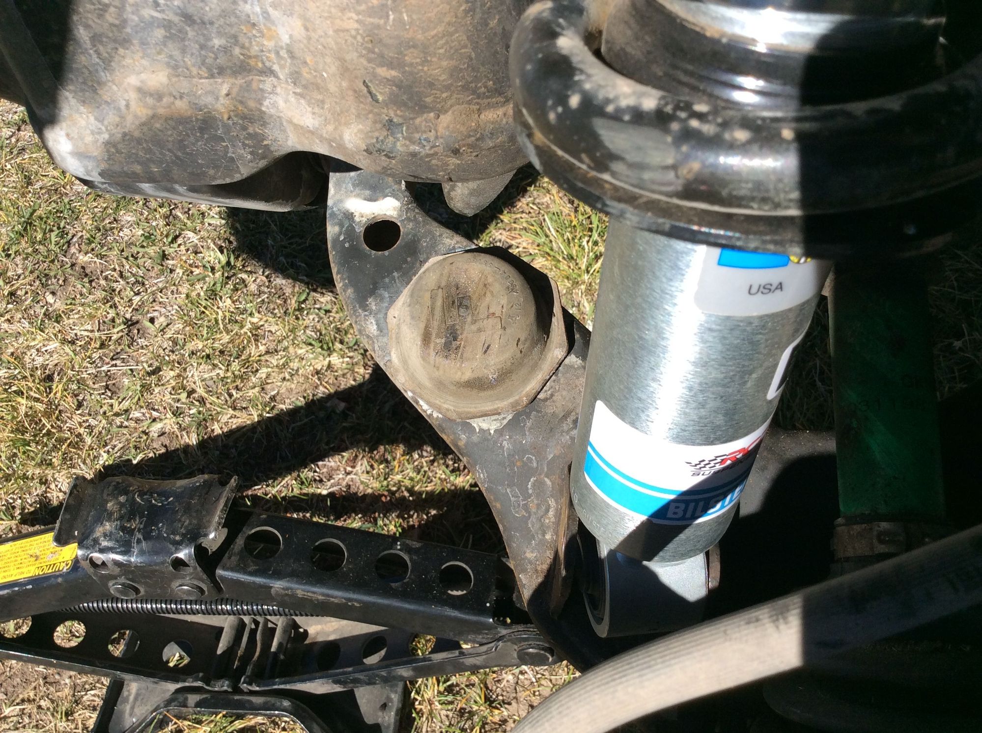

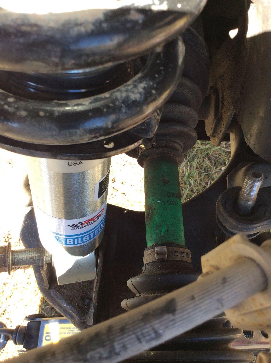

Almost done...and a bit more of a pain than I expected. I've run into this on the driver side. Is this within what's normal, and I just need to work the bolt in there? It absolutely has no wiggle room. It's completely solid in the position it's in. Doesn't seem like it'll straighten out.
The other side when in just fine (more or less), but I'm wondering if the shop who swapped the coils for me got this one off-center? Or do they only go in one way?
I've tried lining the whole assembly up every different way, and this is the only way that is even close to lining up.
Any help?

83 Oct 16, 2015 02:48 PM
Nevermind... :)
If anyone else reads this who is as inexperienced as me: The shock actually spins inside the coil. I took it off the truck completely, then stuck the bottom end in the mount. Once it was in the mount, lined up, I spun the top of the shock till it looked like the three bolts would line up.
Took it back out of the bottom, bolted it into the top, and the bottom slid right in, lined up just right.
Ugh.
wyoming9 Oct 17, 2015 12:34 AM
I was going to tell you to just twist the eye on the shock.
Live and learn
Glad you figured it out.:wrench:
83 Oct 17, 2015 04:57 AM
Yeah, thanks. It wouldn't spin at all from the bottom. Once the upper mount was in, the lower eye wouldn't move a cm. But with the lower mount secured, the top would rotate.
So yeah...now I know.

Now I got the Monroe ones and with the top one nut holding it from falling out I could turn the bottom go figure .
83 Oct 18, 2015 04:58 AM
That makes sense, I think. I couldn't turn the bottom at all with the three top bolts secured into the mount. But once I took those out, it would spin. I'm sure the bottom could move, too. I just had the bottom in the lower mount when I tried turning it, since I was lining up the top bolts.
