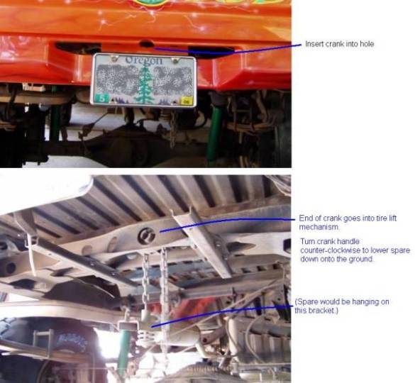

I can't tell you where in your rig to find the handle, but here is an illustration of the principle for you. Your's will look a bit different, but it works the same way. Stick the crank handle in the hole, get it into the winch, crank the spare all the way to the ground.
When putting the tire back be sure the bracket engages with a lug hole so it's secure when you crank it back up. Crank it up tight. That's all there is to it.
I was hunting for an image like that, but to no avail.

http://www.4runners.org/articles/difftsf/
look at the pics in the writeup. you have to stick the rod in at an angle. the pic should help.
I just walked out to the driveway and took the pics. I figured since I don't carry the spare under there it was an easy shot. BigBadBlue shamed me into it...
