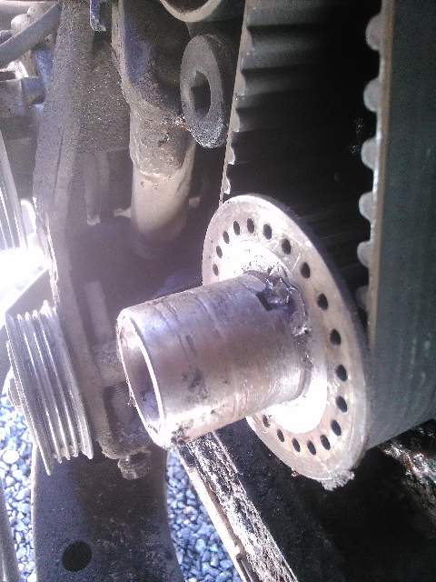

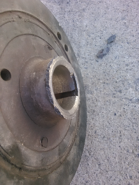

help! 95 Toyota Tacoma v6 3.4l 4wd automatic transmission-forumrunner_20140706_100721.png
help! 95 Toyota Tacoma v6 3.4l 4wd automatic transmission-forumrunner_20140706_100759.png
So here it it, the problem looks bad how can i go about this HELP"!!!!!" Please

Yes, you will need a new HB, IMHO. Also, the timing belt (TB) will need to come off so the crank gear can be pulled so the key can replaced (it's mangled in pic 1).
Might just be a good time to do the TB, etc. if it's getting close to the next change interval.

Not cheap.
http://www.toyotapartsoverstock.com/...340862040.html
For that kind of money, I'd consider a salvage yard.
I think you'll need to carefully examine the key-groove in the crankshaft. It it has been banged up, the key won't fit tightly, and the wobbling of the crankshaft pulley will quickly loosen everything.
Good luck!

Some have purchased the non-OEM HB from RockAuto.com in the past. It's $161 + shipping.
