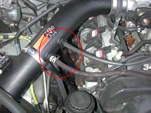

Has anyone installed one or have one on there truck? I just installed mine and had some questions.
When I installed it the instructions said on the 03 you would plug one of the holes on the tube since the engine doesnt have both tubes... however, my engine did have both tubes so I hooked them both up.. Is this correct?
I just took it for a spin and it feels pretty good overall, but from almost a dead stop if I floor it it seems to shift later.. it shifts at like 4500rpm and feels a bit odd (I think?)... I didnt know if it was something relating to the tubes. I took them off one by one and when I took the bigger one off that goes to the right side of the engine it definetley didnt feel good. So I put that one back on and took the smaller one that seems to go to the top of the engine off it felt almost the same, but I might be mistaken?

these 2 tubes right here... the intructions show on the 03 only one of these will be existent, but both were there
