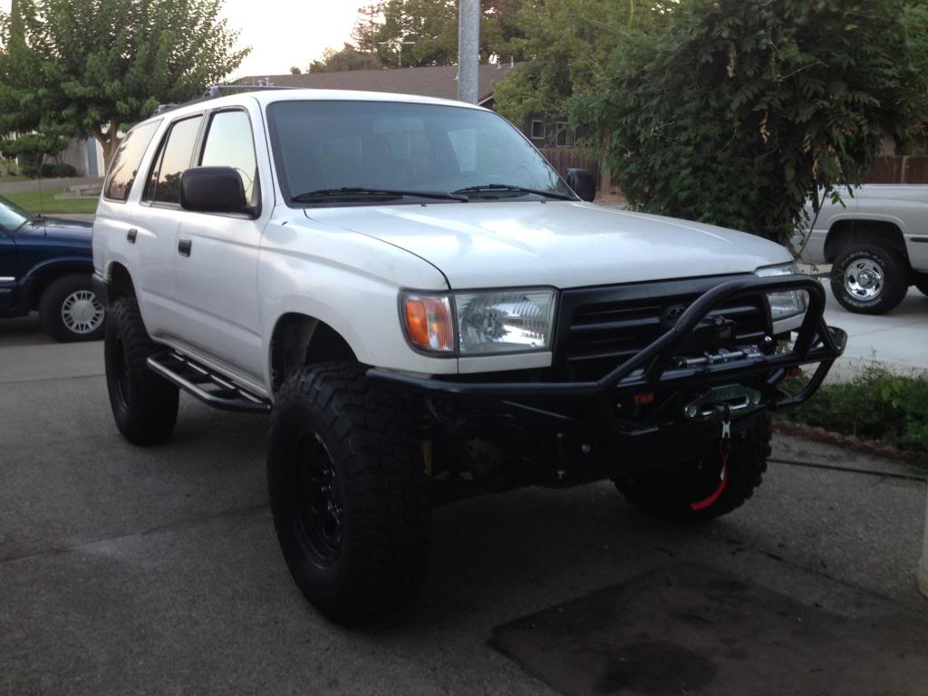

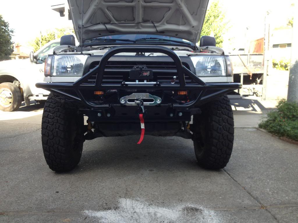

Howdy guys, I took a bit of a hiatus form working on my truck. I have been extremely busy but I finally got some time to really start working on it. So far this is what I have done.
Addicted offroad bumper with blinkers and light tabs, waiting on my rear bumper... also from addicted offroad.
Smittybuilt XRC8 with synthetic line.
fresh set of KM2's.
Still the same trail gear sliders in the old pic.
OME 882 coils up front with OME shocks (cant remember the model number but the equivalent of the old soft rides basically)
LC 7.5 wraps in the rear with procomp shocks for a 02 4runner (they didn't have the billies in stock when I went to order :/ but these are riding surprisingly good)
Front diff drop.
99+ clear lenses with PIIA lights!!!

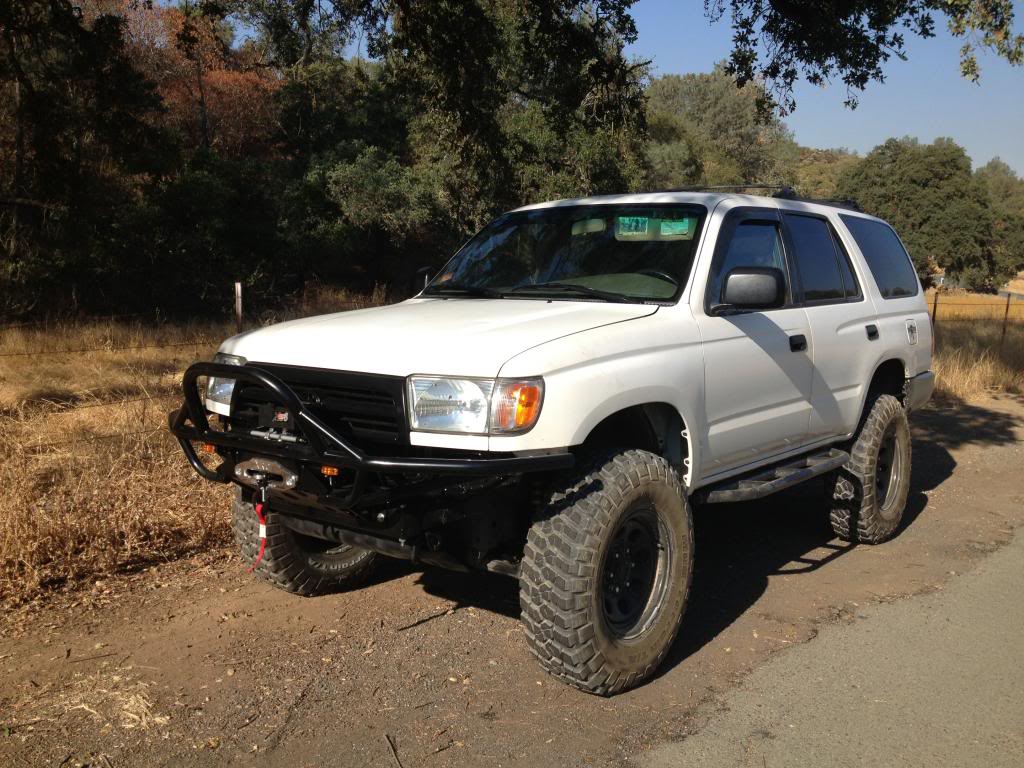

This thing flexes like a mofo now. The only issue I have ran into, is the CV boots tore with the lift (they were old and dry). I rebooted the CV's and installed a diff drop, also with the LC coils my drive line was hitting the gas tank skit so I grinded out a notch where it was rubbing. I later discovered at full stuff the yoke is hitting the rear of the gas tank skid, which I will address soon. While I was doing all this I serviced the tranny, changed the oil, along with the spark plugs, and added some diff/gear oil. I'm at 214k on this baby and I'm just as in love with her as I was the day I brought her home when I was 16!!! I plan on adding a cargo box and POSSIBLY a roof rack.
A pic I took while I was out deer hunting the other day, finally getting it out and dirty.

Does that front bumper kinda get in the way, when you are working under the hood ?
Old Sep 4, 2013 | 03:02 PM
chriso's Avatar
Joined: May 2008
Posts: 353
From: Stockton California
Doesn't get in the way all that much. Rear bumper arrived, couple coats of primer/paint and it will be going on.
