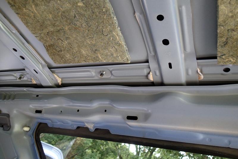

I decided to pull the headliner to check for rust inside those 4 roof holes. I had no idea the A-pillar grab handles were going to be so difficult. I was careless and stripped one of the phillips heads. I used an Irwin easy-out kit to drill enough for a remover bit. The screw didn't turn, but the screw head busted off flush with the pillar. The A-pillar trim is easy to remove with no handle in the way. Next I used a 1/8" drill to carefully drill all the way thru the broken stud but I could tell the easy-out was going to break first. Finally I applied heat from a Weller solder gun for about 15 minutes and the easy-out was just able to remove the stud. The moral is even moderate heat works well against loctite.
Big surprise. When I started grinding away those rust spots I decided to pull the spoiler supports. Underneath these was even more rust. Rusted through in spots. Probably a good idea to pull the top rails and spoiler every few years.

Update:
After grinding away the rust, I plugged the four roof openings with two-piece sheet metal plates/plugs that I epoxied in with JBWeld. I used a similar gauge metal to better match the roof contour. Since there had been some rust inside these holes I removed what I could then coated the patch area on the inside with an aluminum paint called Rust Bullet.
