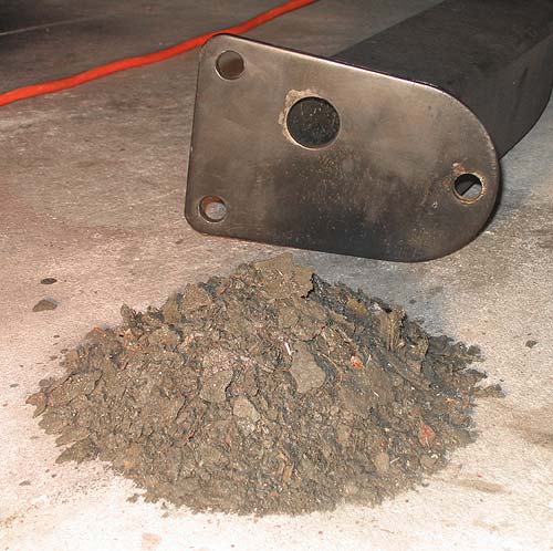

So I looked inside the hitch, and found the inside damp and about a pound of loose rust floating inside. It appears water seeps in through the 2 holes on each side and never has the chance to evaporate. Looking inside with a flashlight I personally would not tow up to maximum recommended anymore
It's drying out with a heat gun right now, and both holes will definitely be plugged up with some silicone and plastic plugs.
Picture speaks for itself.

That pile is huge!

That is a monster pile! Won't sealing the ends only make it worse though? The actual slot where the hitch goes is open and unable to seal, at least it is if you have a hitch in it or plastic cover with no gasket on it, so if water got in there it would have even less chance to evaporate which would make that even worse.

The cross-bar, to which the receiver is welded, is a solid piece of square tubing. It is vented only on the sides, through 2 holes, one of which is in the picture. I'd imagine that drying it out real good, then sealing it would be better than having almost standing water in there.
Funny thing is, I was even approached by a stranger once who asked where I got the hitch, because it doesn't have a spec of rust on the outside and most aftermarket rust through in no time.

I doubt the hitch qualifies for the rust warranty. I'm more concerned about the situation when it can happen, such as hauling something very very heavy. It can easily end up in a wreck and loss of more than just some personal property.
It'd be interesting what you guys find out, as I don't live in a rainy climate, rarely hose it down, and generally keep it inside a dry garage.

wow i'm glad i got the aftermarket reese hitch. I think its rated heavier but also the ends of that main shaft have 1/4" plate steel welded over the ends. With no way for any moisture to get in.
So as long as you get it really dry (like dry it out then let it sit in the A/C inside the house for a few days) then seal it up you shouldnt have a problem.

Sounds like mine is similar to yours. I had it off last fall to repaint it since it had some surface rust and the two holes in the endplates were still sealed just fine.
