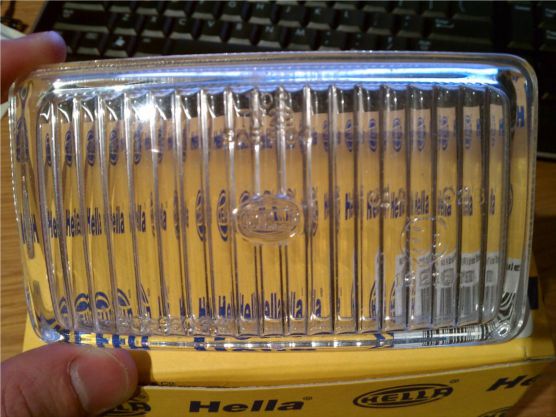

Need just the glass?
If you just need the glass and it's for a 1998 4runner, I can help you out. I have various parts including one complete glass assembly for the 1998 style (rectangular) headlights.
PM me for additional information.
