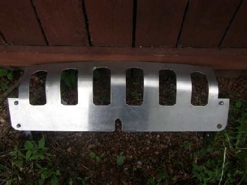

Got this skid plate from a fellow yotatecher but he needed his bolts for his other skid plate. It came off a 2002 4runner and is going on a 2000 4runner. My question is what size are the bolts that mount the skid plate to the frame rail. I have went to the Toyota dealership and they tell me they dont even make a skid plate for a 2000 4runner. I also had them look up some newer model Tacoma's as I have read some people get those and modify them to fit the 4runner as it is cheaper than going the dealership way. Got the same response. Then he showed me the "supposed bolts his mechanics mount skid plates with" and they were way too small for the frame rail holes the plate lines up to. I read in another post the size is 10mmx1.5 but that is way too small! I went to home depot to try and find a match. The closest I could find was a 12mmx1.75. It actually fits the thread pattern but 1 major problem....the bolt is a course thread and the frame rail hole is a fine thread. They do not have these bolts in fine thread.......ughhhhhhhhh!!!!!! I'd rather not re-thread the frame rail if I don't have to!! Anybody know where I can get 4 of these dog-gone bolts so I can mount this skid plate??? Thanks in advance for any responses.

It is the same bolt that holds the hook that is on passenger side of the frame. And, if you have that hook, you don't need any additional bolts. Hope this helps.

My luck... no tow hook, no bolts. Back to square 1. The moron that owned the truck before me must have taken it off.

Do you have the skidplate brackets? The Tacoma brackets and the ones made for the official Sport skidplate on the '02 Runners are different;the 4Runner brackets place the plate to far forward and low for my tastes so I used a Tacoma plate and modded simple retangle brackets to move it forward about 3" to hug the bumper snugly.

Yes, I have the skidplate brackets. They are actually hidden in my picture. Never attached a picture on this site before and had a heck of a time figuring out how to shrink the picture from 248KB to 48KB to let me attach it. But you are correct, our brackets are a little different, however they mount in the same spot on the frame rail. I like how the skid plate fits on your's. Looks like it was meant to be there. I can't really tell how mine will look until I get the elusive bolts to even see where it lines up. Might even try going the way you did as the plate looks sharp on yours......if I can find the bolts..lol. What really burns me is the local Toyota parts dude looked up 2000-2002 4runner and didn't even show a skid plate option for those years. When he looked up the Taco's, it showed a completely different skidplate with about 4 bolts the size of my ink pen to attach to the frame. Make the doggone bolts the same size, Toyota!!! And if you don't, at least carry them in your shops!!!!! Thanks for the reply.

Officially only the '02 4Runner Sports had the skidplate option but that plate and brackets will fit any '99-'02 Runner. Before '02 you only had the Tacoma plate option which fits the pre '99 Runners perfectly but with the "fatlip" bumper I needed to make the extending brackets which was just two rectangle pieces of metal with corresponding bolt holes plus I need 4 more bolts/nuts.

Gotcha. Makes sense now. I just got back from Toyota dealership (think the parts guy is ready to ring my neck!) but finally I think I have hit paydirt. With Mountainryders advice, I asked him to pull up the tow hook on my 4runner and "voila".....the illustrious bolts were staring us right in the face!! I have ordered 4 of them....at $3.25 a piece.....Grrrrrrrrrr. But I have spent $20 in gas riding around looking and buying the wrong one's and returning them so what's another $13 gonna hurt. Anyways, I think my quest is finished as they should be in Tuesday morning. I can't thank all of you enough for the advice...really appreciate it. Love this site!!!!

The Tacoma skid plate instructions list the bolts as M12x20 Flange Head Bolts

Thanks man, that sounds like what I ordered (of course toyota has a long drawn out part number so it's hard to tell).
