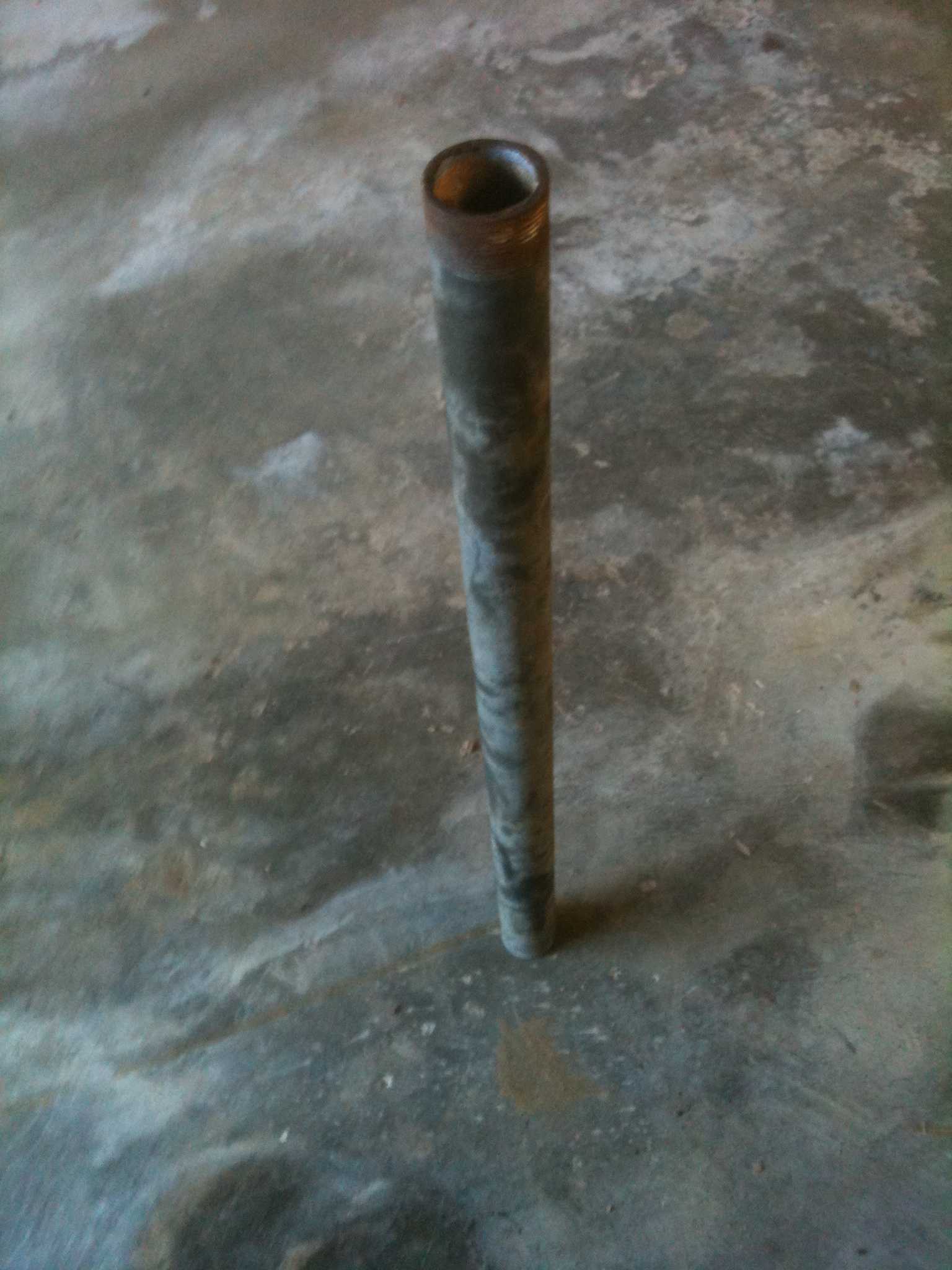

My bearing driver is, I believe, a piece of 1.5" galvanized steel water pipe 26" long. It fits perfect. Mine was used so I had to take a grinder to the inside to a depth of about 4" to remove some scale. I used this to drive on the bearing, abs rotor & both retainers. It works as well as a press if you are careful. You want the driving end to be as true as you can make it. If you buy a length at Home Depot, they can square the end for you. For my used pipe, I used a hacksaw and a file to true it up.

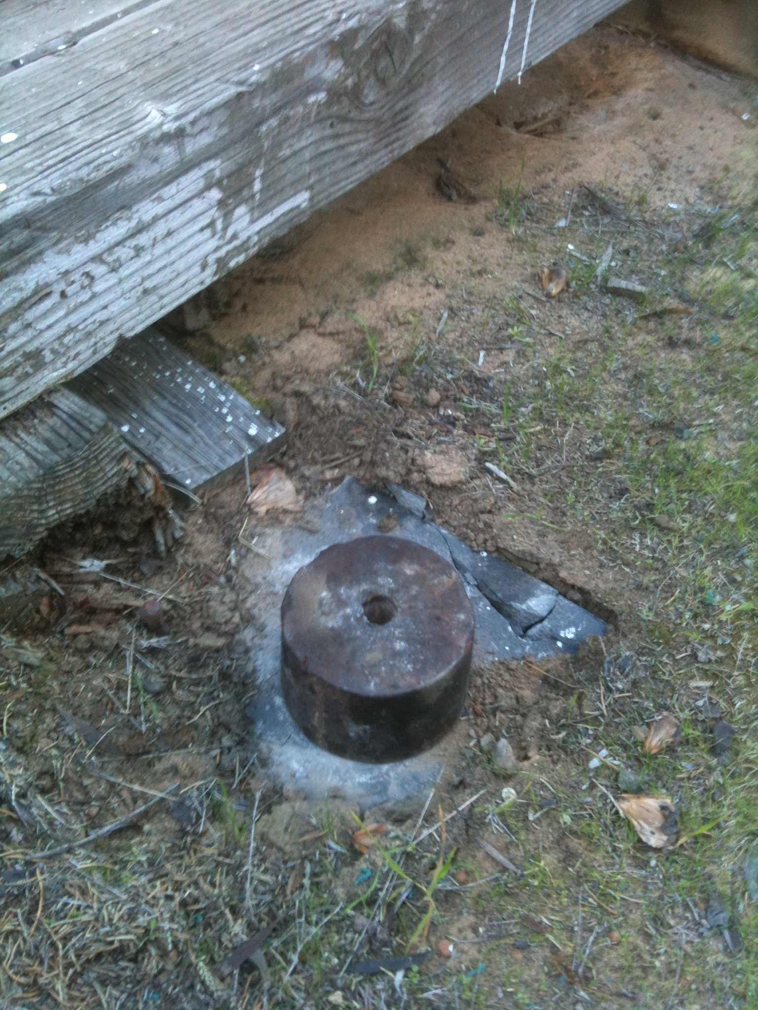

My anvil is a round slug of steel I had laying around. I am not sure where you would find such a thing but it is a good diameter for setting the axle on end when you drive on the new parts.

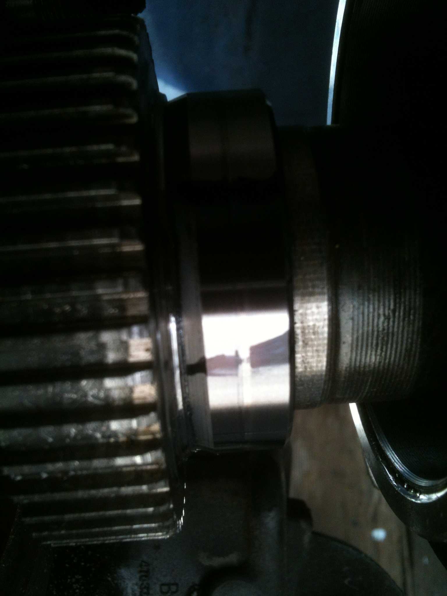

Once I pulled the axle assy out, I set it upright on its lugs and used a steel rule marked in 0.1" increments to measure the distance from the edge of the bearing outer race to the furthest face of ABS rotor. The rotor has three or four small but distinct steps on its face. I am talking about nearest the teeth. The magic number here is 1.4" exactly. I tried to match that during re-assembly.

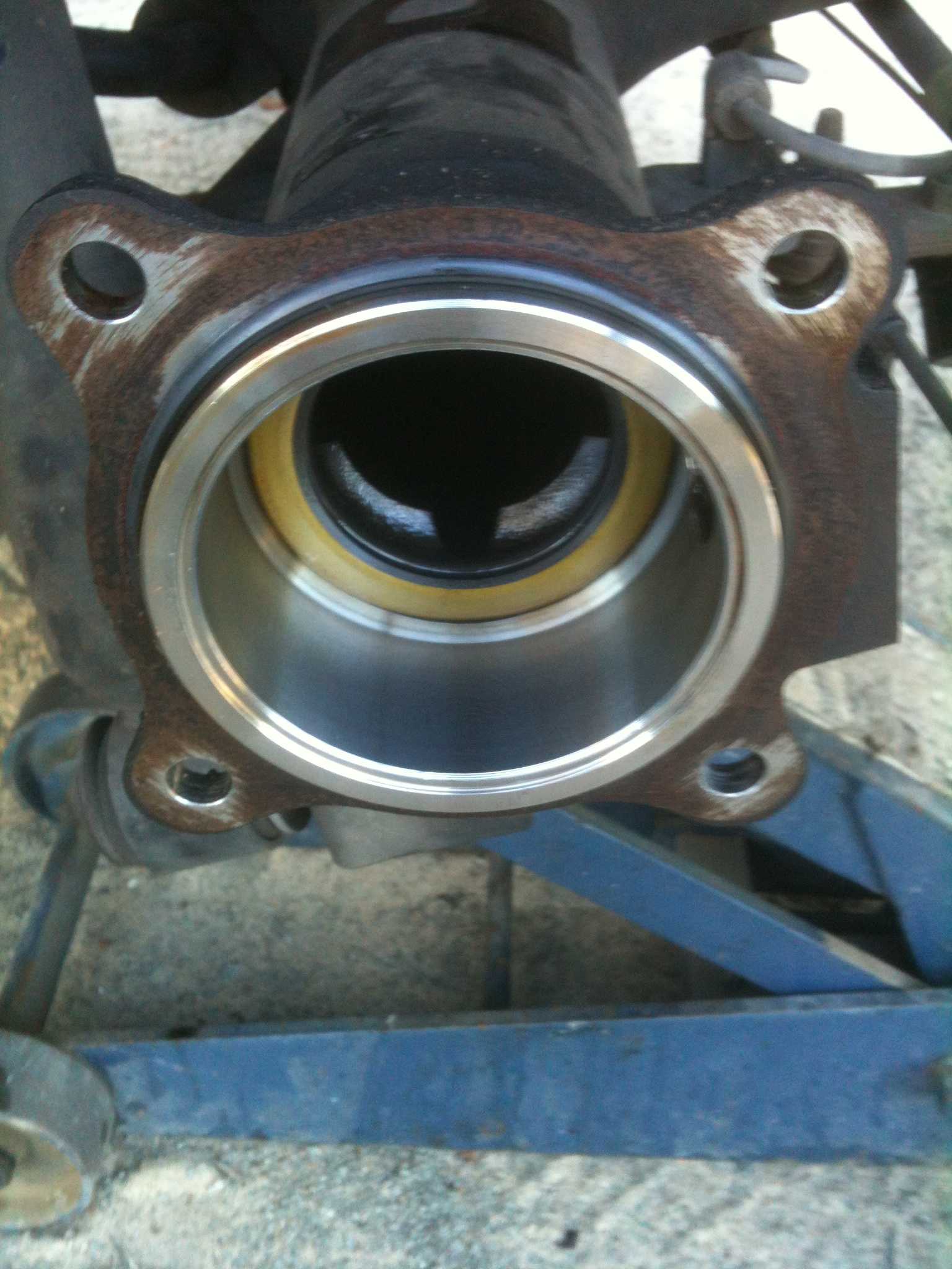

I looked into the axle tube to inspect the seal, and used the steel rule to measure the depth of the seal face from the end of the tube. The number here was very close to 1.5". Essentially this means that near the OD of the ABS rotor, there will be about 0.1" clearance from the seal face. This is not real important, it just shows there is some margin for error in getting the final positions.
The things that control where the seal lip rides on the inner retainer, are the type of seal you buy, how far you drive it in, and the position of the inner retainer on the axle.
As the bearing wears it may develop axial play up to 0.050" or more, so you really want the seal lip to ride as close to the center of the retainer sealing surface when you put it all together. You cannot control exact placement of these parts without better tools, but as long as you go slow and measure as you go it will be close enough.

Getting the axles apart and driving in the new seals are the most difficult tasks. To separate the axles I used the method, "slam the axel end against either concrete or a steel plate". This will destroy all but the toughest concrete, so spare your garage floor. Make sure to move the retainer clip out of the groove BEFORE you try this!
I used my large round anvil as a target, and it took 15-20 good smacks to separate the first axle. If you are lucky, the brake assy/bearing housing may slide over the bearing as you do this, and act as a slide hammer.

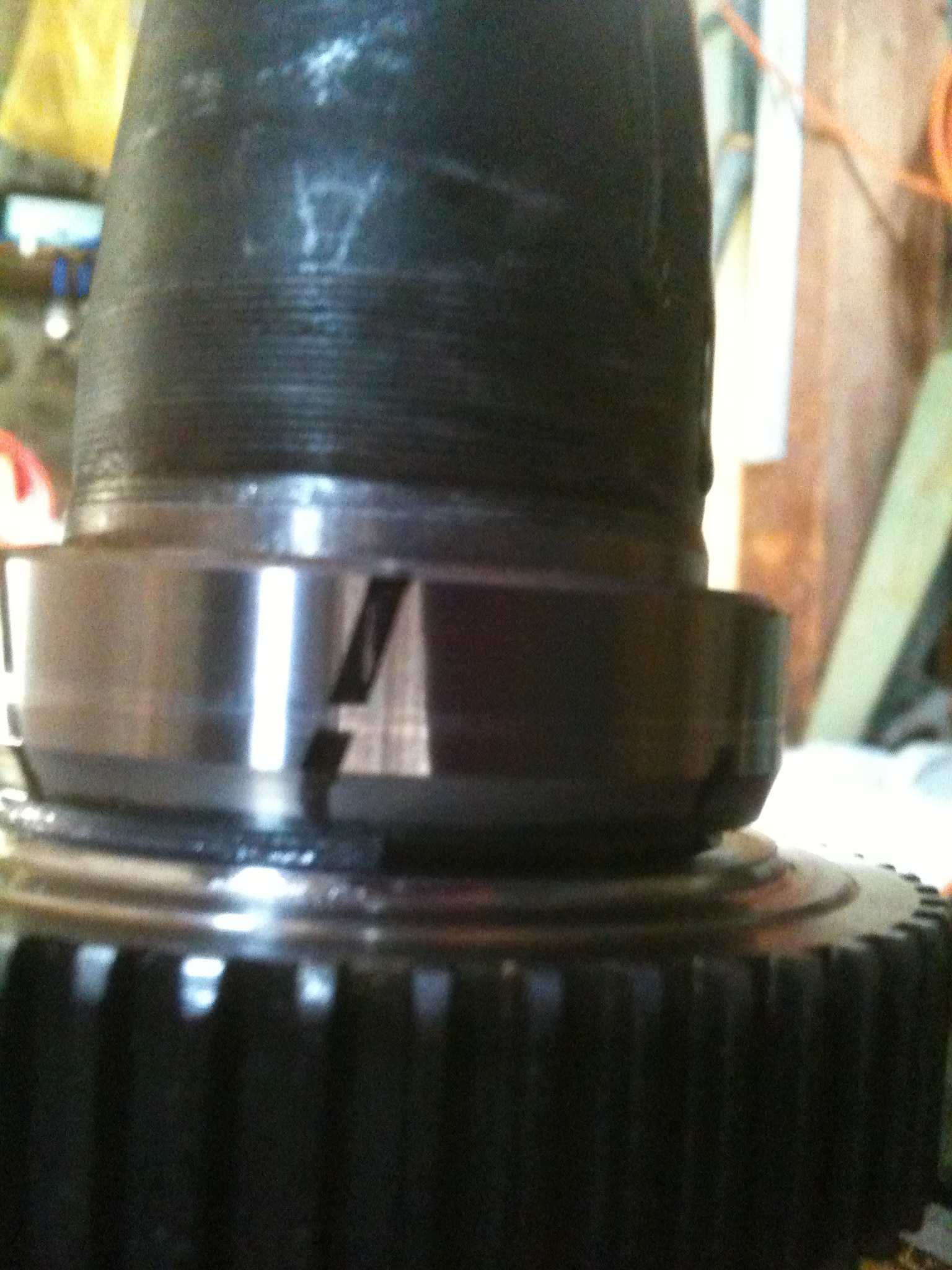

Once apart, I wiped down and oiled the surfaces of axle & bearing and using my bearing driver to hammer the bearing home. As the bearing approaches the bearing housing, I inverted the axle, bearing driver and anvil, balancing it all on another hard surface, and pounded directly on the anvil face. This lets the brake assy/bearing housing slide partly down over the bearing and prevents it from getting crooked.
Once the bearing was in place, I squeezed the retainer clip a bit to shrink it down and placed it in the groove. I then hammered on the ABS rotor very slowly to achieve the same 1.4" dimension as the original.
At this point I took a series of measurements with micrometers to convince myself that I should mount the inner retainer backwards (bevel end facing ABS rotor) to optimize the seal/retainer placement. I pounded on the inner retainer very slowly, intentionally leaving a gap (~0.05") from the ABS rotor.

I took a black marker and made several lines across the retainer sealing surface, and test fit the axle. Pushing it all the way in and spinning it around left a distinct wipe mark on the black markings (much better than using grease). It was easy to tell from the wipe mark that I should drive the retainer all the way until it touched the ABS rotor (carefully!).
Repeating the measurement shows it was almost perfectly centered, so I finished that side.

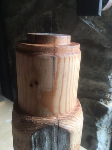

I made an improved seal driver on my wood lathe from a piece of 4x4. The top step is 0.350" tall and 1.900" dia, and holds the seal in place. The next step should be 0.300" tall and 2.750" dia, and is the driving surface. The remainder is 2.950" dia and then sanded to fit closely to the axle bore to keep the seal centered. This part needs to be at least 3" long. I used some wood sealer so the tool wouldn't absorb gear oil and swell up. This tool is much better than my prior one. No worries about the seal getting cocked in the bore. A few whacks with a rubber mallet and move on.
