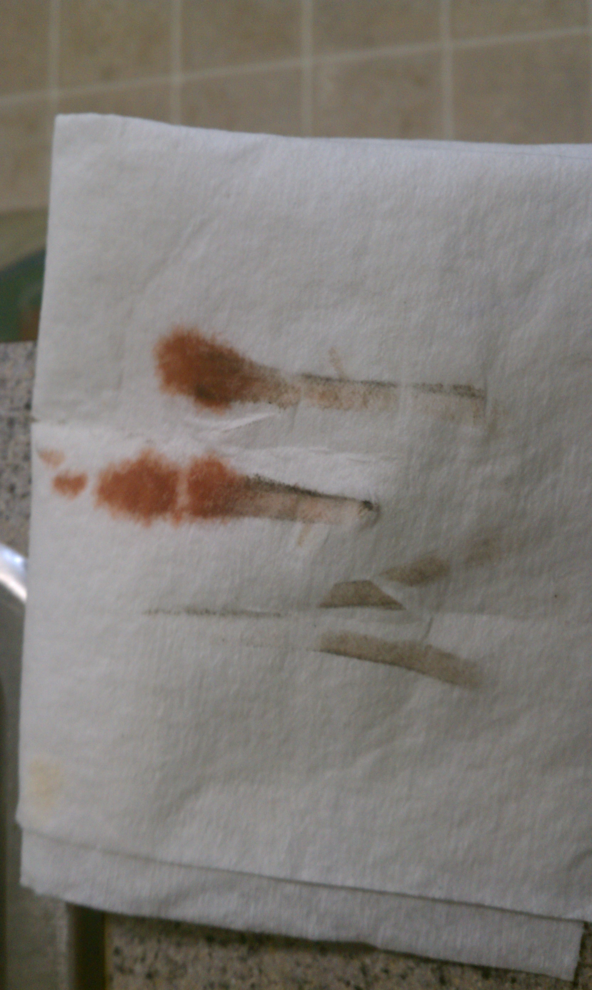

Hey Everyone!
Just wanted to give a quick update. I performed a full tranny fluid swap yesterday w/o dropping the pan. I was pressured for time & a good place to work on the truck etc...
Drained the 4.6-5Q's out of the pan(the manual says you will only drain 2.1 Q's, well...it's wrong). Filled back with the EXACT amount, removed the return line from the radiator, placed drain tube into a bucket that I pre-marked in Q intervals. Had my dad start the truck, drained a Q, shut the truck down, added a Q...Start, drain a Q, shut down, refilled a Q and repeated, you guys know the drill.
The fluid that was coming out was pretty darn dirty, until the 12th Q, then it started flowing pretty ruby-red-clear. I went ahead and did the full 16 Q's since I was already down there. I plan to install the external cooler very soon, like within a month. I also plan to drop the pan and check the magnets, filter etc around 200k. This was just a quick simple peace of mind thing I wanted to get out of the way!
I had trouble finding any other non-synthetic fluid other than Valvoline (pictured below), so I went with that. So far it's shifting a little smoother, haven't really driven it enough to tell the difference yet, if any. I also attached 2 more pics. One dipstick swipe of the old fluid, one dipstick swipe of the new fluid.
