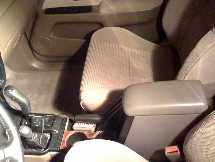

well thank you for everyones help and info. I was able to find a console and e-brake out of a 02 at a salvage yard for 25 bucks so I got it and put it in today. the bucket for the e-brake wouldnt line up right and i didnt want to have to trim the floor so i reused the original bucket. the little tab for the e-brake cord was scrapping and when i went to trim it it broke off so i dont have to worry about it scrapping anymore. but all in all everything lined up great and i didnt have to trim anything. the only problem is that the console is grey and my interior is oak. but im ok with it until i find an oak console. or i may go back out to the salvage yard that i got it from and see about getting the seats out of that 02 that they have out there. Its got leather.
